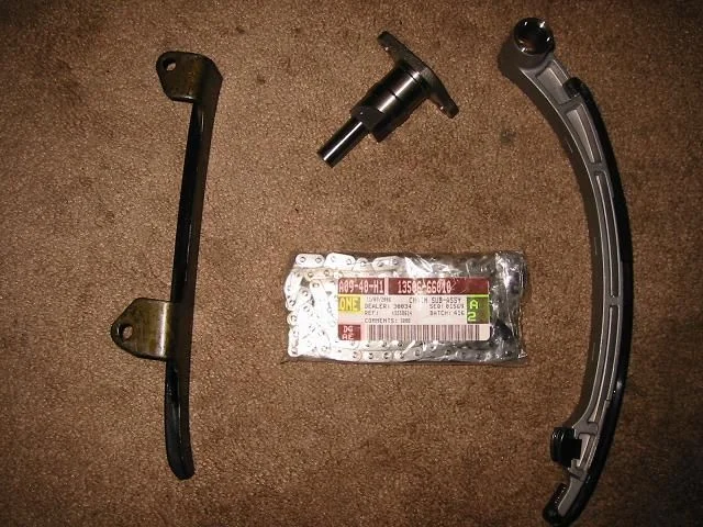

Timing gears..hmmm can you please ask him which one..
