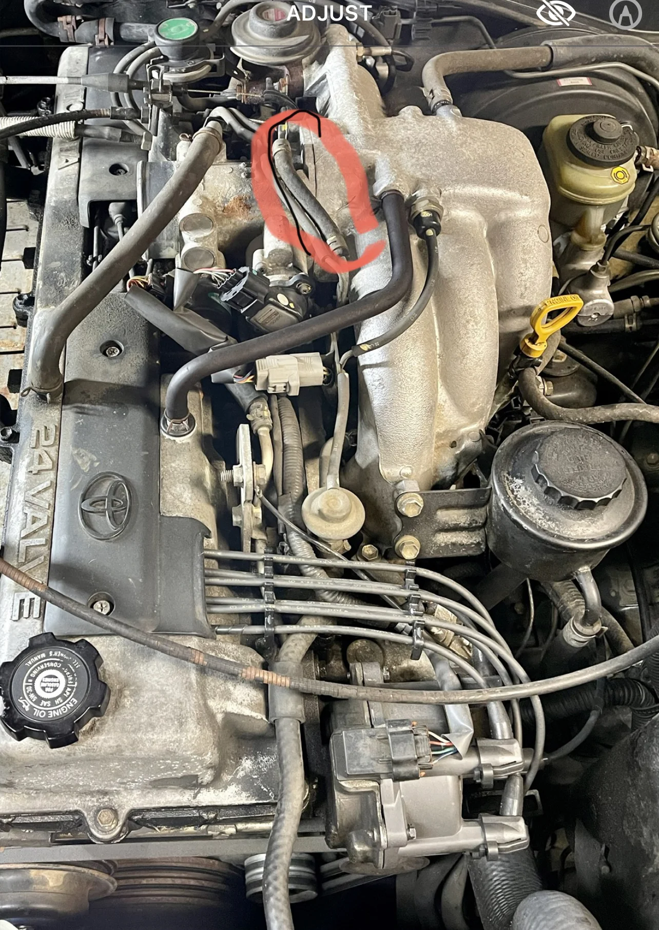

Can someone please help me identify this hose circled in red coming off the throttle body? It seems I overlooked ordering the replacement as the one I have is rock hard.
I could not find a specific part for that hose so ended up just using matching size hose from the parts store. Stores here only carry SAE size, no metric, so I went with the closest size they had which is just a tiny bit smaller. The original hose had braided reinforcement so I went with fuel hose rather than the cheap bulk vacuum line.
