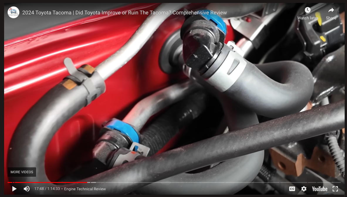

This engine's plastic cooling system parts, including plastic hose clamps and "quick connects" are discussed more in the video below in the context of Tacoma.
Starting around 17:20. "A disaster waiting to happen."
I expect we'll eventually see an aftermarket kit substituting plastic hose clamps with Toyota's well-proven metal ones because replacing them all at once will become a PM need.
For Land Cruiser, burdening something as important as the cooling system with such ubiquitous reliance on time-vulnerable plastic is an eyebrow raiser.
Maybe I'm missing something, but I watched that segment and again didn't see any plastic hose clamps. Plastic tubing / connectors, sure. But all the hose clamps looked like the standard Toyota constant tension metal clamps.
Still lots of metal hose clamps, but also some plastic fittings/clamps (see the blue and black piece) where a traditional hose clamp was used on previous models.
I can envision that these plastic quick connects make the vehicle to engine mating process easier and quicker during assembly.
Think we'll have to wait and see if they turn out to be reliable. Toyota has had some crappy plastic electrical connector tabs for sure, but their fuel system plastic quick disconnects I have not seen issues with.
Hard to say for sure but it looks like the plastic elbow fitting is all 1 piece including it's quick disconnect blue tab to join to the metal piping. It also looks incredibly simple to replace.
All of the hoses however look to be connected with proper OEM constant tension metal clamps.
