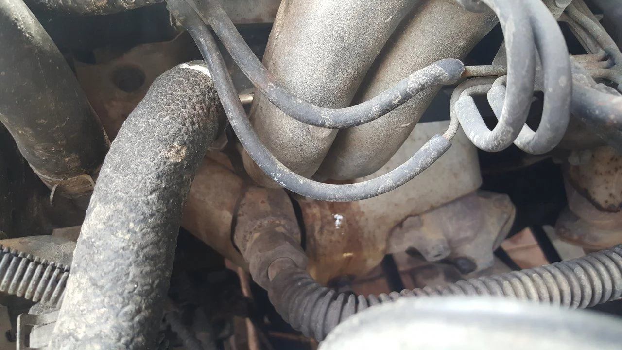

A frantic call last night to describe steam billowing from the engine. I assume blown hose of some sort and tell him I'll get to it after work today. I fill the radiator and let it run, looking for leaks. After a couple minutes fluid comes rushing from the intake/exhaust manifold area.
My question for the group... Freeze plugs or something more major and how difficult is it to get in there and inspect?
Thanks,
Matt
if leaking from manifold, throttle hose (bypass #2)
Or the other little one (bypass #1 or #3 I forget which)
Read how to open it up through search.
If it's not one of the small lines that run to the throttle body and ISC valve, I would suspect the little freeze plug on the head, just behind those intake runners.
