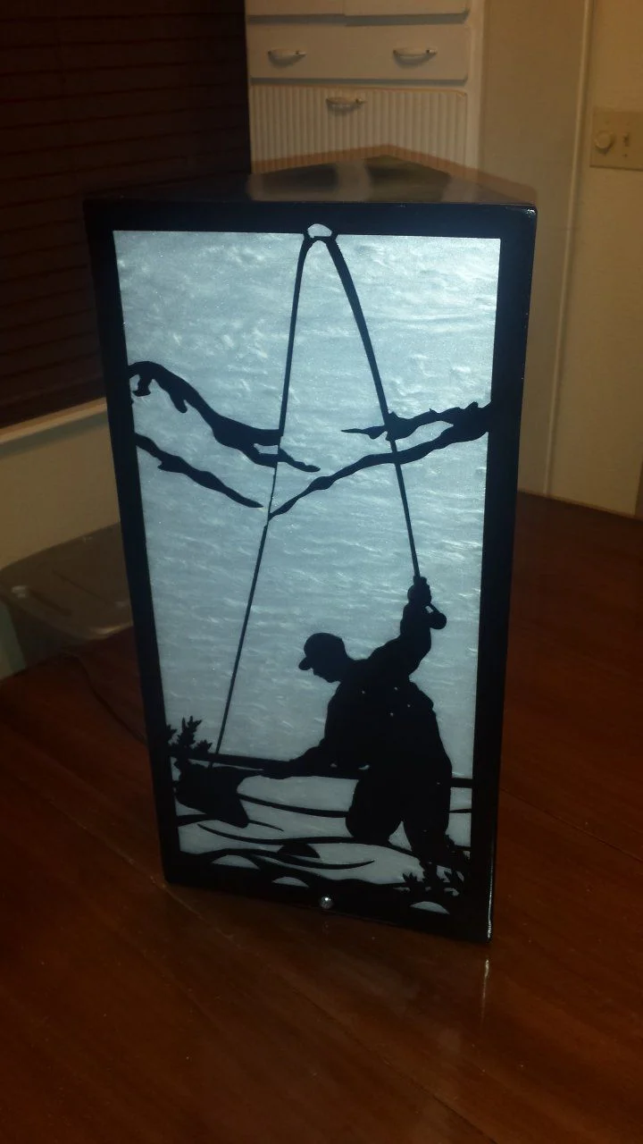

I made this yesterday for a birthday present for my dad. Super happy with how it came out.
Nice!!!
