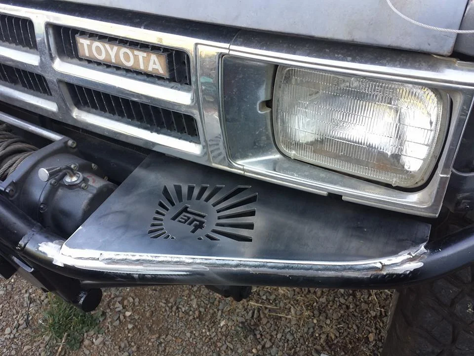

My latest project. Made some rad top plates for my buddies ugly tube bumper. They came out rad. Finally got to start welding again after almost 3 months of being laid up from shoulder surgery.

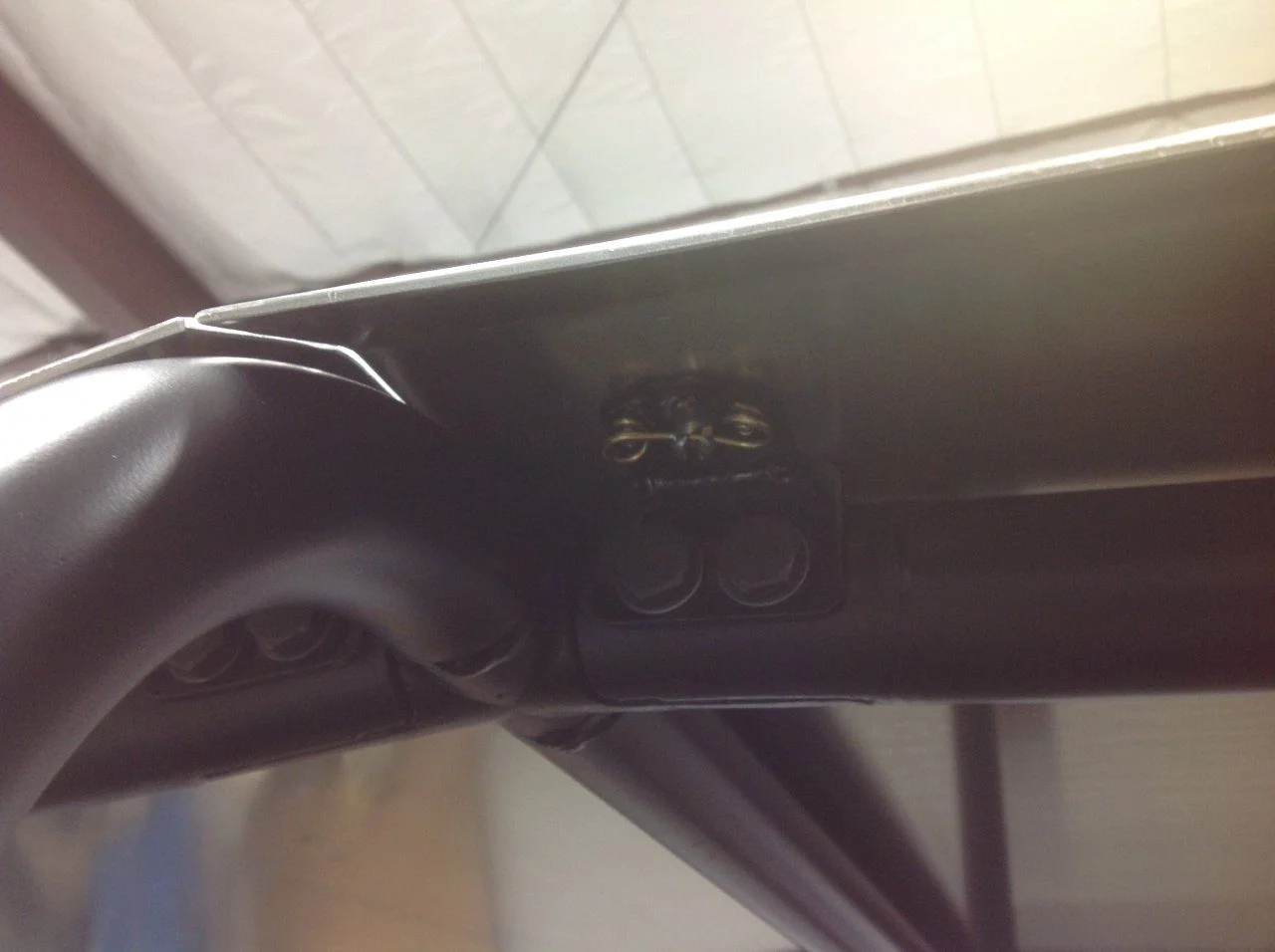

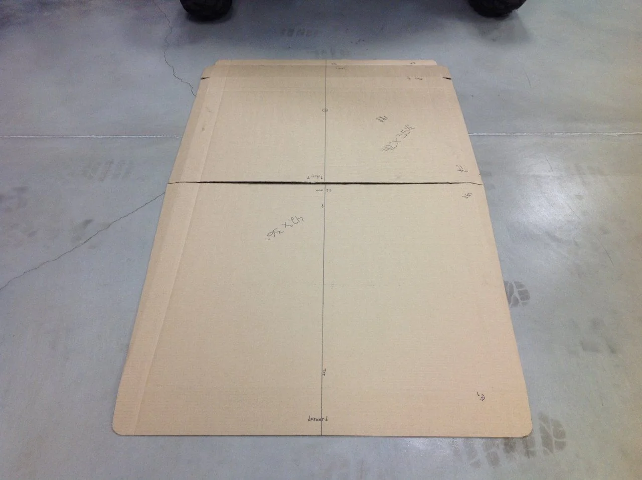

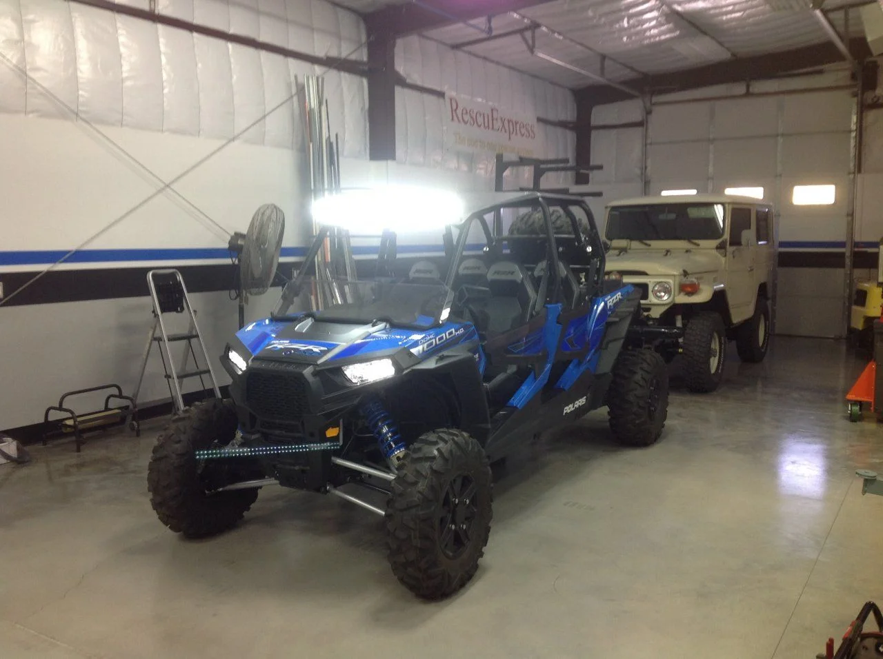

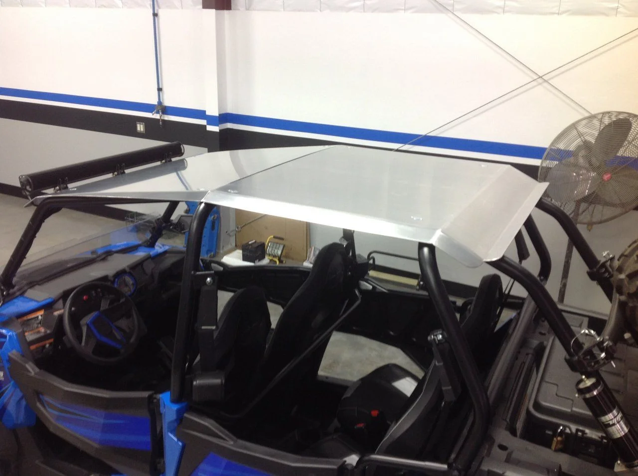

Sorry to interrupt the welding class, but it's time for a brake. Although not much welding on this project (just a little TIG steel/alum), I thought I would share. 2015 four seater Razor (not mine) required a roof. The customer had no idea what look he wanted and gave me design freedom.
Started out with cardboard templates (standard) and transferred to 1/8" aluminum (5053). This alloy allows breaking without cracking and welds up nicely. I also added a 36" LED light bar requiring light wiring. Its switched to the hi-beams so no extra switch required. The brackets are milled slotted for fine adjustment and tig welded to the Dzus bracket. The rear roof panel required two small welds as well.
Have any better pictures of the steel to aluminum TIG welds, and maybe which filler rod you used for that?
Sorry, I'm a fabricator not a writer. The Dzus brackets are mild steel and the roof panels are aluminum. Thank you for busting my chops haha!
