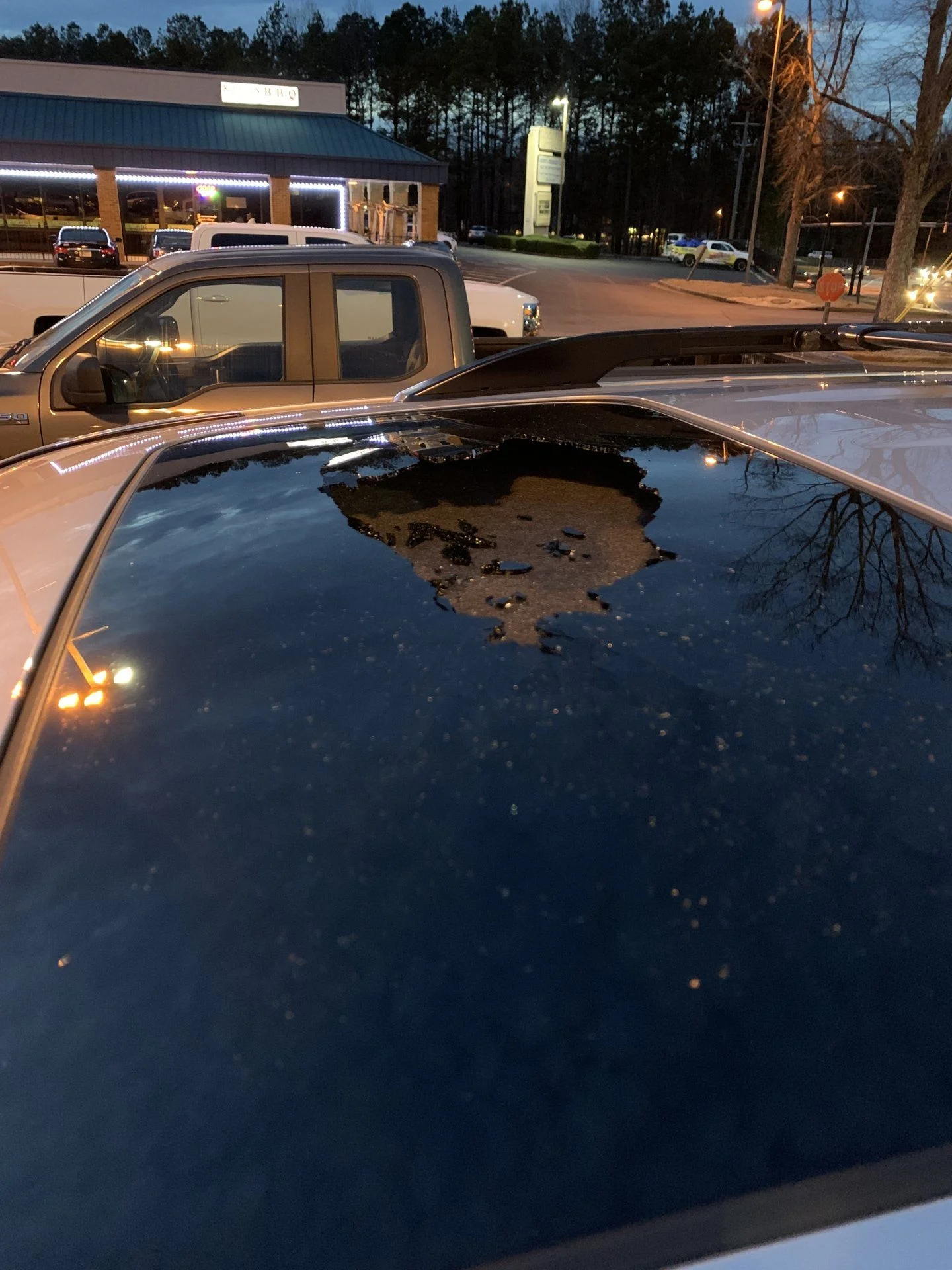

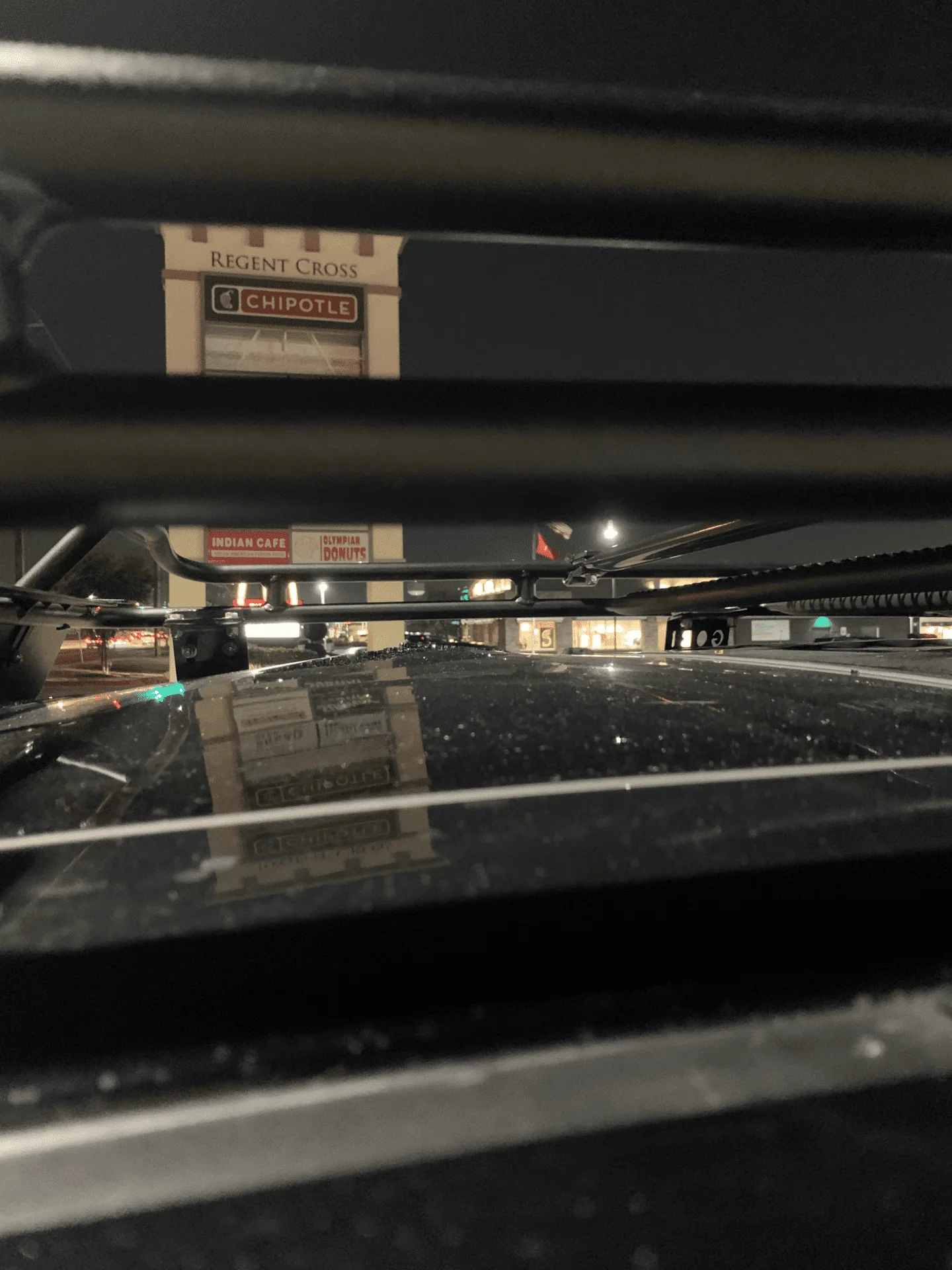

Driving on the highway tonight and the sunroof on my '16 Land Cruiser went boom above me. Wasn't sure what happened until I peeked through the cover and saw the spiderweb of cracks. Pulled over and saw it bowed up and outwards (internal force/flexing) and no foreign fragments indicating impact.
Here's some similar threads:
A Consumer Reports article about this almost common/random occurrence:
Seems like it happens across all brands, but the two other instances reported on MUD^ indicate this could be a problem area to watch out for on the 200 series. From examining the glass it seems surprisingly thin for being a top facing pane of glass which is also on a less rigid, moving frame. One of the things when buying a Land Cruiser 200 that I've heard is how it has "2mm thicker glass" than normal Toyota vehicles.
For reference: Dallas, TX, going around 65 mph, around 50° F, moderately windy conditions, no precipitation. No history of being weakened by hail or anything like that.
Taped the glass sections together and then covered it with a trash bag for now. Not sure if I'm going to repair it through the dealer, insurance, or third party with aftermarket or OEM glass. Any similar feedback or advice?

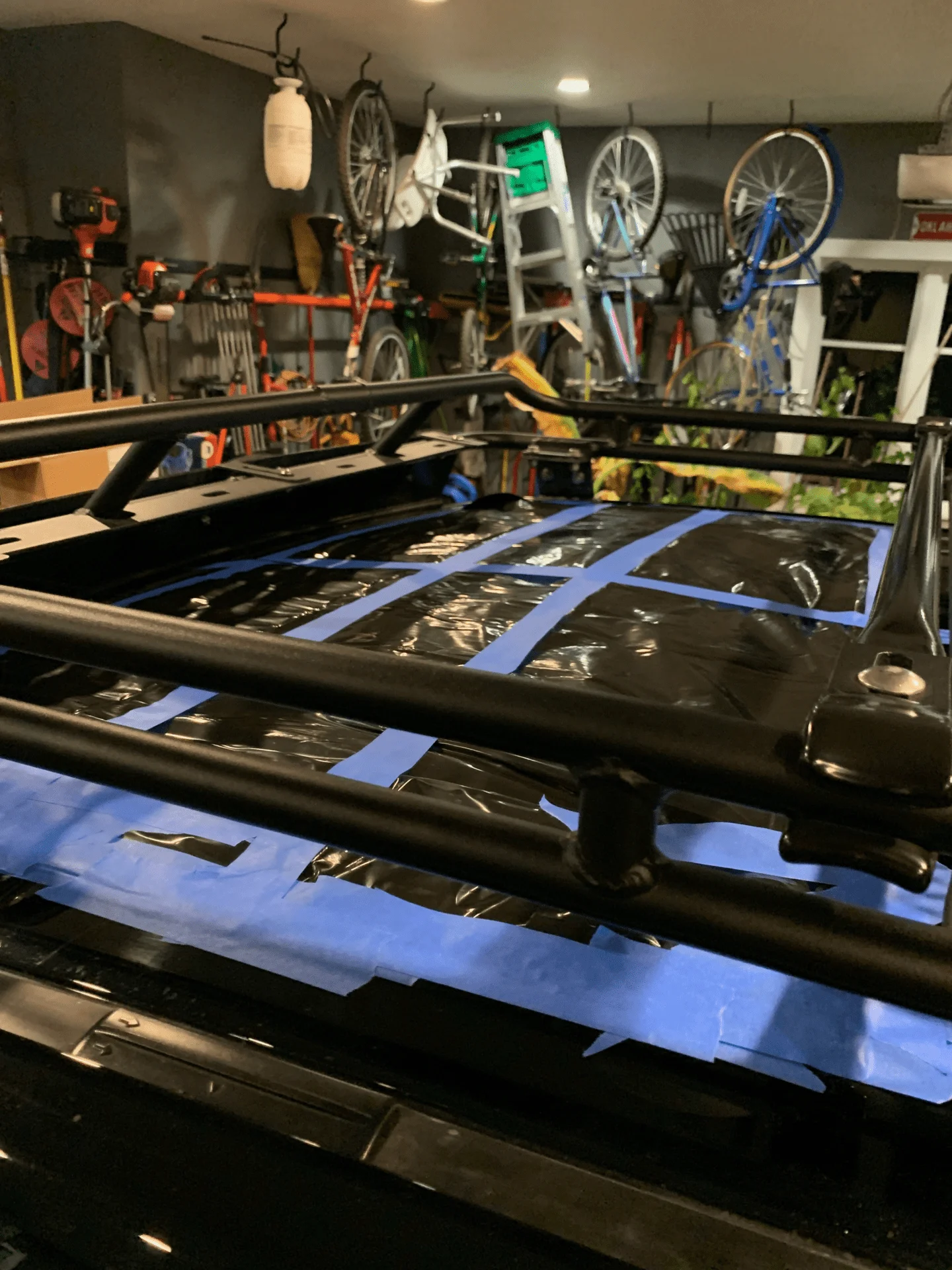

So overall I was unable to use the truck for 48 hours and was out $100. But what if this had happened on a trip? In a blinding rainstorm?!!! A stopgap measure has to be in place for such an event. I'm thinking the OE rubber cargo mat would cover the opening and be held in place by 100mph duct tape. Probably a better material that is thinner could be kept stored under said floor mat ready to pull out and apply in the cover of a gas station pump shelter. What material? Thin flexible vinyl sheeting? It needs to be stiff enough to hold it's shape in the wind and with rain/snow hitting it but flexible enough to conform to the roof shape. Ideas? I'm going to get something as I don't want to be caught out in the cold if it happens again. The rubber cargo mat would work for a slow speed drive to the nearest covered location, perhaps held on with paracord, just over the roof and inside straight across, close the doors on it.

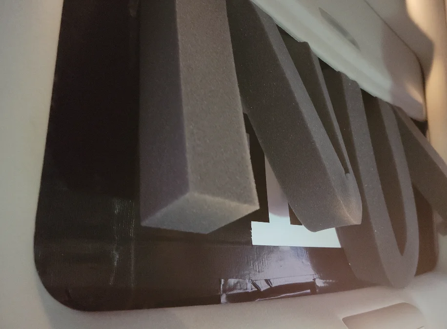

I'm drawing a blank on whose rig it was but there was a massive rainstorm in Ouray last year during the LCDC and someone had a falling rock on the Million Dollar Highway shatter their sunroof. They bought a For Sale By Owner sign and then cut it and taped the heck out of it as a stop gap.
I took a few rocks in that storm (one into my windshield which left a mark to this day, but no crack) but thankfully nothing broke.
@montegofd3s
Yep, that was me. Some garage sale signs, gorilla tape, and some window sealing foam to support the signs from the bottom (when I closed the shade). Worked like a charm for another 4000 miles until we got home.
