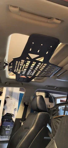

Has anyone installed this interior sunroof MOLLE panel?

This looks like a good idea for some light storage like binos, 2A or snacks.
I think most here do not like these things because of risk of projectiles in an accident. It also eliminate an egress path in an emergency.
I really doubt most think a sunroof is an emergency exit especially with a roof rack.
I just need a place to hang my cowboy hat
This would work. I had this in my FJ60
Treating injuries at and occasionally cutting the passengers out of car wrecks is a major part of my day job. I won't get into the details of what I've personally seen, but there is absolutely no way I'd put that big chunk of metal so close to my and the passenger's head. I'd most likely even refuse to sit in the front seats of a vehicle that had it.
That goes for just about anything aftermarket added to a vehicle. Just think of jeep drivers and all those ducks flying around in a wreck.
I’ll take plastic ducks over anything metal or heavy. @bloc. I see what you see if/when they make it to the hospital. Nothing heavy or metal (that isn’t bolted down) anywhere in the passenger compartment of my vehicles.
That is right. I keep everything strapped down . Amazing how many people don't have anything secured.
Even when things are bolted down, if they are too close to the occupants they can cause significant bodily injury. Most people have no idea how much thought goes into the majority of things and surfaces within reach of the occupants in a modern vehicle. Even the rearview mirror is designed to snap off with a certain amount of force, in case of impact by a stray arm or maybe abdomen.
This product, even if installed solidly and accessories firmly attached to it, poses serious risk of scalp lacerations at the very minimum.
I fear we have taken this thread in a direction the OP wasn’t interested in - but now that we are here:
So Cole and Bloc,
I fully agree about the dangers of things flying around during an accident but since our vehicles are all one large interior space, do you similarly bolt or strap everything in the cargo area down?
I don’t but wonder if I should. But then wonder how secure most straps really are.
If I have a bunch of odd and ends in the car for area, I could throw a cargo net over it - but I wonder about the efficacy of that.
Anything not tested in a crash test is capable of breaking loose in a crash. Everything involves a certain amount of risk and most people mitigate that risk as much as possible.
I did not notice any hate for the people who have stuff suctioned cupped to the windshield or have multiple Ram mounts on the dash. It is all a matter of risk.
A net, unless it load tested and anchored using factory mounts could be useless in a crash.
To be clear, with regard to this product I'm not as concerned with objects hitting the occupants, I'm thinking about occupants hitting hard objects.
I'm reminded of a police officer that got into what would have been a pretty minor wreck in a parking garage.. except his head hit the sharp metal corner of the aftermarket emergency light control console that was roughly where our dome light controls are. The inside of his car and the area around it no s*** looked like a tarantino film. Scalp bleeds can be wild and he wasn't a small person.. I'd be surprised if he didn't lose a pint or two.
Yes, cargo within the vehicle is a concern. But the things bolted into the vehicle itself, if too close to the occupants, can be a serious hazard. From the factory all of this stuff is tested extensively, resulting in carefully managed geometry and surface textures/materials that lower the risk to occupants in different types of accidents. The fact that some budget vehicles have hard plastic (aka cheap) door cards in the rear seat only is not an accident.. that's what the regulations allow in that position. Sticking a metal frame directly above the heads of the people in the front row is asking for trouble, IMO. Not only through contact with the head, but arms, hands, etc.
For stuff not directly in the front row.. the backs of the second row seats will go a long way toward protecting occupants from flying objects in a frontal collision, where sheer energy is typically highest. Without being an engineer one exception to this would be interior-mounted spare tires.. my gut says that's just too much mass with it's center too high up to be sure it won't make it to the second or front row occupants.. even if it means folding seats over on the way. Other accident types add all kinds of unpredictable forces, but those forces are usually much lower, to the point that good tie-down practices can really make a difference. The problem we have then is the stock rear cargo tie-downs only use M6 hardware.. but even those failing would dissipate energy in an accident.
Also, no hate. People can take the risks they deem appropriate.. I just think many people don't really understand the risks. That's why I'm speaking up.
Good explanation. Makes sense.
Thank you for your thoughts.
