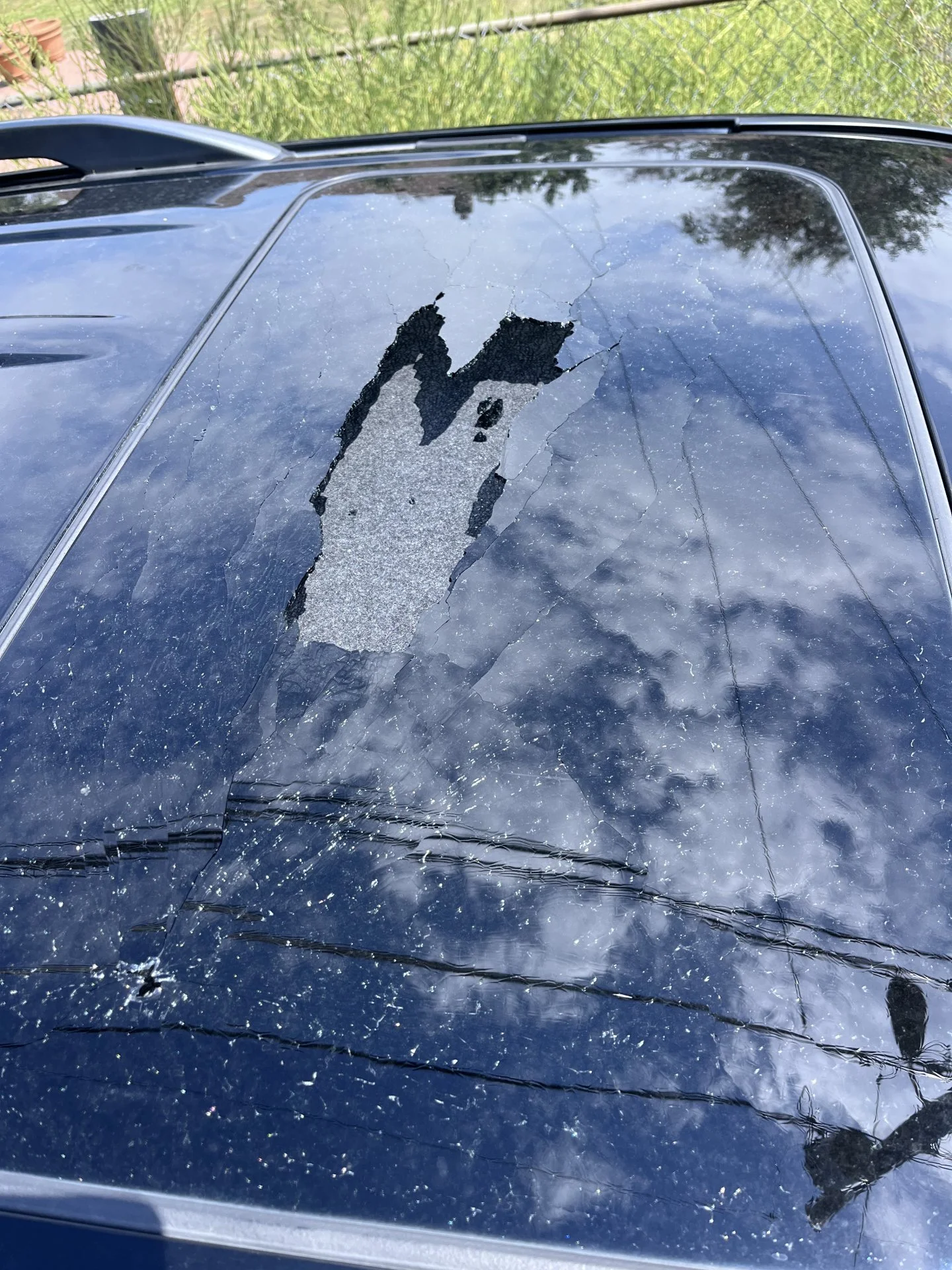

Damn, this just happened to me today in my 2011 LX. I was driving a twisty mountain road (hwy 285 between Conifer and Denver). 60 mph, about 65 degrees outside. Boom! Sunroof glass exploded outward.
Seems like from this thread I will have to go thru insurance on this one and I should get it repaired at the dealer. Any other suggestions?
Looks like something hit it, that appears to be an impact radius in the corner. Possibly a rock from a passing car or one in front of you?

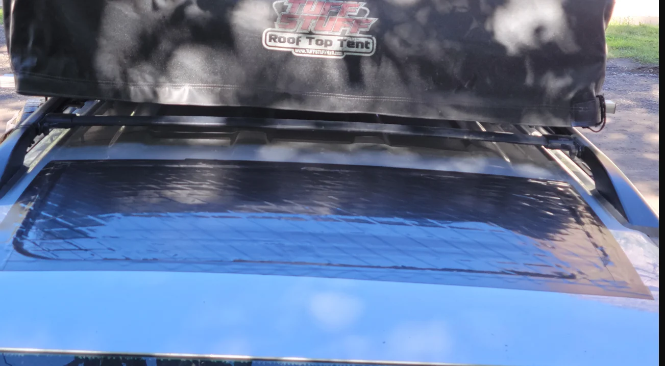

I had one get smoked by falling rocks during a monsoon last year while attending LCDC. No one had that glass so I bought some yard signs, gorilla tape, and window unit insulation to patch it up until I could get home and take care of it. Don't use duct tape as the glue is impossible to remove (tip I received from a glass guy in the area). I taped the glass as best I could to hold it together, sandwiched the taped glass with the signs, then layered it again with tape. The foam was for support to hold it up and just stuffed between the sun shade and the sign. I drove another 5000 miles like this with no leaks, and when I got home filed an insurance claim so toyota could replace it. That is an expensive piece of glass at about 1100 bucks if I remember correctly. They also replace the front windshield since it had some chips that were assumed to be from the same incident, so I am ok with that.

Some sunroofs have done this on other models as it happened on one of my Super Duty's, bad tempered glass, but that certainly looks like an impact to me. Then again, I am no glass expert.
I had this happen with my new LX570 in 2014. After considerable negotiations, Toyota covered it under warranty. In my case the inner layer of glass shattered but the outer layer had zero damage. Glass can shatter due to incorrect annealing.
