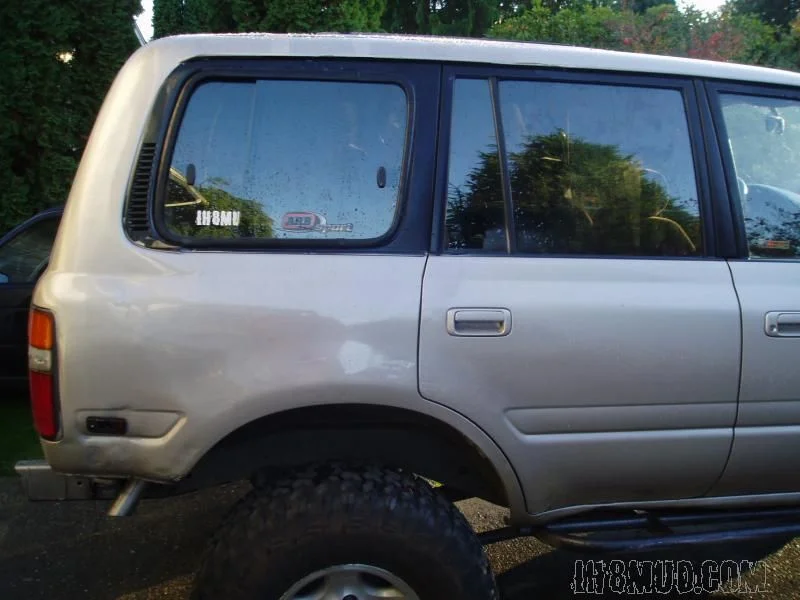

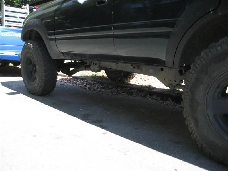

I have no intention in turning it into a buggy! My plan is to bob 7" - 9" off the back and weld it back up. I also want to cut the rockers out and recess the sliders. The only other tube work will be a rear bumper and tube fenders.
This 80 has a 7" bob:

And here are the only shot I can find of chopped rockers on an 80:
attachment.php
