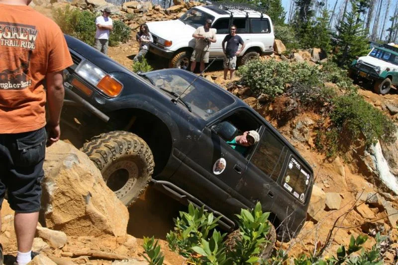

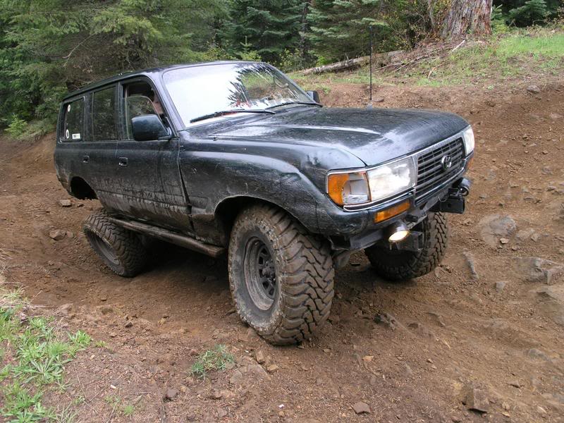

I then stepped up to 315 Toyo MT’s on a narrower steel wheel… With all of the capability this thing has, it wasn’t long til I was putting it in places it didn’t belong. And the body started showing it:

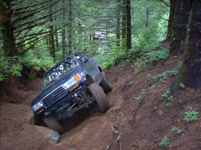

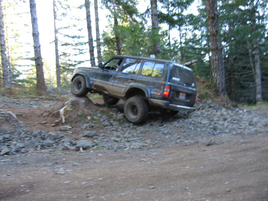

And continued to beat the snot out of my poor 80!

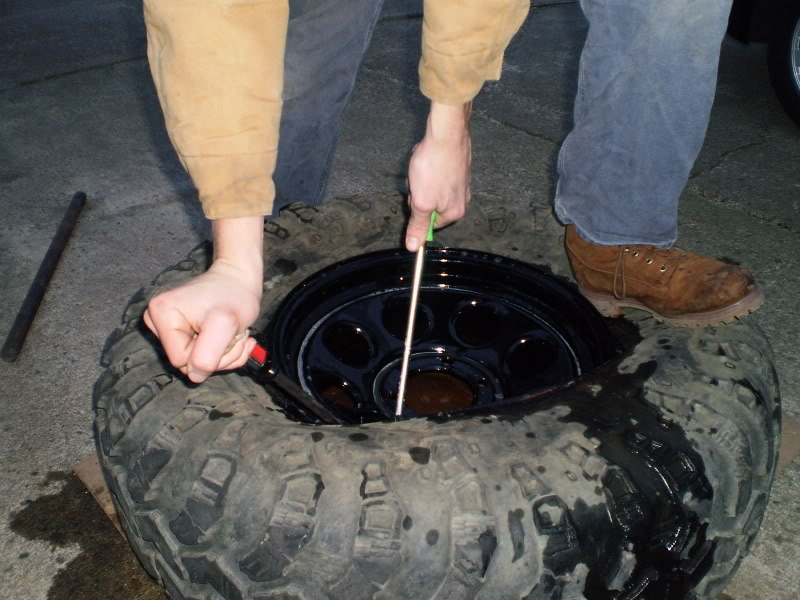

Not long after, I upgraded to 37x14.50x17 bias Iroks on 17x8 steelies… Mounted in my driveway with a little help from a buddy:

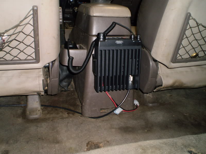

Passed my amature radio license and installed my 2m radio:

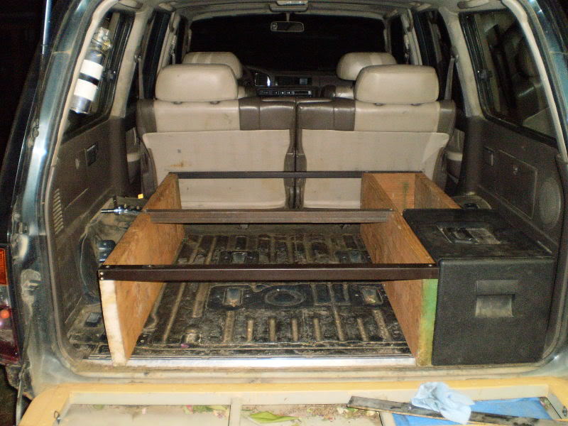

The next project was a storage / sleeping platform. This was built with random 2x12, plywood and steel I had lying around the shop.

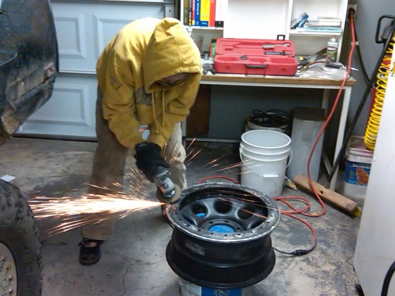

After talking with a buddy from Timbercrawler.com, he designed and punched me out a set of beadlock rings for my wheels. My loving girlfriend helped me get them all together.

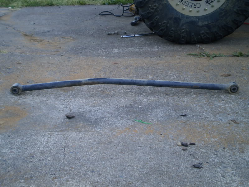

I finally got around to replacing my bent suspension pieces with new / better ones:
