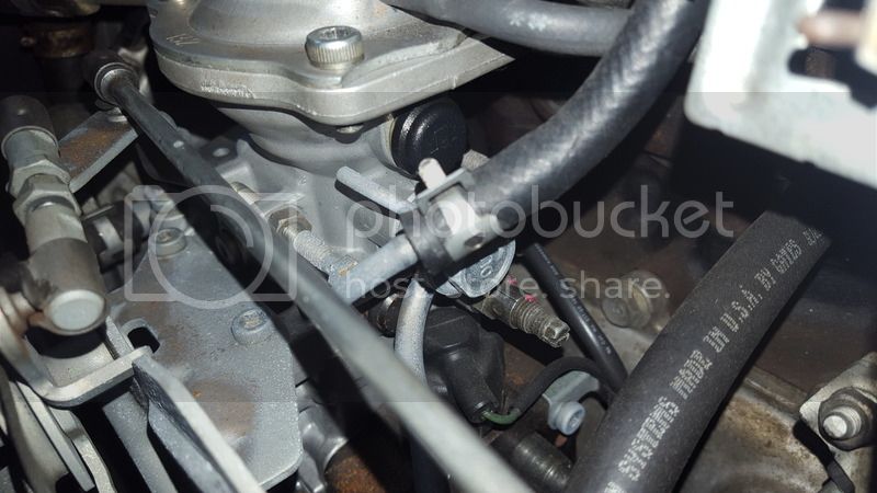

So, I decided to increase preload on the boost compensator spring today... and while I was at it, increase boost a few psi. I did that and the fueling "ramp" if you will was improved but my EGTs went up across the board. Just to be sure it wasn't boost related, I adjusted the boost back to where it was... still high EGTs. So, now I'm wondering if my main fuel screw is too open. Since, it seems like I'm running high EGTs across the entire RPM range and I'm getting a big puff of smoke if I stab the throttle in park. What do you guys think? I'd like to get this thing properly adjusted and be done with it...
@mudgudgeon
Also, if you guys say that I do need to adjust the main fuel screw to reduce fueling across the board... Is this the screw in the center of this pic?
yep, that is the main fuel screw. So changing preload made an improvement to performance?
if so, then yeah, try changing the main fuel screw a little. Start with 1/16, 1/8 of a turn. If you have the tuning close, you may not need to change the main fuel screw much at all.
Or leave the main fuel screw as is, and put preload back to what it was. Its a balancing act
Yeah, so what happened before was that at 3/4 throttle EGTs would climb to 1100 F on the long hill. But at full throttle, they would drop back down. From that, I guessed that I still was hitting fuel cutoff. So, I increased preload on the boost compensator a bit. This made performance, and EGTs climb quicker and, now, EGTs climb faster at full throttle than 3/4. Right now, I can climb up past 1300, if I stay in it. If I stay at 3/4 throttle, EGTs will climb to around 1100. It seems like the truck is running hot across the board. I backed the main screw off aobut 1/16th of a turn... still hot. Maybe better but still hot. Maybe I'll try backing it out a little more tomorrow. Just to be sure, I should be turning counter clockwise to reduce fuel, right?
