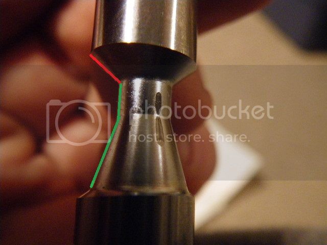

That makes sense to me... as long as the spring/rod in the boost compensator allow for the extra travel length. I think they do, since guys seem to grind their pins beyond the typical cutoff point.
That's where the shim under diaphragm comes in to play, right?
I think the "over-boost" section marked in red is too abrupt. There's no flat and no transition from the fuel ramp taper to the"over boost" taper.
I don't think the follower pin would ride freely across the abrupt transition, IF the aneroid pin is depressed that far.
Yes, the spacers, or shims stop the aneroid pin traveling beyond the end of the taper.

I'm thinking bout going all around the diesel pump and use Graeme's guide to check as it is along with some other tips that I read here. Mainly to check where the pin is riding in the arenoid and ensure it's riding the green marks and not the red marks on the following image.
