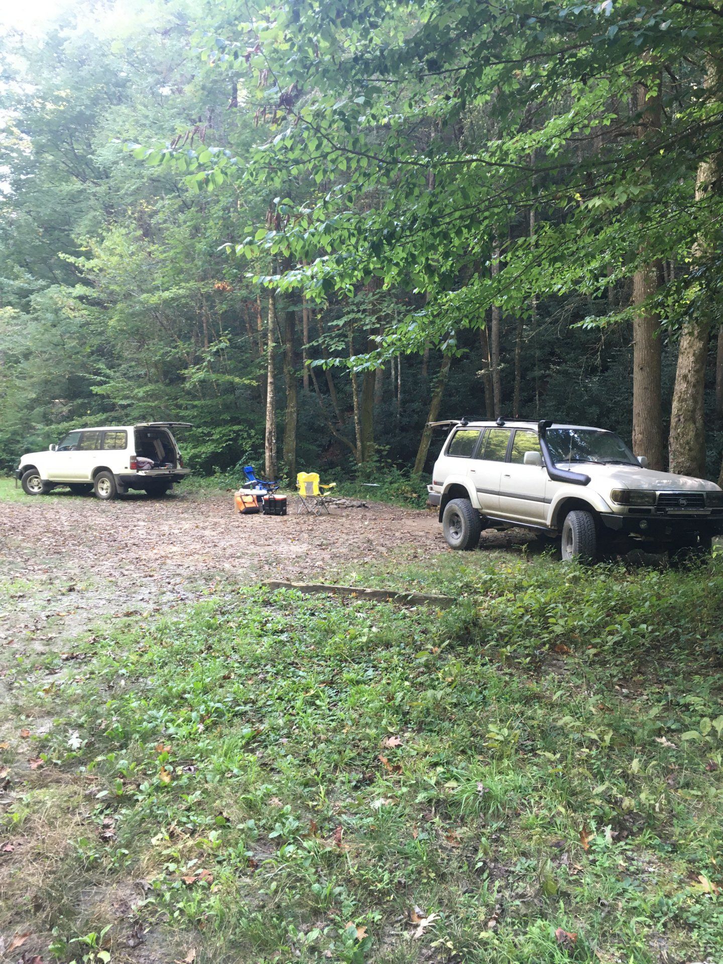

This was done during Labor day weekend. I had just talked my good friend into buying a locked 80 so to fully break it in we went up to the GA mountains in search of a camp site that sunday afternoon. Pretty silly idea on a holiday weekend and we knew it but towards the end of the road we finally found a spot that turned out to be the best we could have stayed at. Stream right behind us and plenty of room to play bocce ball until the sun went down.

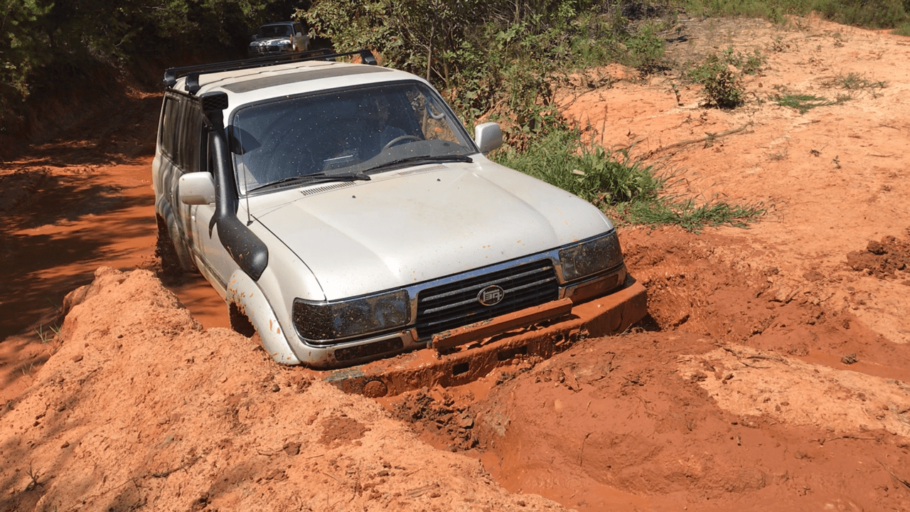

One trail ended at this mud pit. We stopped and got out and looked. I said, "yea, I'm not doing that". But after figuring out there was no place to turn around and we would have to reverse for 100 yards or so and some peer pressure I went for it. That was a mistake. I got stuck.. bad. That mud was thicker than cake batter and stopped me dead in my tracks and I sank. Should have gone with my gut.
No forward movement at all even with the Disco trying to pull me out. Which was probably a good thing. I would have never heard the end of it, that a Land Rover had to pull a Land Cruiser out. To pull out backward would require either getting in the mud to attach the strap or some very creative contortions to reach under the bumper. End up doing the Ladder. I don't mind being pulled out by another 80. My buddy got this picture which perfectly captured my mood.

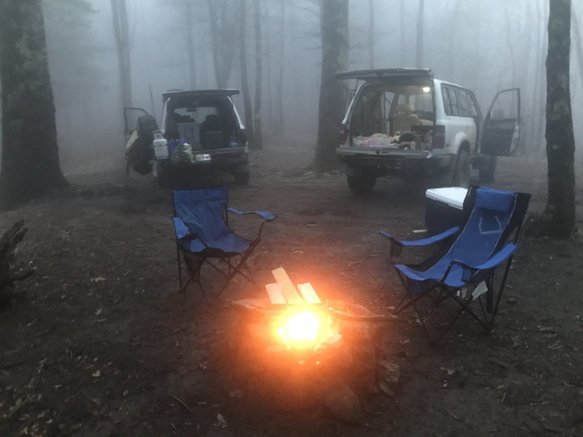

So after all that it is 6:30 pm. So we decide to find the closest camp site and relax after all that. Make some food and have some well deserved brews. We find a great spot and cheers to Allen otherwise I think we would have been camping on that trail. It ended up being a great trip.
Our foggy camp site:

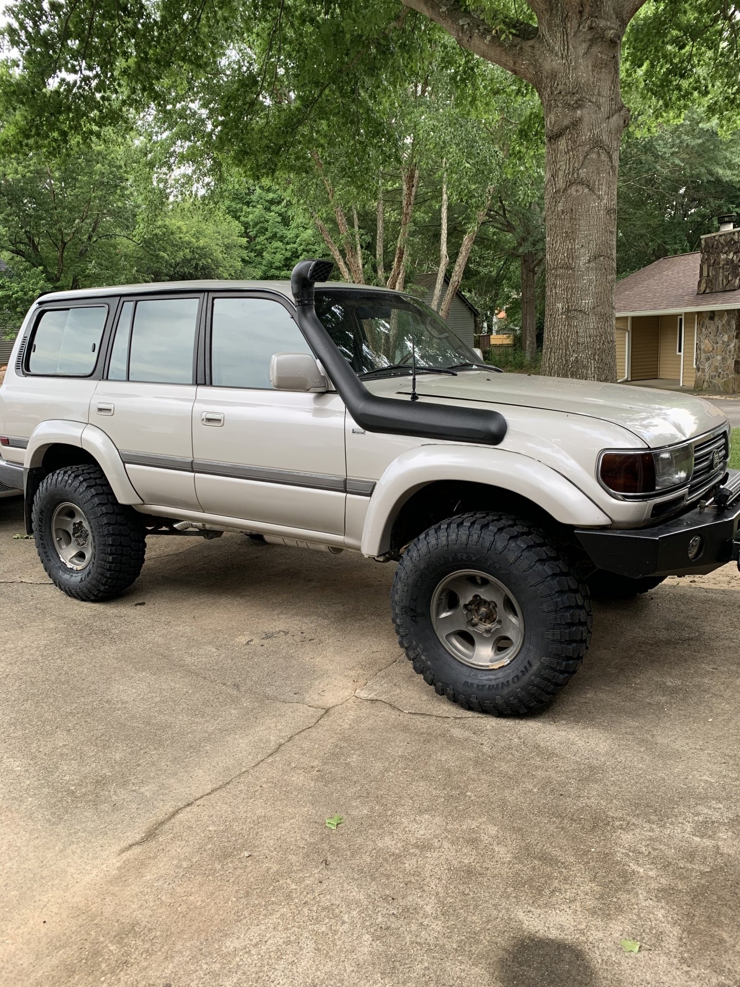

@man0fsteel Thank you for your kind words. I finally did get 315’s. I’ve posted a picture to show how well they fit since I hadn’t updated this thread. Word has it the 33 will fit under but definitely not a 35.
