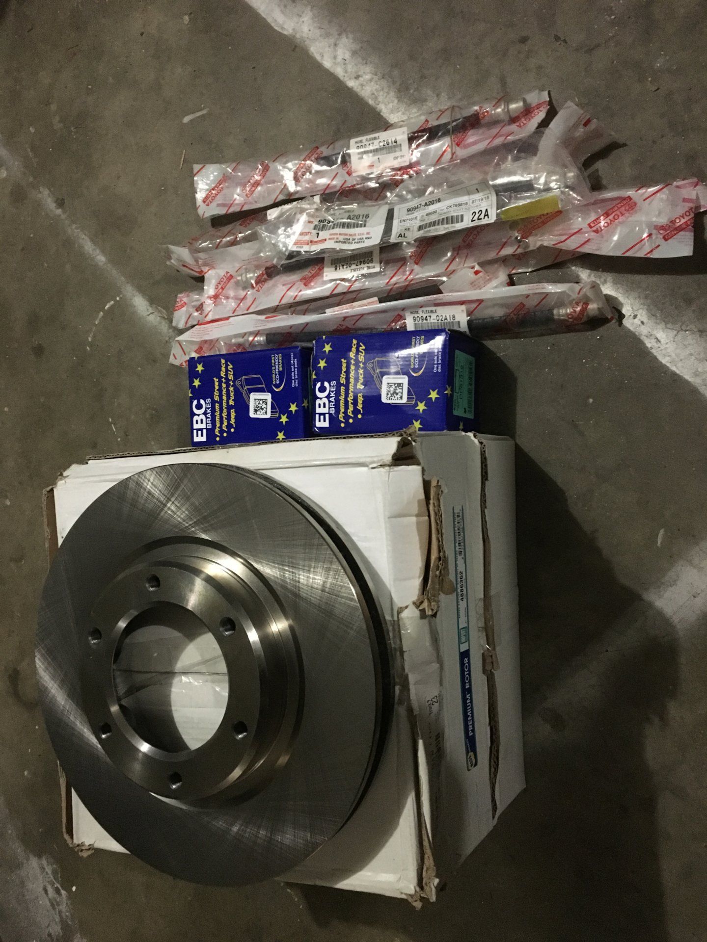

First to mention: I replaced all of the brake discs with Napa brand. Installed 100 series EBC green stuff pads in the front and 80 series EBC green stuff in the rear. I also replaced all of the rubber brake hoses with OEM toyota hoses and T100 extended length hoses.

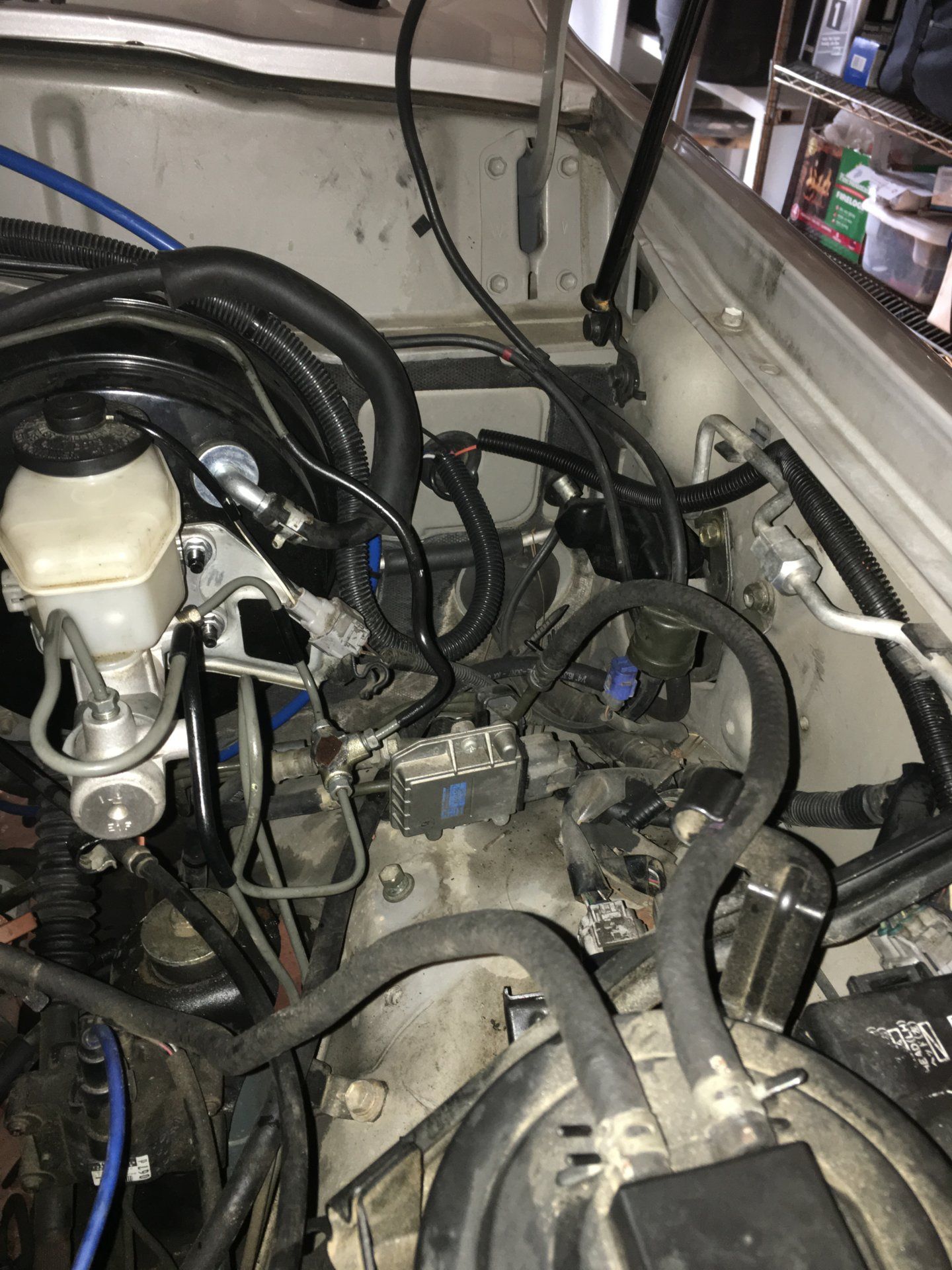

I decided to go ahead and delete the ABS and the LSPV. Huge difference in braking. Always had the feeling of not being able to get all the air out now I have a solid pedal.
Now I have a spot to put extra stuff:

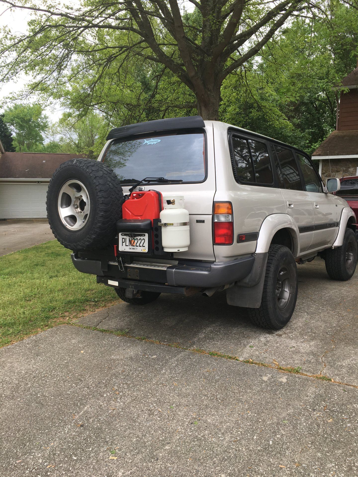

Next up was finishing my project to add a jerry can and propane tank holder to my swing out. I got a lighted license plate holder out of the junk yard and wired it up. I think it turned out pretty good:

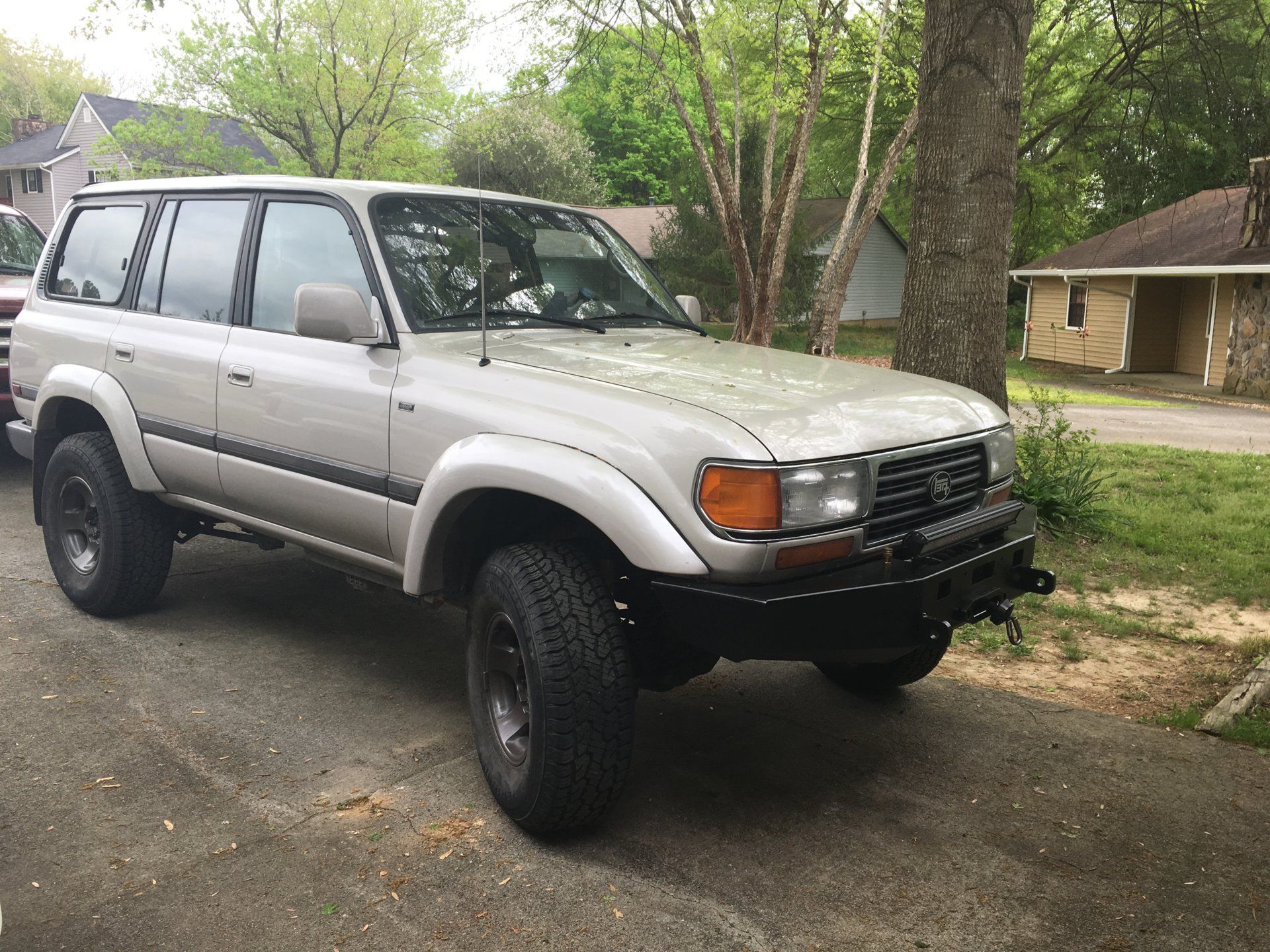

All fun projects with the exception of the engine replacement. I did not enjoy that. As far as the swing out, the only thing I would recommend is welding the fitting in the bumper that the strut connects to. I threaded it in and it moves around a lot. It will pop out one of these days and smack something hard. The York OBA is one of my favorite mods. No electric pump comes close. You’ll love it. The winch is a cheap 12k I bought off of eBay. Around $300 I think. I rarely use a winch so I couldn’t justify spending $$$. So many other things to buy instead.

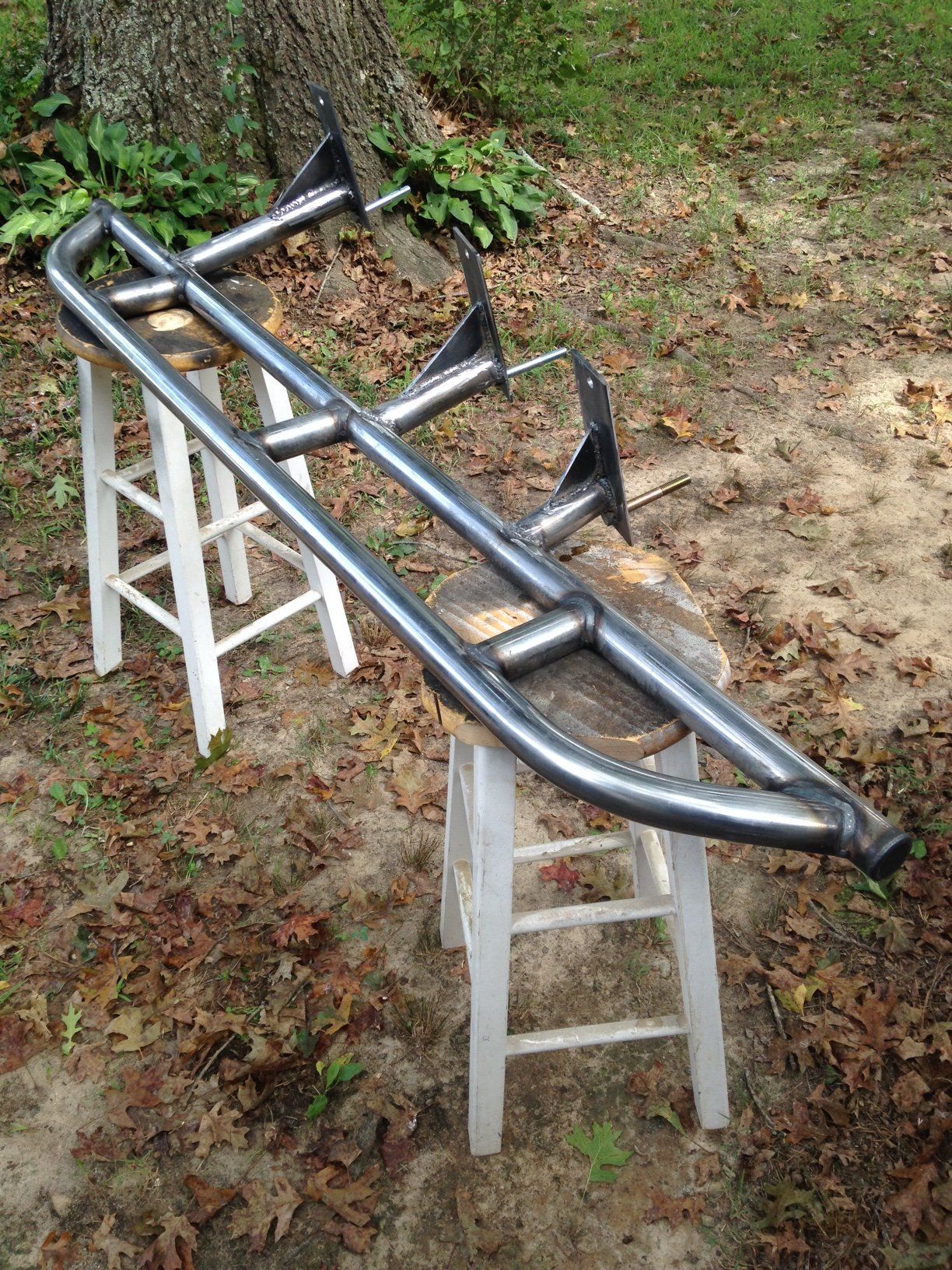

Finally had the chance to fab up the rock sliders and get them installed. I used the universal Trail gear kit and built my own brackets to bolt to the frame and heavy duty gussets. Glad to have this done and not worrying about bashing up my rocker panels anymore.

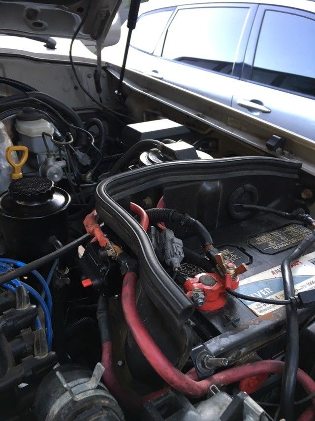

So after much thought and consideration I decided to scale back to one AGM deep cycle battery instead of two standard batteries. I got the Duracell group 31 AGM from Sam’s club. Removed the second battery, box and the isolator and all associated wiring. Much cleaner looking on the passenger side. Now need to figure out how to clean up all the wires going to the one battery.

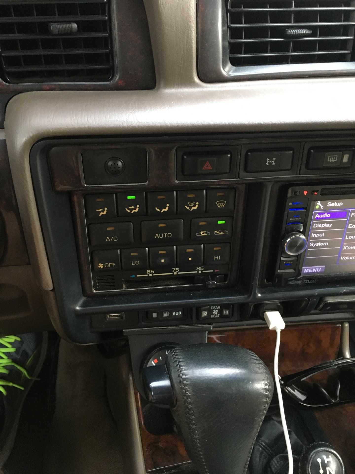

It is amazing how fast additional projects pile up as I attempt to complete one. It all started when I decided to add back lights to my added compressor switch and light bar switch so that I can see them at night. First I thought I need to clean up this wiring. So I do by soldiering and shrink wrapping every connection and adding braided wiring sleeving. It looks really nice. But then I think, well I'm here so I might as well add the 3rd switch to finish off the 3 slots in the panel. Since I want to add fog lights one day soon, I should wire that as well. The result of the first chapter of the saga:

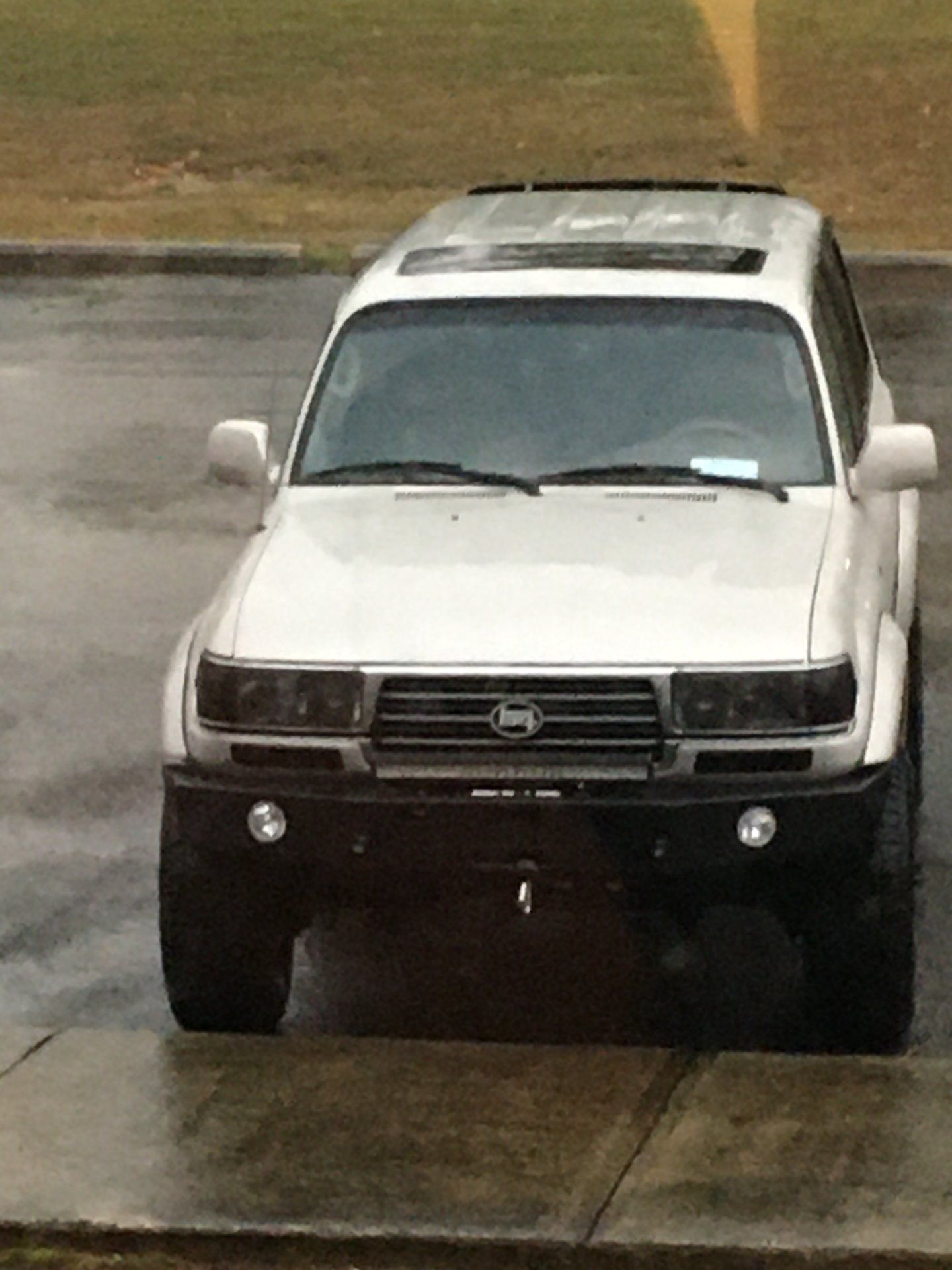

I was happy with the result and being able to see my switches at night. But having a switch there that does nothing is just plain silly. I might as well add the fog lights. I have had, in a box for a couple of years, a HID fog light setup. They are 3 inch round lights but require drilling some holes in the bumper... So here I go, I hope I like it:
Having fogs lights on my vehicles is important to me since growing up near the central valley in California where the fog gets quite bad. It just always feels like a necessity much like 4 wheel drive does. Holes drilled and lights installed shortly after, And holy cow they are bright! They put my headlights to shame. That will not and can not stand. New look:
So the next chapter in the saga is to find new headlights that can compete with the fog lights. This part took a lot of research. There are so many options out there and so many opinions. Rabbit hole after rabbit hole, I fell. HID, LED, Projector etc. But eventually landed on 9011 HIR (kind of) bulbs based on write ups on this site. I am happy with the result.
As I admired all my new lights, I realized that I had several lights out around the dash. Again I sprung into action and bought all the replacement bulbs and got all of those working too. Lots of light now. And it is satisfying. This is of course the abridged version of over 4 weeks of work.

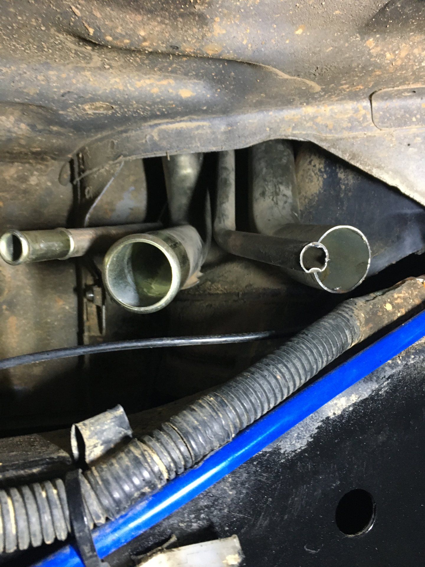

So I started with the dual filler neck that I bought from a guy in Aus. It was cut into three sets of pieces for easier shipping which was fine. I only cared about this:
The existing fuel neck and tubing came out in one piece. Having a 1 inch body lift helped with that. The dual neck had a bracket with a bolt hole that perfectly aligned with a nut in the body. I think this dual neck must have been used in 80 series as well. It aligned and bolted in perfectly. You can see the back side of the nut and bolt at the bottom left.

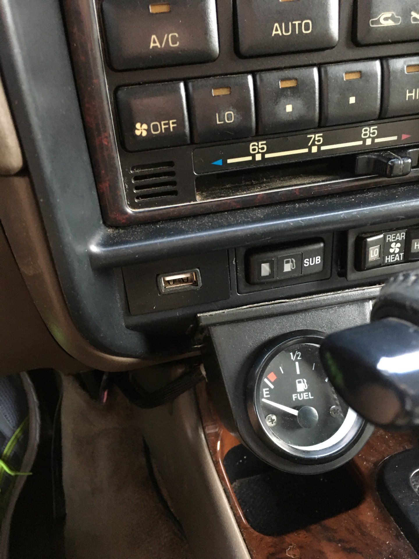

I installed the OEM fuel filler switch and gauge in the cab. I am not happy where the gauge is or how big it is. I need to find another solution for the gauge but it works for now.

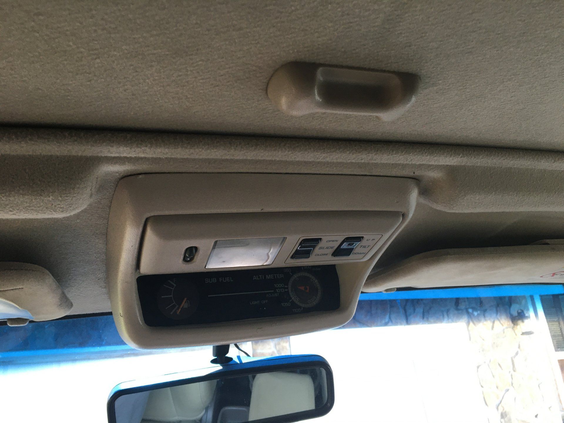

My aux fuel tank project is now, after a long part acquisition and installation, complete. Last night I installed the overhead fuel gauge console. The one I bought was grey so I had to spray it tan but the color ended up extremely close. So happy to be rid of my cheap fuel gauge and have a set up that looks oem. I may be becoming a purist. Well, maybe not totally because I ended up using visors for a 1998 4runner. But hey still Toyota right?

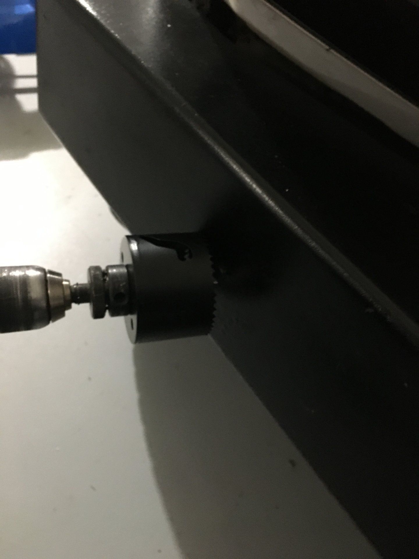

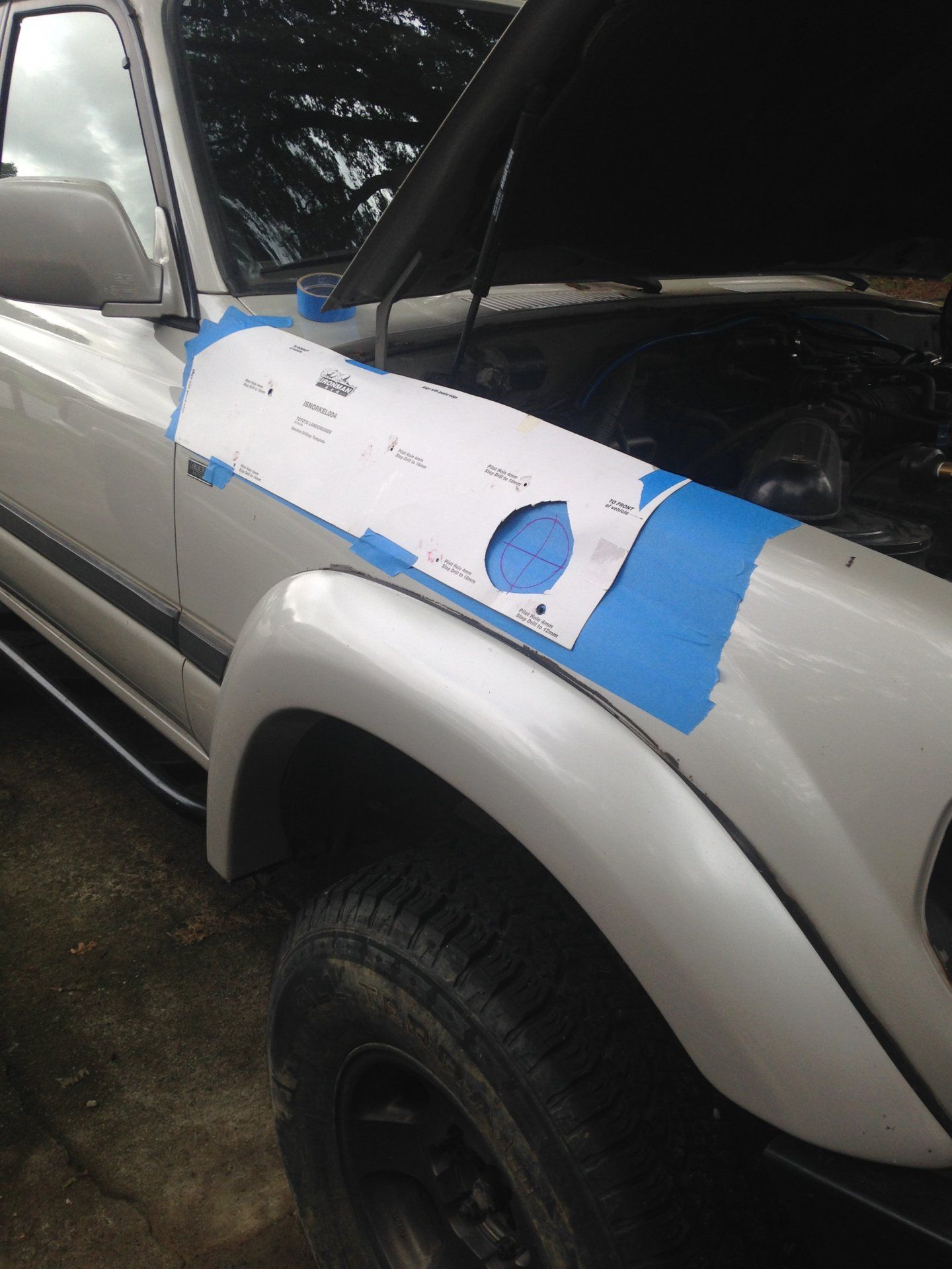

So, I did it. But I felt like I had to for two reasons:
1. Lower intake temps for a possible turbo install in the next couple of months.
2. Suck in less dust while driving around dirt roads.
And now people know I mean business. I got the cheap ebay/ amazon version. Nothing really to note beyond what other have said; measure several times, check the template and weep a little as metal shavings fly.
