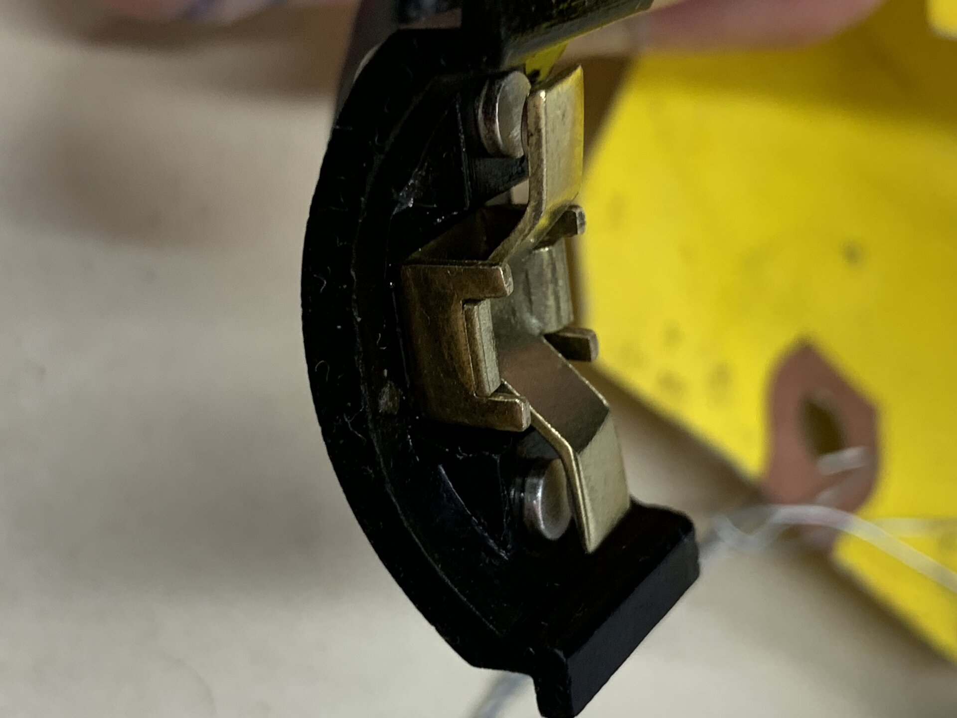

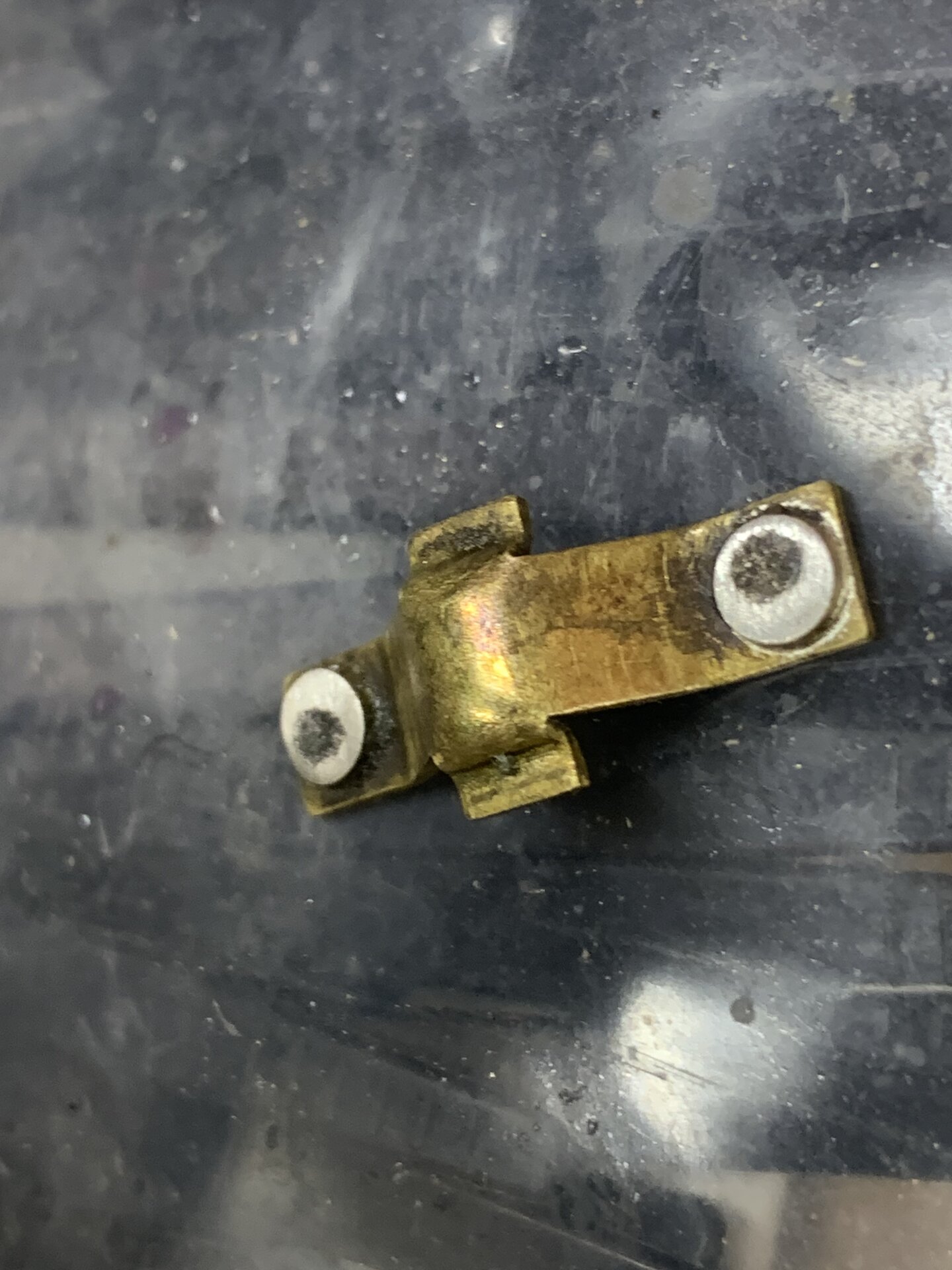

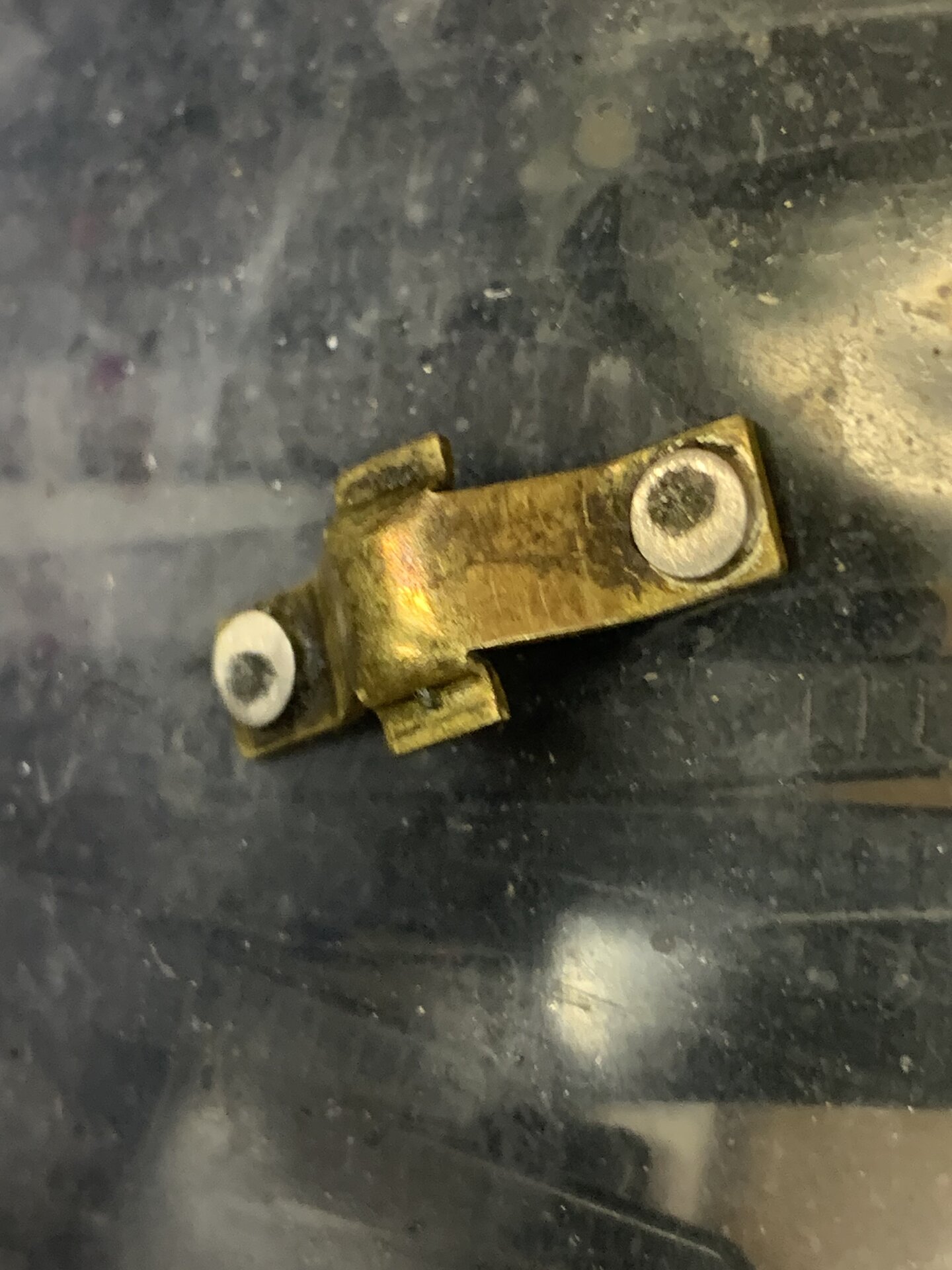

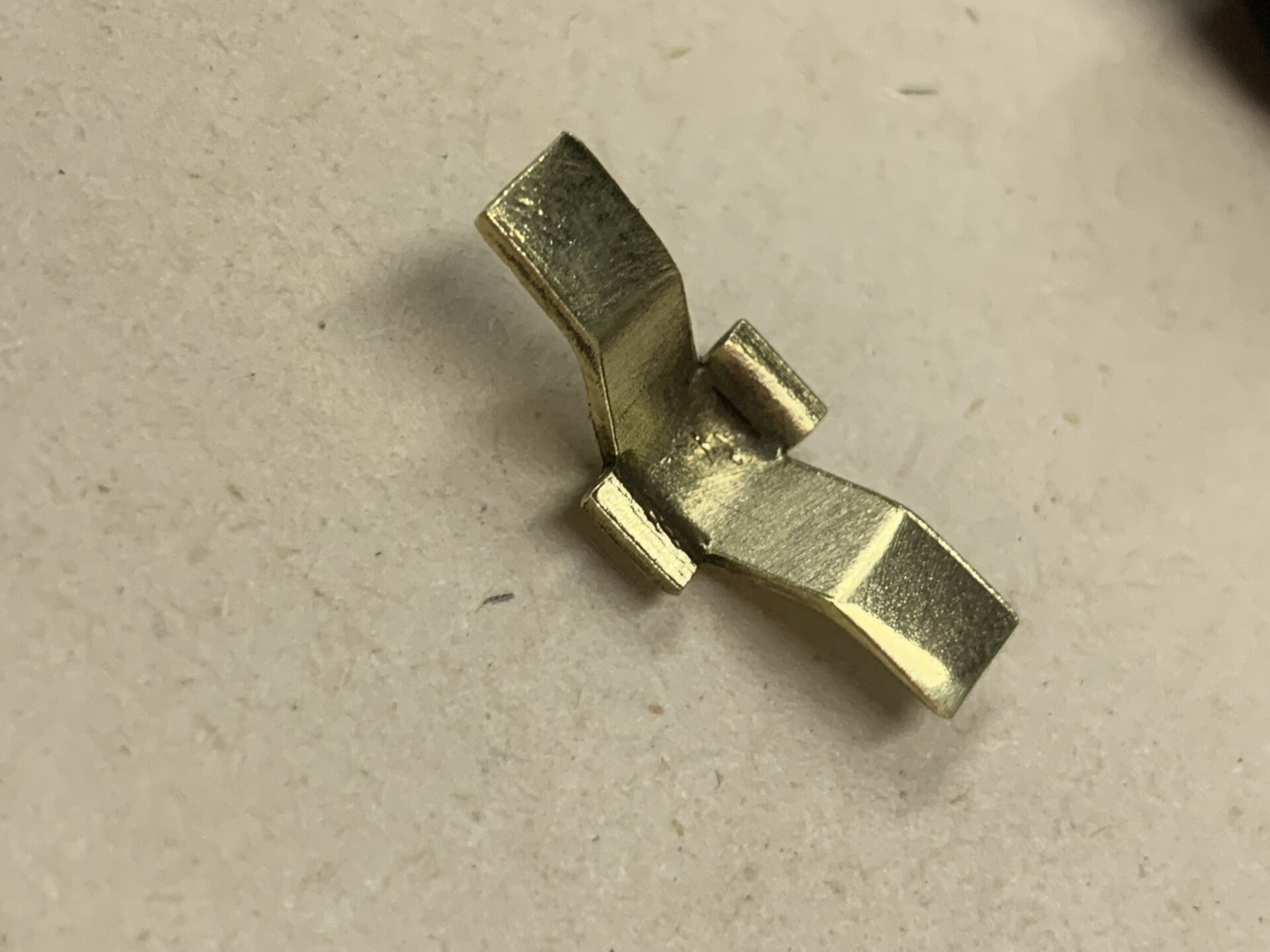

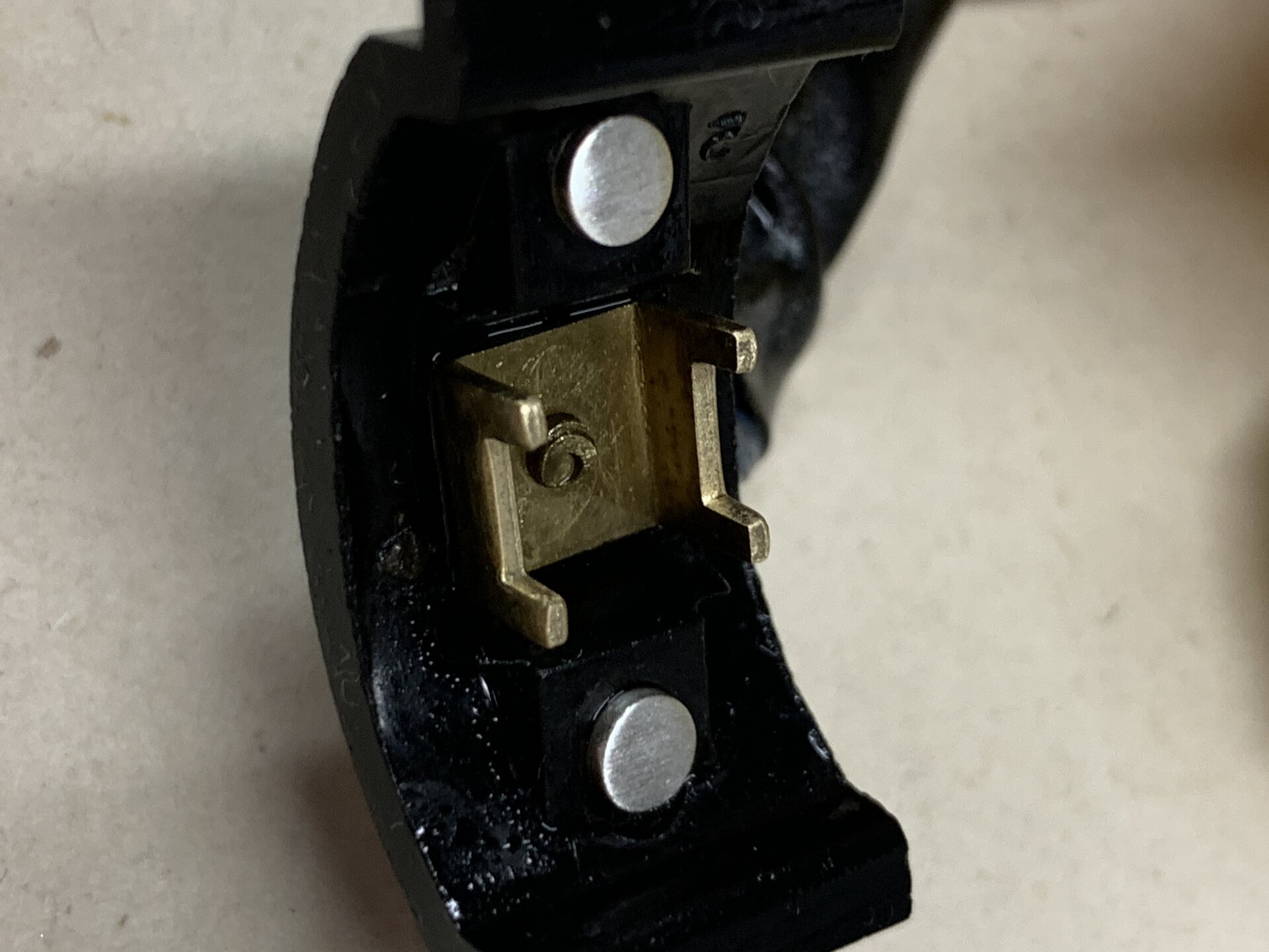

Finally got back on this and I'm no Toyota tech, but muddled through it. Now I have to do the switch in the Mud Hen.
I want to thank Matt for posting this, I never would of thought to take one apart. Now that I did, any of you guys can do this, just to clean up those contacts. Easy!
excellent job !

use a razor blade and carefully score the 3 ends heat shrinks , until you can spread them apart , remove it , and examine the 40+ year old double open barrel die crimps , you should see some level of age and time related corrosion and grizzle , i always refresh theses no matter what as good measure , i don't care how little it seams this amount of time in a some what covered tail gate shell is enough to create a voltage drop between the copper strands and the solid brass OEM YAZAKI M4 ring terminals , this is a : it's faster to do and get 100% solid current flow guarantee , then think about it for another maybe moment ....
i apologize for getting distracted from the off topic , and non-lock and key TECH jibber jabber above , otherwise these TECH. images would have naturally followed suite too above , so here the are below for you mr. @scrapdaddy , also did u apply a good clear high end fully synthetic food service grade di-electric grease inside before u shut the trap door on the rear ?
if not ? open her back up and lather up all the moving parts well , especially that plastic pin and its spring , they like stick get hung up a lot !
