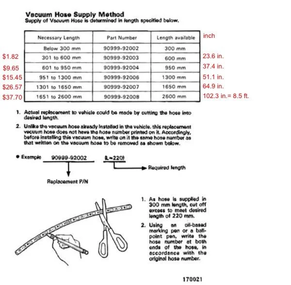

I'm late to the thread here. Great stuff! Thanks for everyone contributing to this. Hoping someone can help. I've been searching and searching but haven't found a definitive answer. I have the stumble. When I bought the truck, first thing I noticed was the vacuum hose's were very old and brittle. It's also a clusterf**k under the hood. Hose's disconnected. Mis-routed. Hanging loose. You name it, I've got it. I need to know roughly how much of each size of OEM vacuum hose to order (I believe the 90999-92003 (3mm) will do most of the job. But I think I need some slightly larger diameter hose (5mm) as well as some longer versions of the 90999-92003 (3mm) if I've read the threads correctly). The threads I've found say to order a lot... I'm fine with that, but I don't know what a lot is exactly. With Cruiser Dan now retired, the guys over at American Toyota still honor our discount and they're great to talk with, but they don't have the expertise he had. So they are asking me to find out how much I need of each size and to let them know and they'll get it ordered. I want to stick with OEM parts so I'm not looking for info on any aftermarket hose options. Can anyone help me?
Thanks in advance.
Thanks guys. I really want to go OEM Toyota on this hose. Problem is, I've only been able to find threads that talk vaguely about the OEM hose or that suggest McMaster Carr. If I can't get a clear idea of how much OEM to order, I will have to just go with McMaster Carr and call it a day.
Measure up what you need. Takes 15 minutes.
This breakdown of Toyota OEM hose gives you the length to price comparisons. 90999-92003 is the most economical way to go. 600mm pieces.
