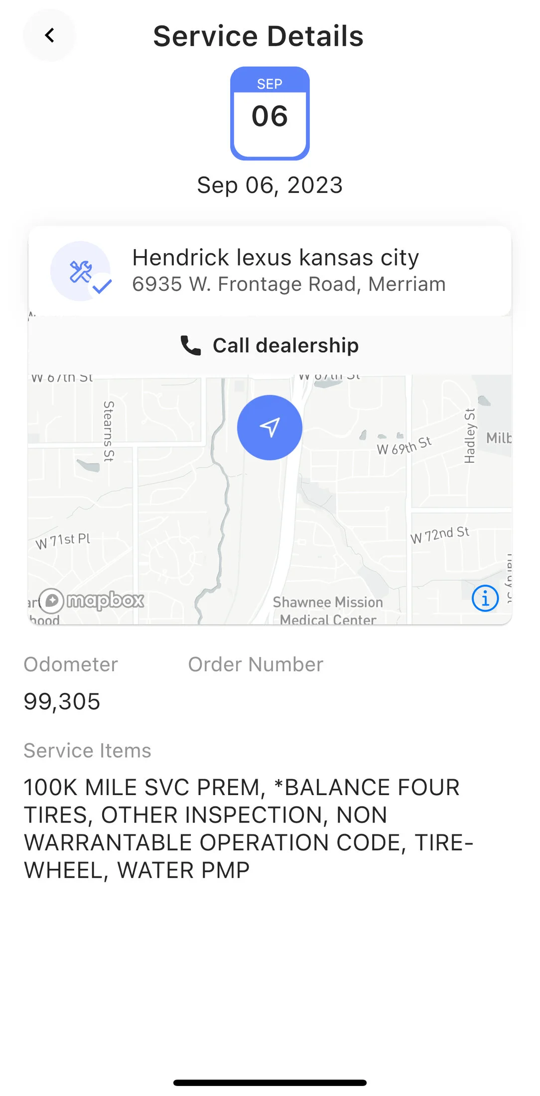

I have a 2017 with 112k miles. Car was dealer maintained with oil changes every 5k miles as shown on the Lexus app. If the 100k service was performed, I'm assuming they coolant was flushed per the schedule.
