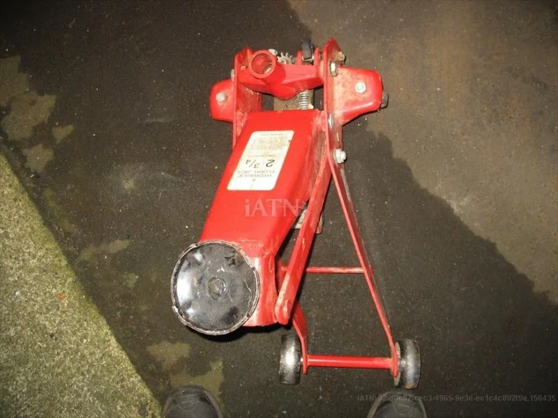

not only jack stands but jacks to!! mine twisted
It was a jack that I has borrowed from the customer, because mine could not raise the extra inch needed to get his truck left rear corner off the ground.
I put this jack on plywood and put two stands under each axle. Working on both brakes went well. After putting on the tires, I pumped up the jack, then reaching under the truck under the diff, grabbed one jack stand on the right pulled it out. As I was under the truck reaching the left jack stand, I could swear I was starting to see the truck to move to the side....very slowly. I did not hesitate and grabbed the jack and pulled out from the back of the truck. The truck was moving to the side, then the jack collapsed and truck came crashing down on its tires. After looking at the plywood, the tire was close to the edge, and for some reason the wheel of the jack was sunk just 1/2 into the plywood. It was enough to cause the jack to buckle and collapse.
If you look at the pick, look at the sidewalls. Totally twisted sideways. The sidewalls do not have a bend in them "think 90 angle iron" to give it torsional and lateral rigidity.
