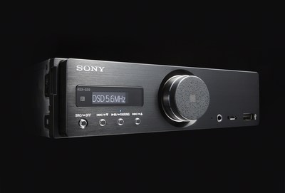

Just go all out and get a Hi-Res Audio unit.
269100
j/k - I was in my local car audio shop last week and happened to see a pamphlet for this Sony unit. Looks impressive. Nice to see that there is still demand for analog quality. At least in some people's ears.
