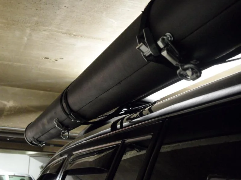

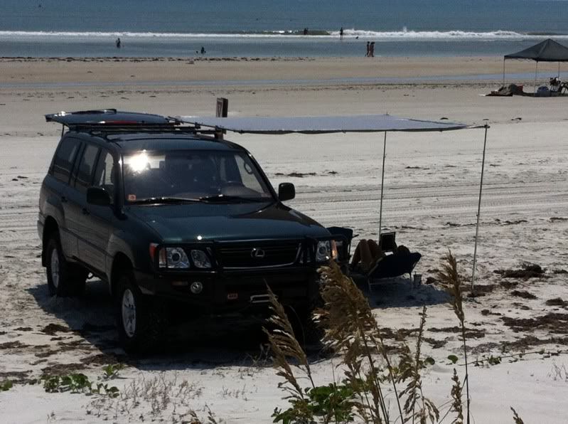

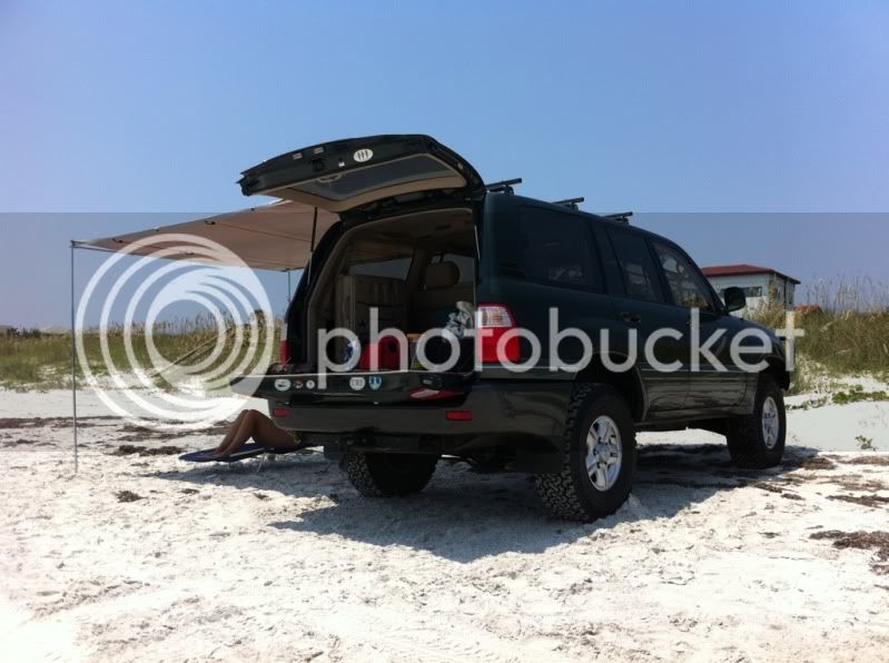

Nick, these are the only pics I have on my tablet right now. I can snap pics later of the jaw slides and eye ends that I used at each corner for the poles to swivel into place and into their stowed positions.
Description of the following pics:
Latches to hold the PVC door closed and quick links to lock em. Lash straps are for extra security, may be overkill but I feel better with em there.

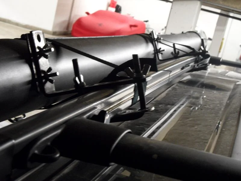

2nd, small u-bolts hold a 3/4" EMT conduit (which the tarp is screwed into through the eyelets) on the inside of the PVC. U-bolts then screw onto L-brackets. Brackets then screw onto square u-bolts that attach to the factory roof rack. The square u-bolts will slide to one side due to the weight of the contents housed within the PVC and the not-so-square shape of the roof rack rail.
I also drilled some drain holes in the PVC and plan to put some sort of weather stripping for the door.
Overall, I am really happy with how well it has held up against some pretty strong winds we've had here lately.

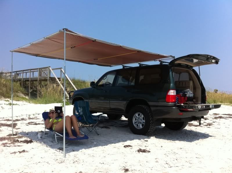

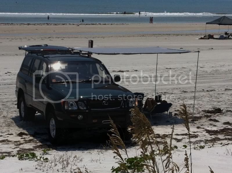

I'm guessing you are in the outer banks in your beach pictures. Looks great! We're running out of beaches with auto access it seems...
its St. Augustine, FL but i think the PO was from the Outer banks area
it passed the beach test!
Question: Did pass the "Beach" test or did it pass the "Wife/Girlfriend" test???
In the pic, looks like it passed both.
