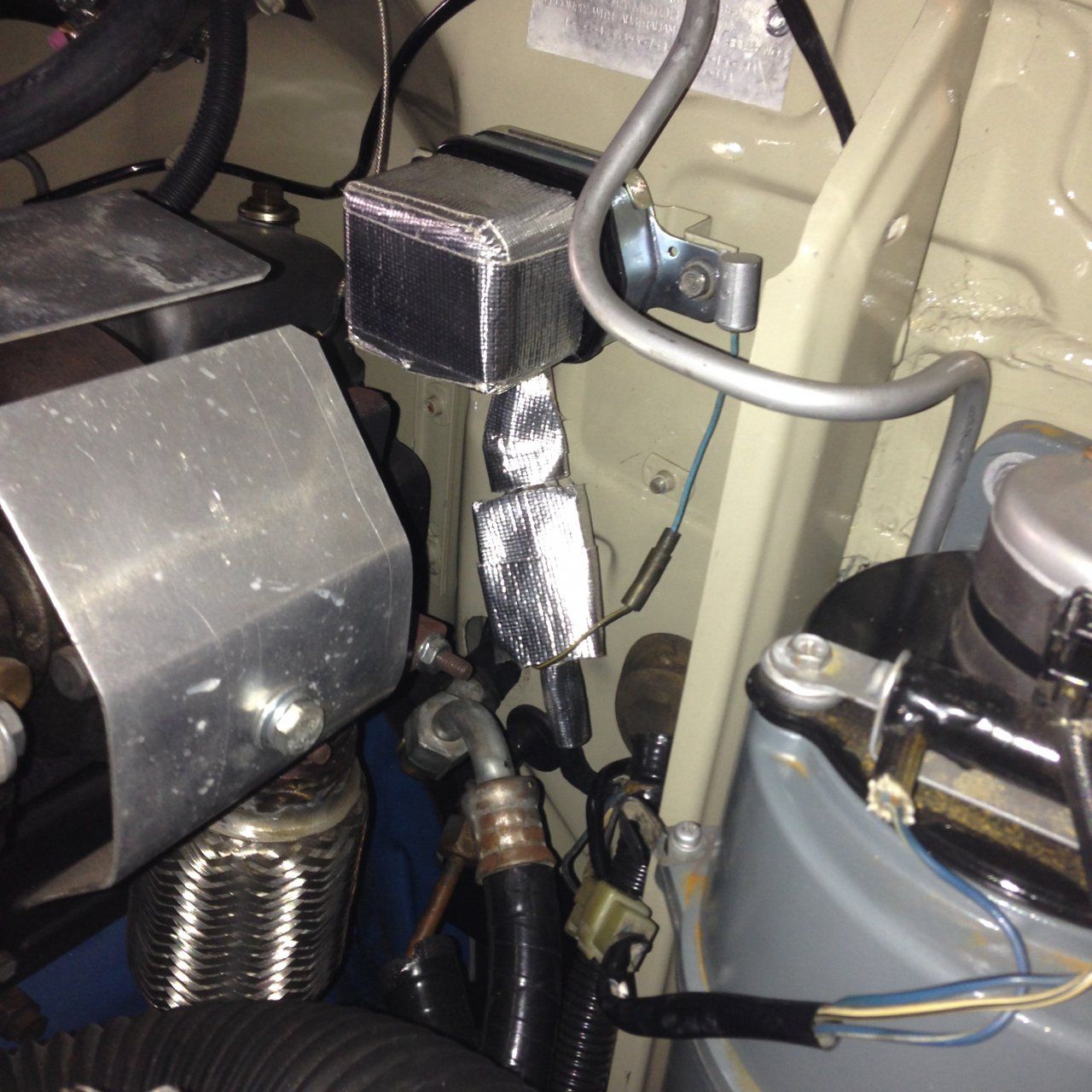

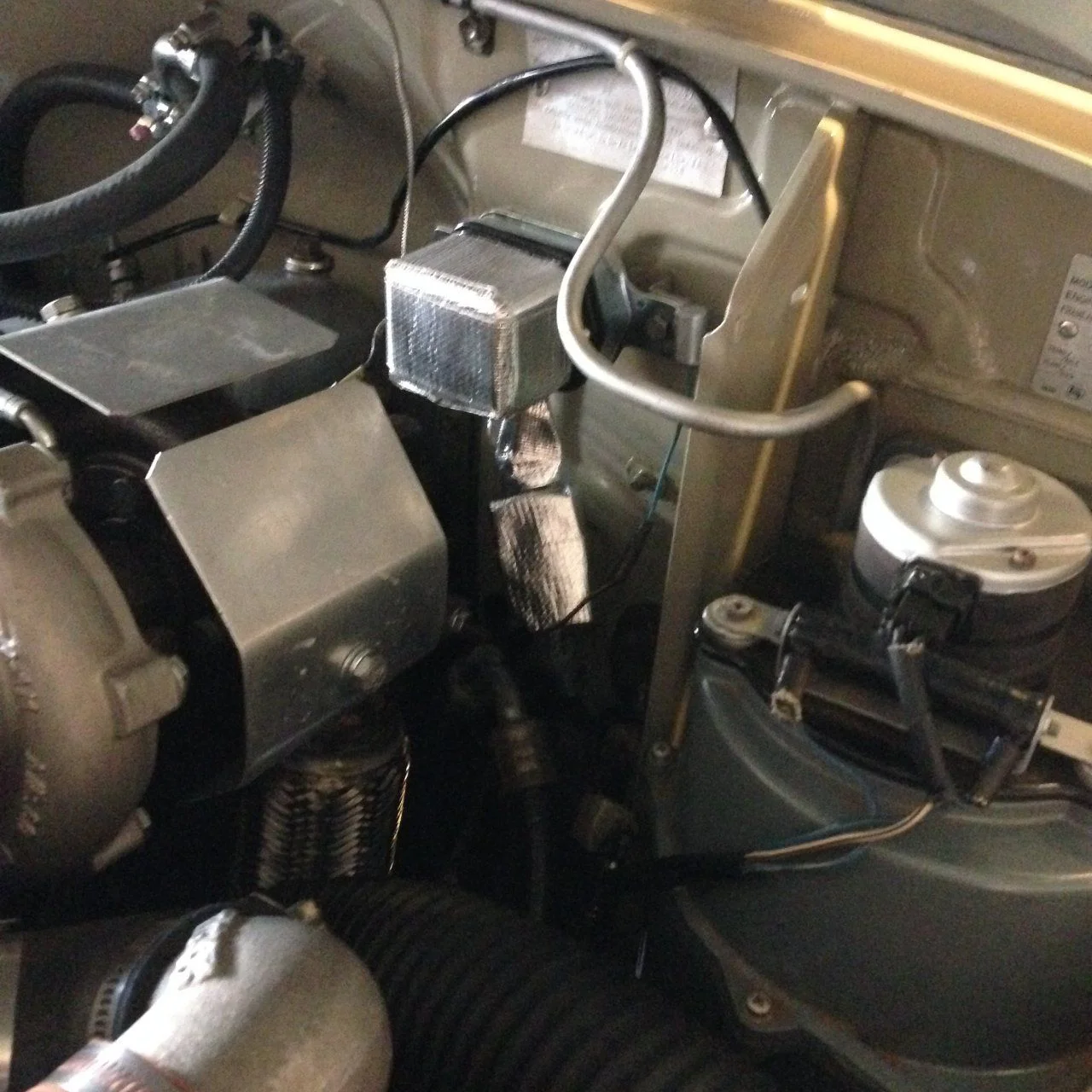

On the up side, the battery charging issue is fixed. It was the voltage regulator! I ordered a new OEM Toyota VR and the battery is now getting 14.5 V from the alternator. I'm wondering if the turbo exhaust flange, which is 1 inch from the Voltage regulator, may be frying the VR internals??
I got some reflective wrap for the VR, but I think I may get some exhaust wrap for the turbo exhaust outlet which can get up to 900 degree F. I'm posting up some pics of the VR with the turbo exhaust flange.
By the way guys, the voltage regulator was bad. The original one was bad and the new NAPA one did not work. So the one I got from Spector
(which is a Toyota unit ) works. Thanks for the help. I am wondering if the turbo exhaust flange which is 1 inch fro the VR may be frying the internals ?? i wrapped the new VR with reflective insulation.
Shame to hide that beautiful OEM VR Scott but I guess heat (from the close proximity of your turbo-modified exhaust mainifold) could well be the issue here..
I'm surprised you can still get a genuine OEM 27700-15040 too!! :clap:

If I can't get that exhaust section wrapped, I will relocate the VR. There's so little room there to fashion a good heat shield.

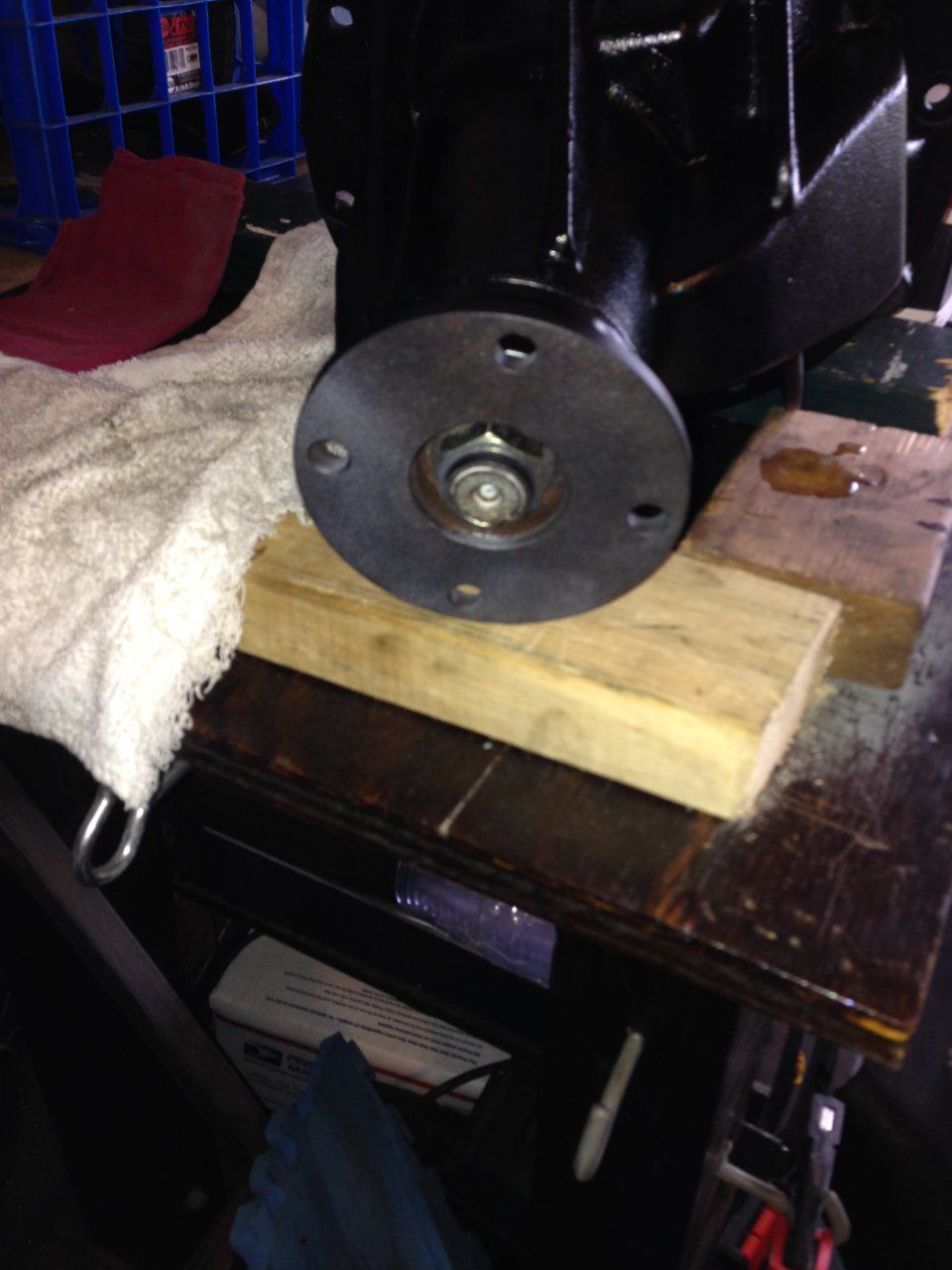

For those like me who've never replaced a differential; you may find that the mating flanges are different. I never thought about that and assumed that if the diffs were interchangeable then the flanges would match up. Not so! The 3.70 diff is from a "86 or "87 60 series which has a larger yoke/flange. They don't match, as you can see from the 2 pictures. I called the guy I got the diffs from and he told me the year and model they came from and I went on the SOR website to get the correct yokes (and new u-joints) for these diffs. Looking at their site, I could see that there are several different yokes depending on the year. Another lesson on the long journey towards Cruiser wisdom. But, I should have thought to check before I started, now I'm waiting on parts again. Next lesson; u-joint replacement 101. I'm going to Harbor Freight for a U-joint press tool!
.... you may find that the mating flanges are different. I never thought about that and assumed that if the diffs were interchangeable then the flanges would match up. Not so! The 3.70 diff is from a "86 or "87 60 series which has a larger yoke/flange. They don't match, as you can see from the 2 pictures. I called the guy I got the diffs from and he told me the year and model they came from and I went on the SOR website to get the correct yokes (and new u-joints) for these diffs. Looking at their site, I could see that there are several different yokes depending on the year. Another lesson on the long journey towards Cruiser wisdom. But, I should have thought to check before I started, now I'm waiting on parts again. Next lesson; u-joint replacement 101. I'm going to Harbor Freight for a U-joint press tool!
From what I've read, the common solution is to drill another set of 4 holes to suit the smaller flange Scott (and locate them equidistant from the existing ones for strength/engineering-best-practice).

I thought about that Tom and in the end I was worried about vibrations or balance issues, if I didn't get the holes perfect so it was centered properly. But it sounds like people have done it so it must be possible. I did manage to get the rear u-joint out. I think it may have been in there 20 years or more because I spent at least 2 hours getting it out, but again, it was the first u-joint I've ever removed. I used a ball joint tool (giant C-clamp), an impact wrench, a grinder with a cut-off wheel, a big F-ing hammer and a giant drift with some serious profanity thrown in ; it's out! The next one should be easier.
