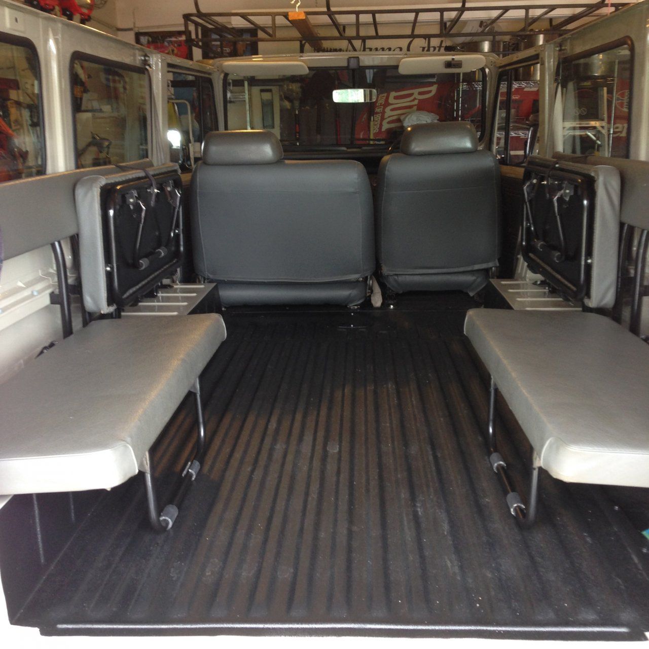

I re-installed the rear seats after doing some painting on the frames and backs. The roof is
supposed to be ready this week??
