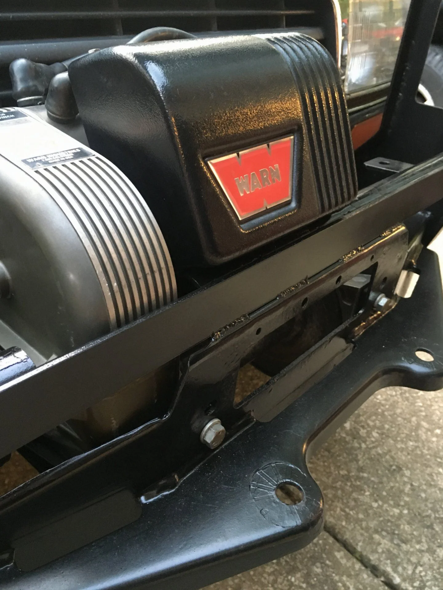

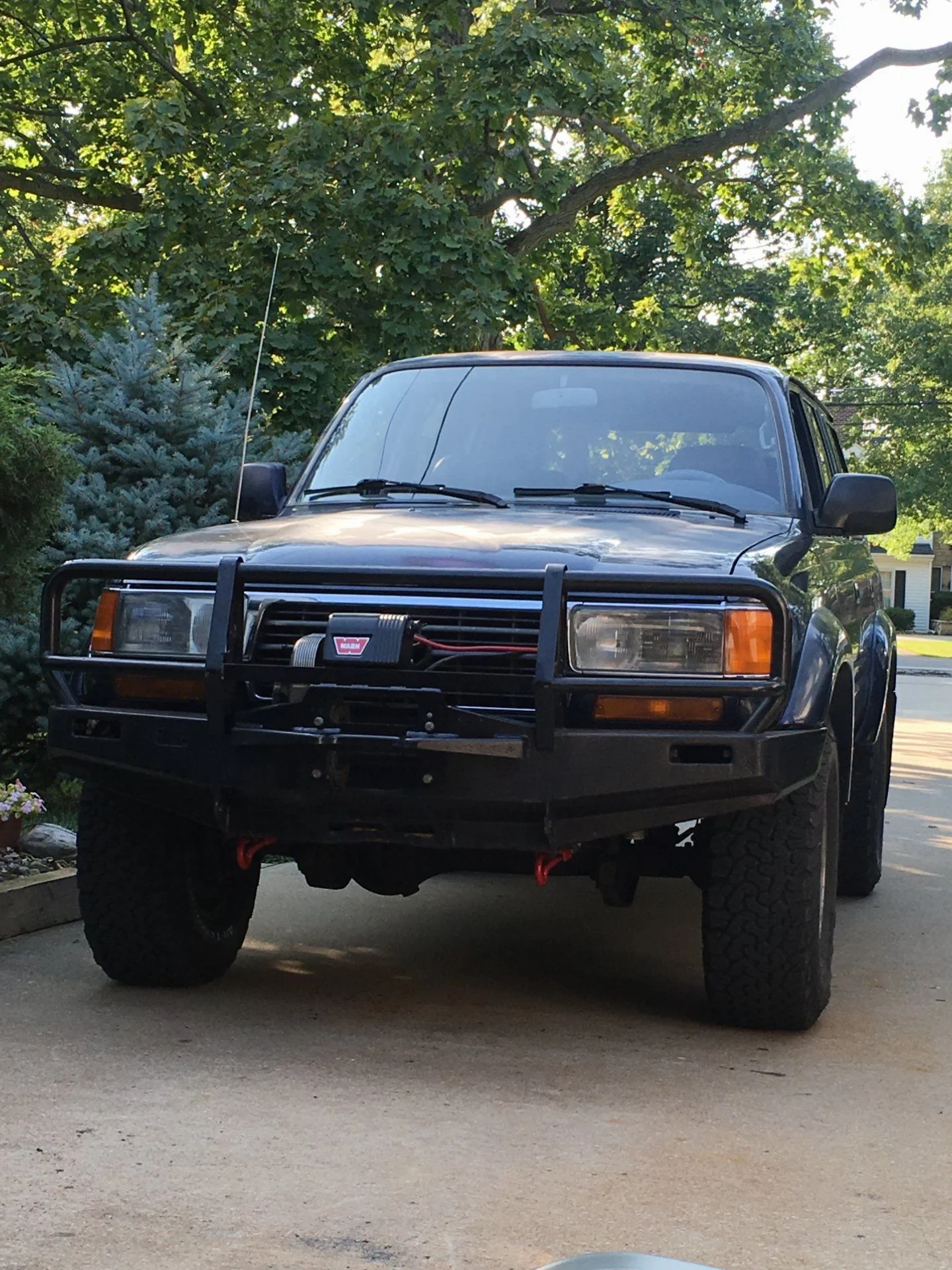

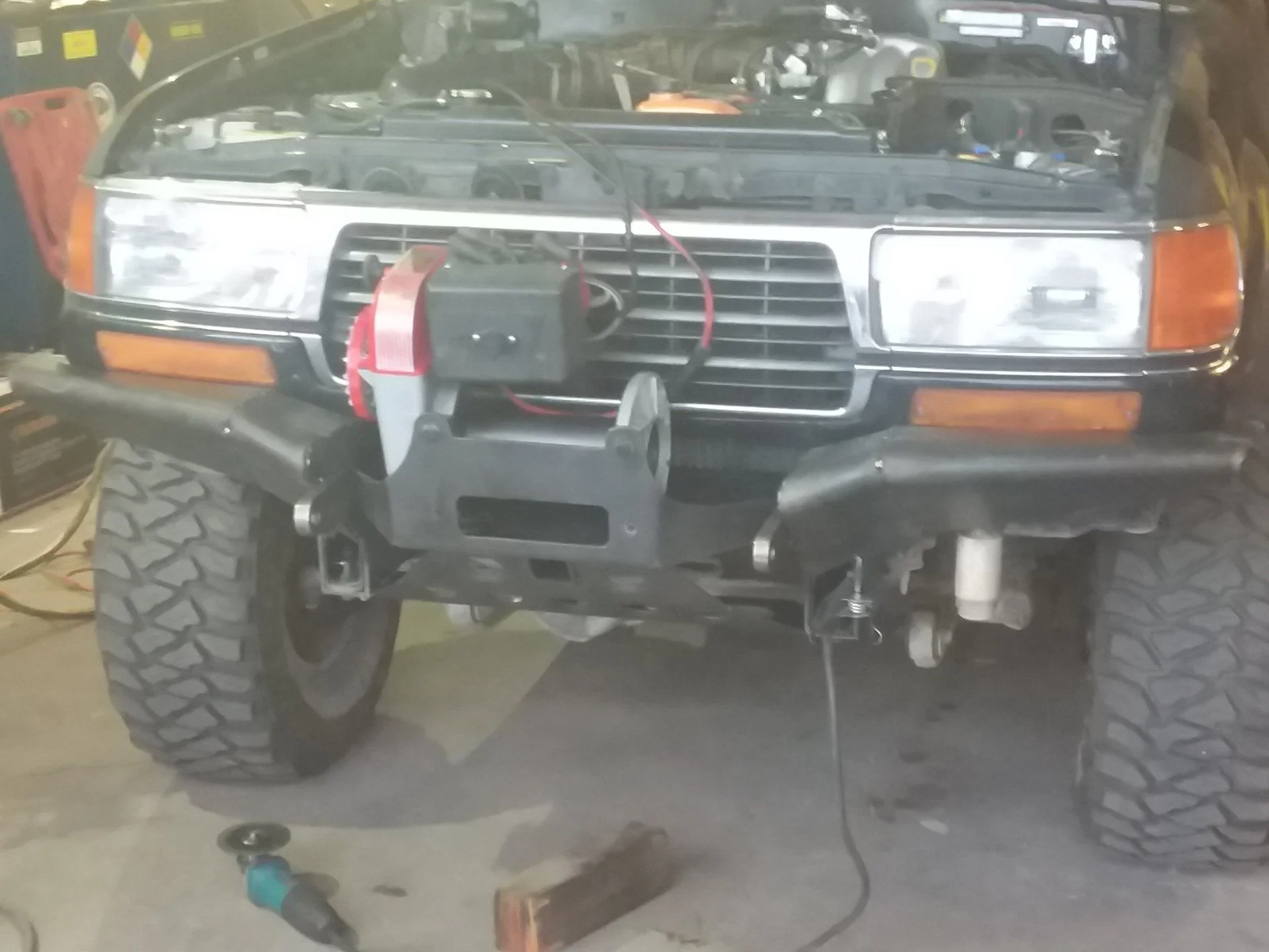

Well it's on after some cutting and welding with 3/8 spacer no grill modifications.
I just added a 1/4 by 1-1/2 steel strap to tie back together. I'll finish up the farelead this week. Need longer bolts due to the 3/8 spacer behind the bumper. This is just temporary due to a trip to uwharie planned this month. I'll strip it all down this winter and make more mods before powder coating. I wand to trim the fat and add better recovery points.
Looks good, if I had an arb bumper I would definitely copy you.

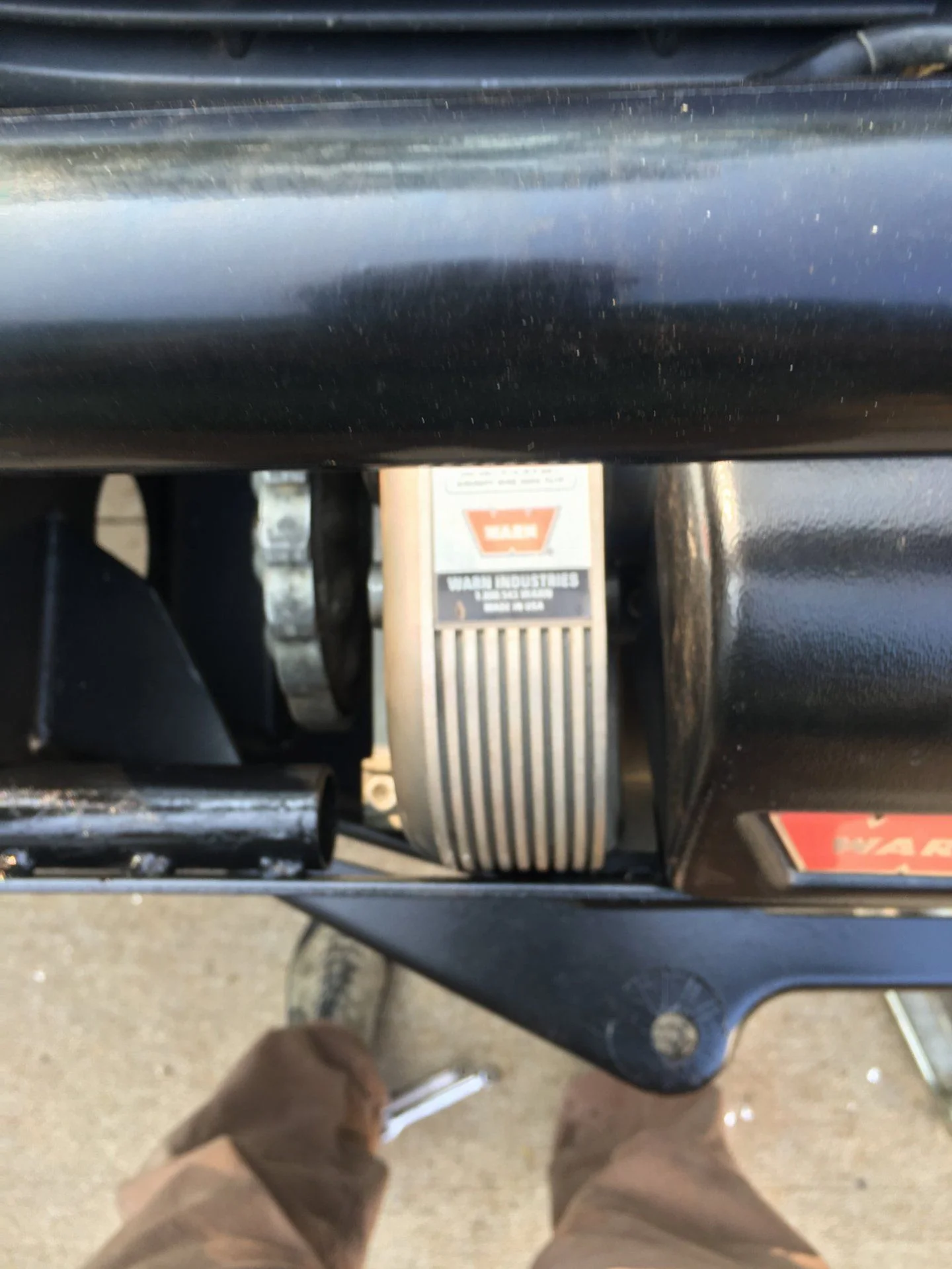

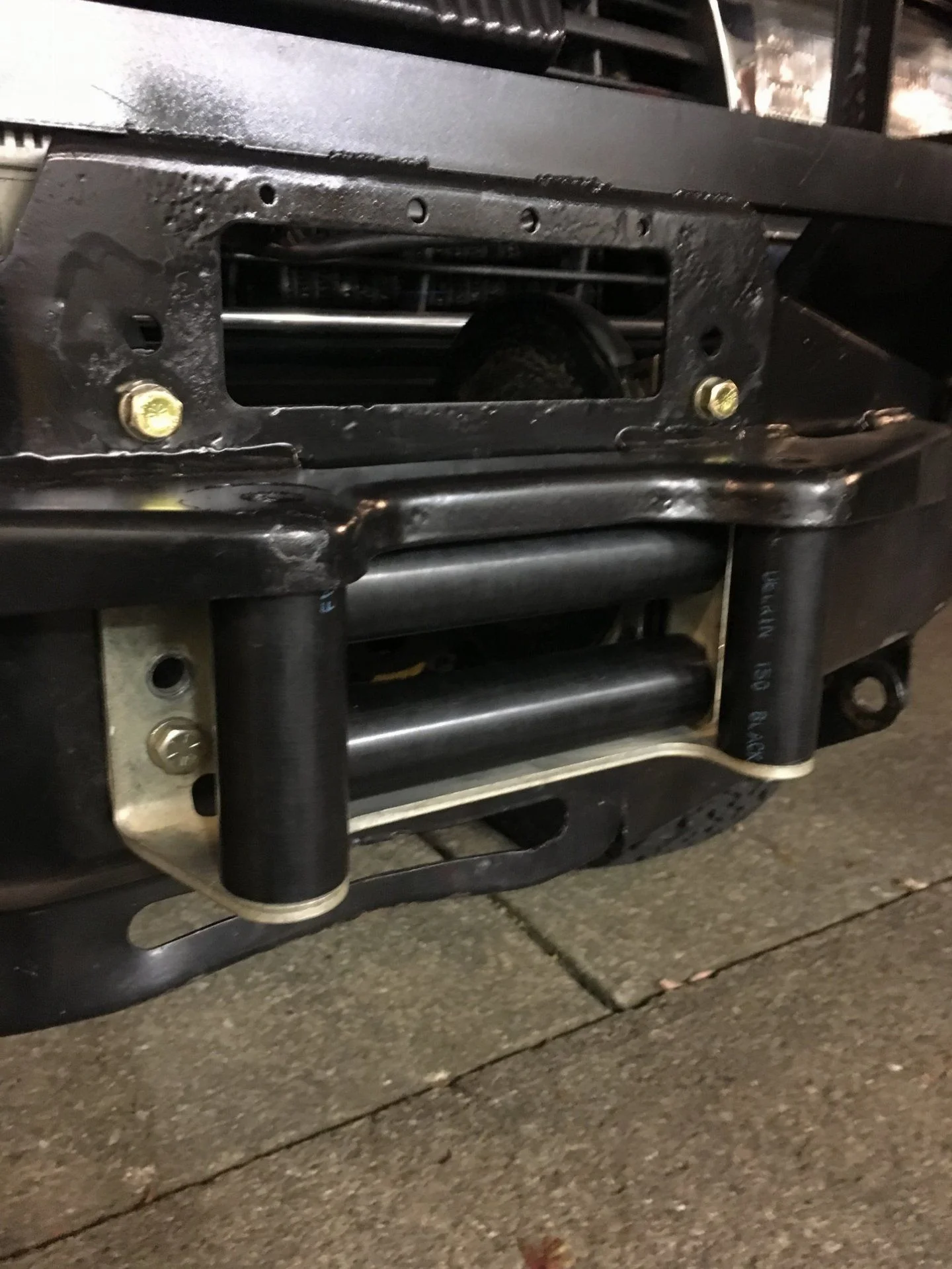

Forgot to post the strap photo that I referenced. It's not perfect but hopefully it will add some strength back into it
Forgot to post the strap photo that I referenced. It's not perfect but hopefully it will add some strength back into it View attachment 1534693

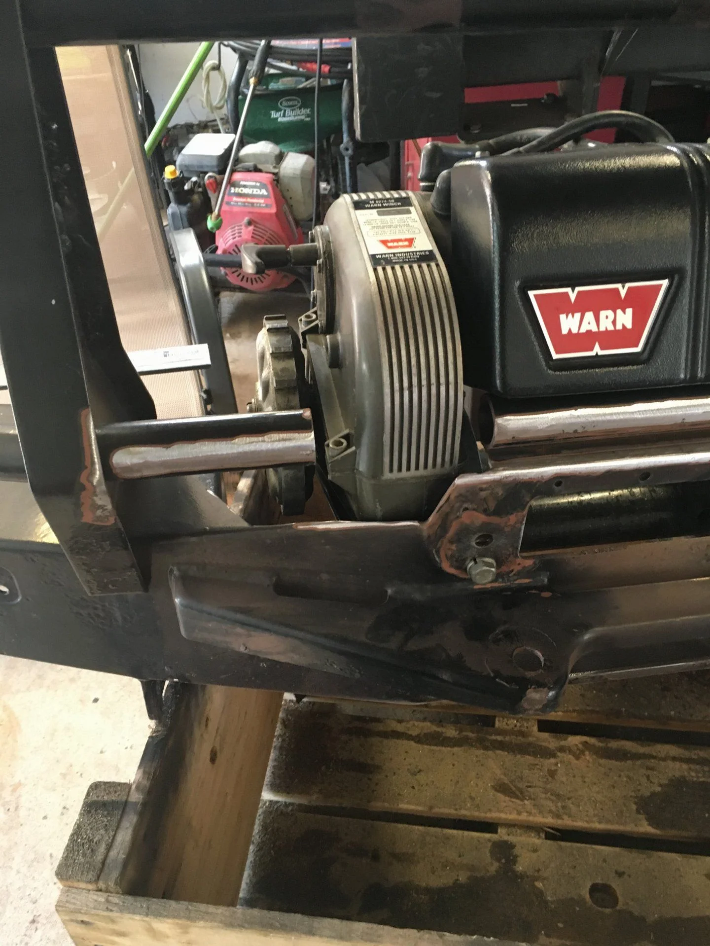

This is a great picture that illustrates why folks are taking one of two paths for this winch mounting solution:
- set way further back and keep the ARB horz round tube intact and NOT cut into the grill.
- or, don't modify the horz round tube BUT cut into the grill because the winch will sit further back.
Thank you @taco162 for the great shots and feel free to correct me as needed.
Wonder if that round stock could be removed and a new (reconfigured) one welded in its place, as on the Commercial Bar.
I thought of that at first however on the commercial bumper pictured the entire winch section is moved forward if you look closely. If one were to cut out the entire bar it would comprise some of the strength do the winch face. I have next to nothing invested in the bumper so cutting it does not concern me at all. If all goes well I will be pulling it this winter and doing a complete make over. I just needed a quick and useful set up for next weeks trip.

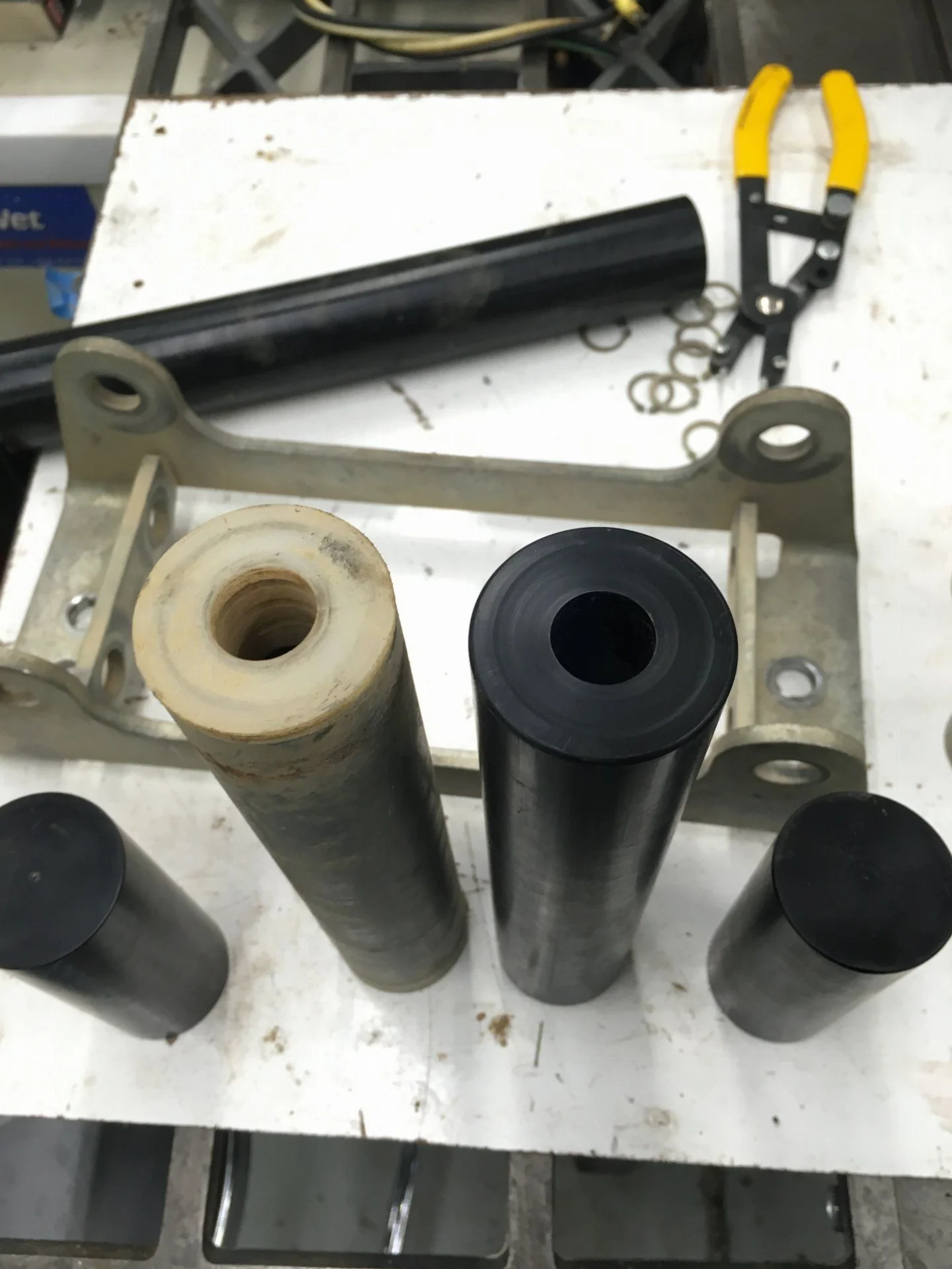

Thanks, I enjoy making things when I get the time. Yes the plan is to run synthetic line. My friend has some delrin rollers from Viking off-road and the ones I made turned out identical. The 8274 is heavy 110lbs with steel cable. Between the synthetic line and the delrin rollers I'm right around 92 pounds give or take. That is comparable to and 9500 series with steel line so I'm ok with that. Trimming the fat is something that is not necessary but I have a habit of doingit. My other toy is a Porsche 911 so light weight is kinda expected.

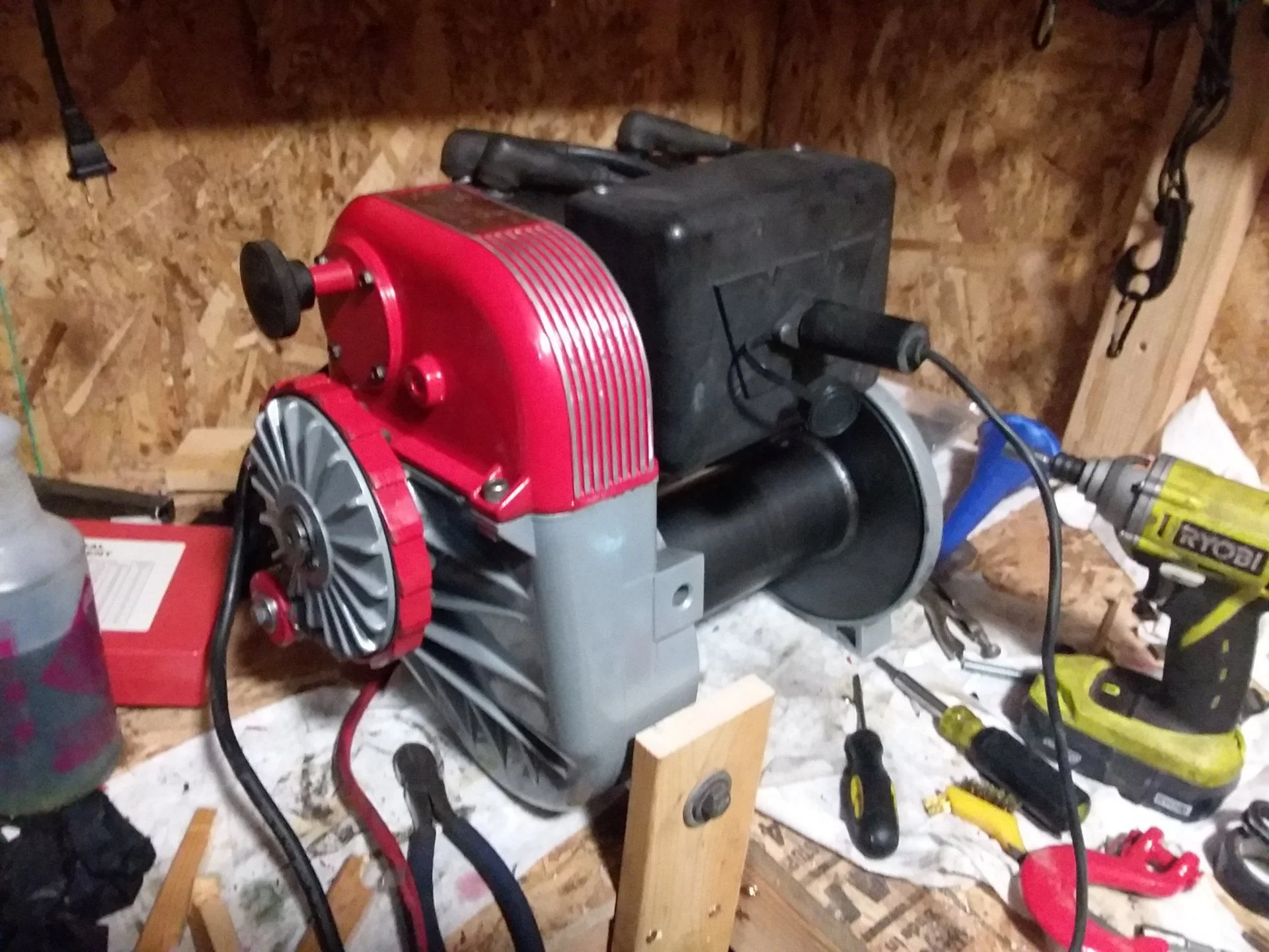

Just got my parts back from powder coating and reassembled the winch.
