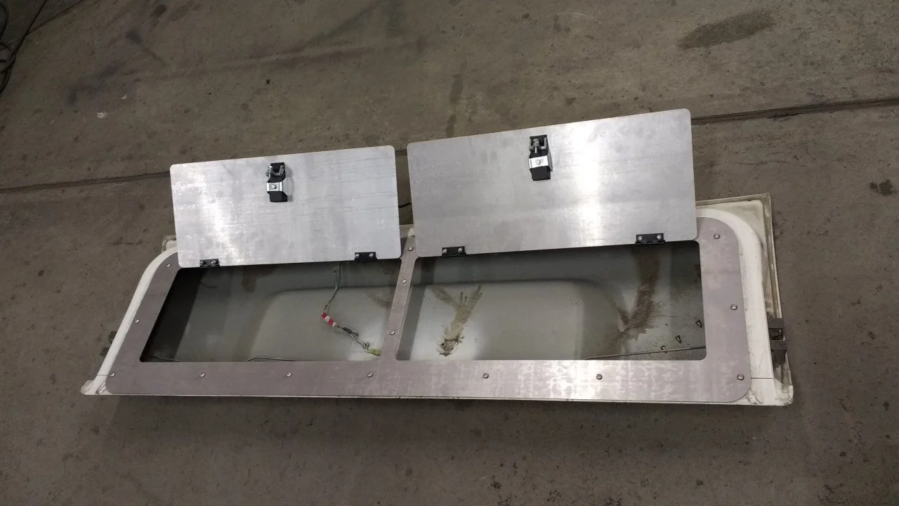

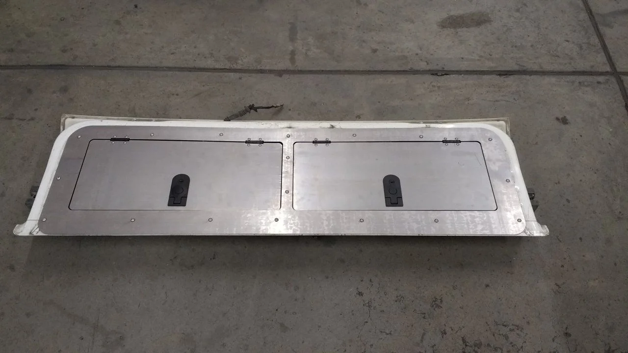

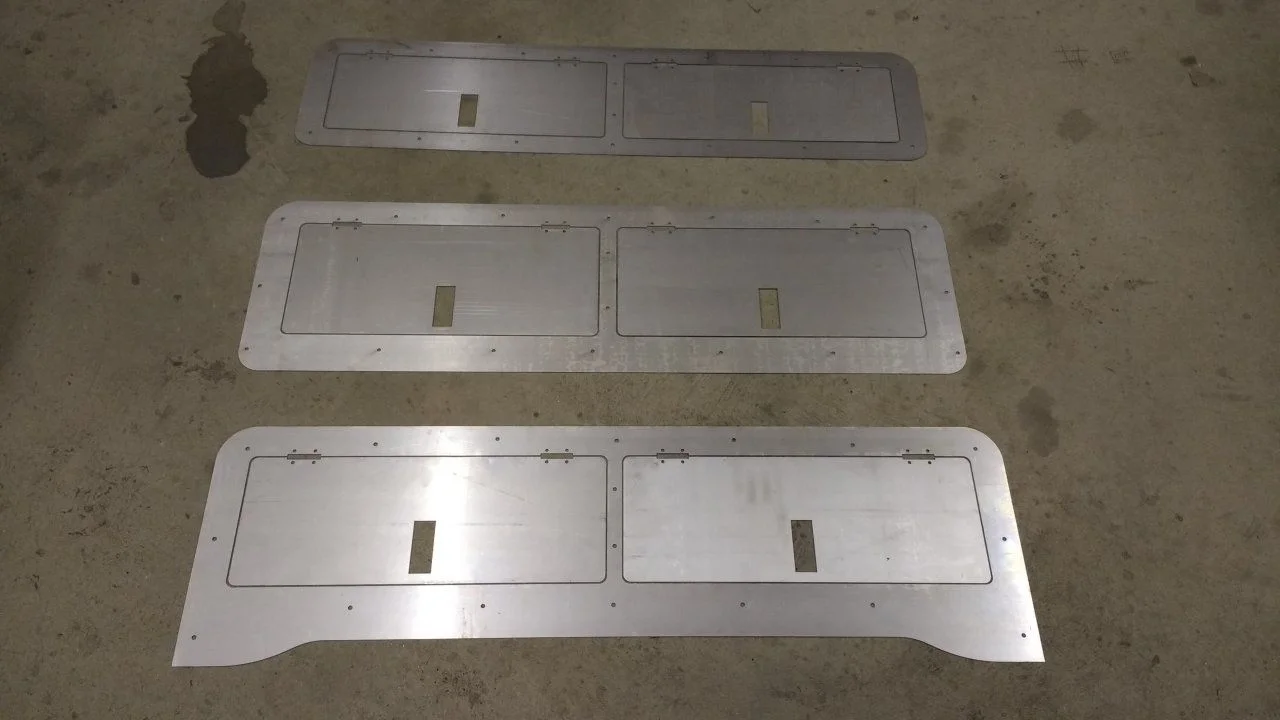

After many emails, PMs, texts, phone calls etc.. I decided to make these. One main reason is that I bought one for my wife's '97 and when it arrived it was twisted, bowed and NONE of the holes matched the tailgate. So instead of installing it and drilling 18 new holes..
I made some changes, added some things and made a dual door version.

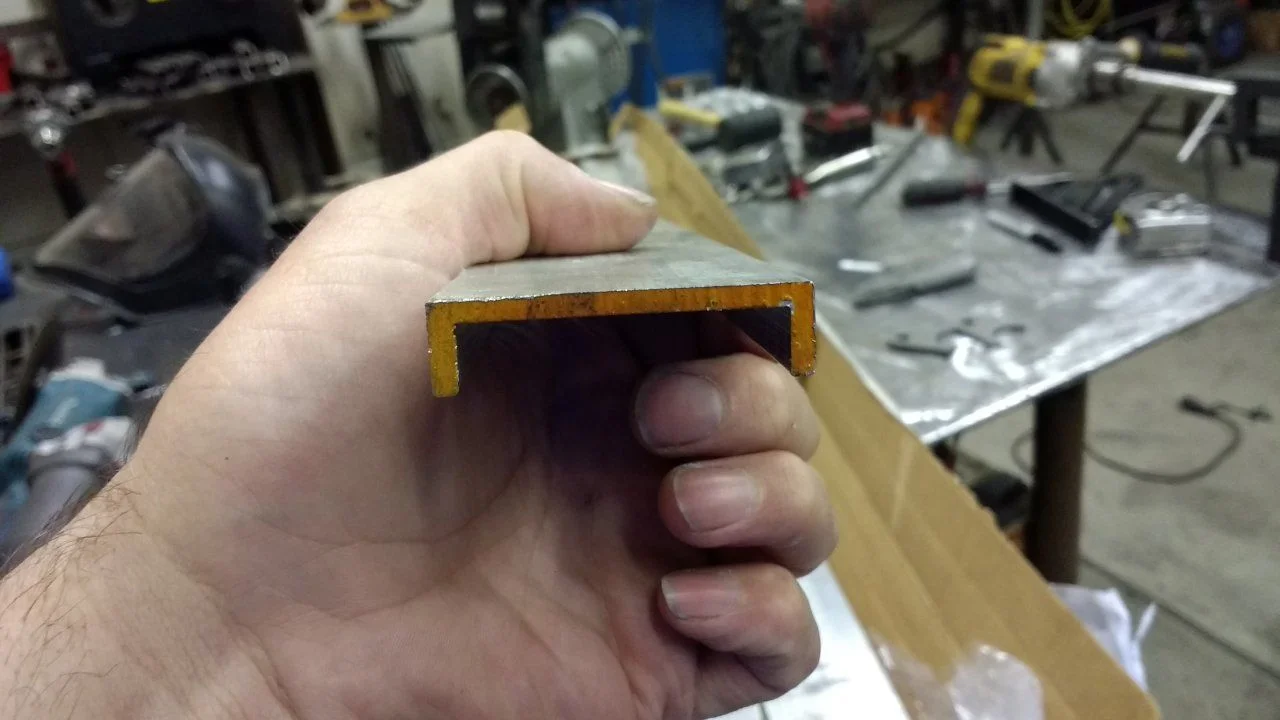

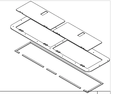

1/4" 6061 laser cut aluminum with Southco sealed locking latches and SS fasterners. All hardware, allen wrenches and anti-seize will be included in the kit. Doors are fully supported by an inner lip that is welded around the perimeter of the frame.
Bare metal is the only offering until I get moved to Spokane next spring and then I will offer these in powder, hard anodized and Plastisol polymer.
I have already accepted several 80 owners orders and offering these up in full now.
They will be ready in approx. 4.5 weeks.

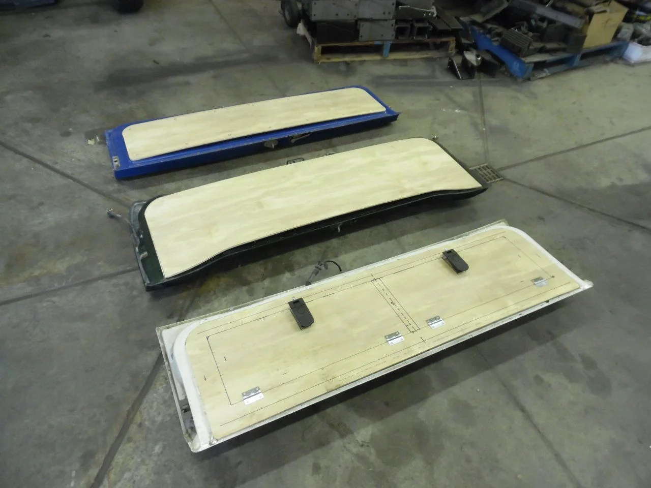

Wooden prototype

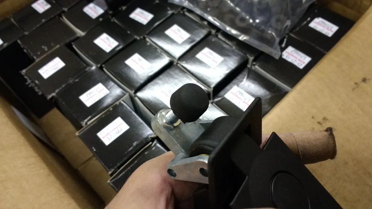

Southco locking latches

I got the door revisions back this afternoon. I said I was being picky about a few details on these.
One thing I requested was that the hinge be in the center of the door opening and that required the door and the frame to be notched equally. The second item was I wanted the door opening to frame distance at .080" around the perimeter.
This will:
A) look better than just cutting and shoving the door to the top or bottom
B) allow those that want to go with a thicker coating to be able to do so and their doors can close without damaging the coating. But still look good with a thinner coating.

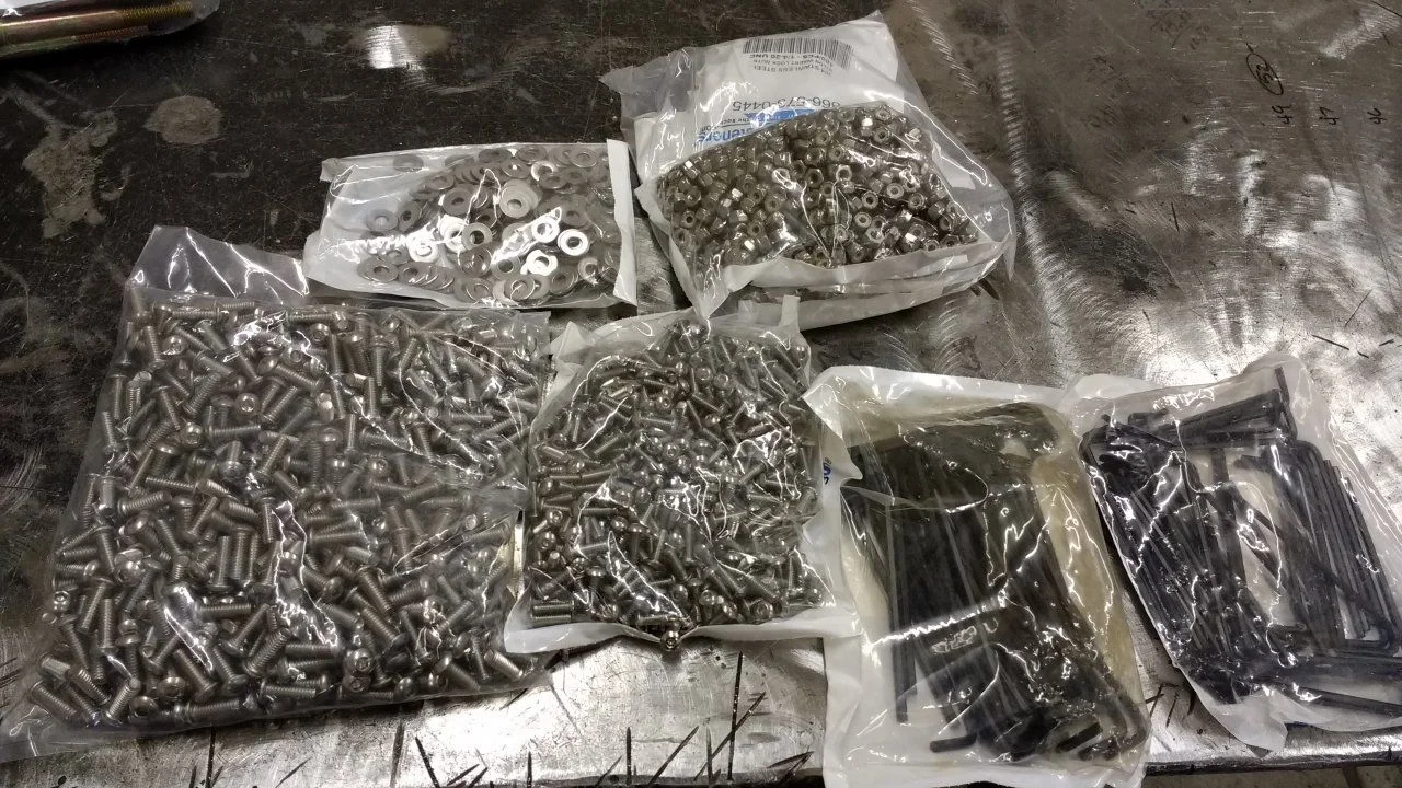

All the stainless fasteners and allen keys arrived today.
I reviewed a few more detail items with the cutters today. I hope by the end of next week I will have my final scans and the mock templates the week after and then these will get cut.
Amazing what 6100 small pieces looks like in bags.
