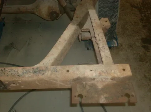

I haven't made them yet. IIRC I sold mine along with the rear crossmember of my frame. I may have pictures that I could use as a reference. It was just a angle bracket with two little lights.
Found some pics
you can see the stock license plate lights at far right - the plate shown is not using the bolt holes provided by Toyota - I think one was snapped off at the time
bare frame with harness
harness removed
side view
