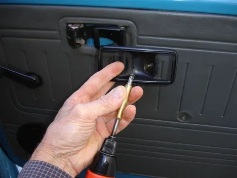

And this little clip will just drop out (and run away down a drain if you're unlucky).:
With the clip removed, the handle just lifts off.
With those three things removed, you can remove the entire "trim panel".

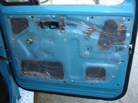

And here is the plastic sheeting that sits beneath the trim panel:
Without this, if you were driving along a side-slope in heavy rain - the water would drain down the window glass (window wound up of course) and drip on the inside of the trim panel (through the holes) making the trim board go rotten and fall to bits! ......Not good.
I cut that sheet myself (from the polythene sheeting sold in garden centres) and will be making up a nice clean replacement too. (Note the little flaps I melted onto the inside surface to direct the water back inside the door cavity.)
And here is the door with the plastic removed. (PS. I hold the plastic in place with bits of "Blue tack". I have found this works best after trying various alternatives. Because it stays soft rather that setting hard.)

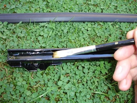

OK. Back to the passenger door from where I left off..... So it has had the rust holes repaired, and its been repainted except for the upper reaches of the door cavity (which are too difficult to access).
So I recoated those upper reaches with Fishoilene:
That brush has its tip bent to enable me to apply the stuff more thoroughly.

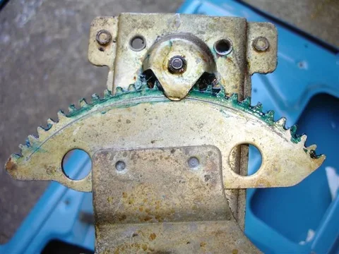

Next I refitted the window regulator (relubed with grease of course):

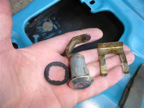

Then the "key tumbler" (where I reused the old 30-year-old gasket):

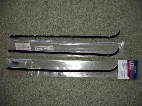

Next I fitted the "inner door belt".
In this next pic.... the top one is the "original", the middle one is an exact OEM replacement (from DentDepot/CruiserCorps), and the bottom one is an aftermarket item supplied by Rare Spares.
While I think the Rare Spares item is of acceptable quality for this application ... I went with the OEM item instead. (I ordered the OEM belt later when I found I HAD TO source OEM "Bailey Channel" and "outer belts".)
Now the "outer door belts" gave me real grief!
The top one in this next picture shows an "OEM outer belt" meant for "without vent-window doors" and it is suitable for either the driver or passenger door:
The middle one is the 30-year-old original and the lower one is the Rare Spares item. (Rare Spares reckon you can use their "inner belts" as "outer belts" too.)
Because these belts (for my doors) curl at one end only ... they become left and right-handed. (That is, one is meant for the passenger door while another is meant for the driver's door.)
Well there is no way I'd use the Rare Spares item as an "outer belt". It is too "flimsy" and I don't think the "felt material" is designed for such exposure to the weather.
Here's another view of the three together but this time showing the faces that mate to the painted panel surface:
This photo shows how really "lacking" the Rare Spares item is (in comparison to OEM).

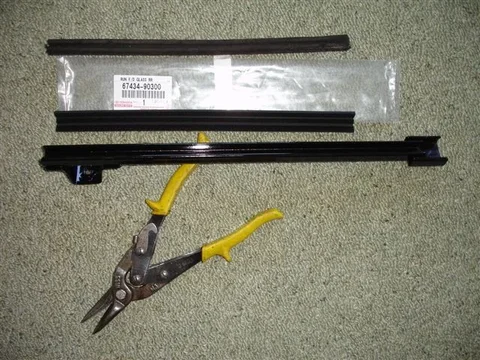

Next job was the "lower window run felt" (that the rear edge of the window winds down into).
While the original was really made of "felt" the new Toyota item is "flocked rubber" instead. (The orininal "real felt" is shown at the top.)
(Ignore the "tin snips" in the photo - I didn't cut anything here.)
It doesn't fill the entire channel (but "sits flush at the bottom" as I recall). Here's me applying the contact adhesive.

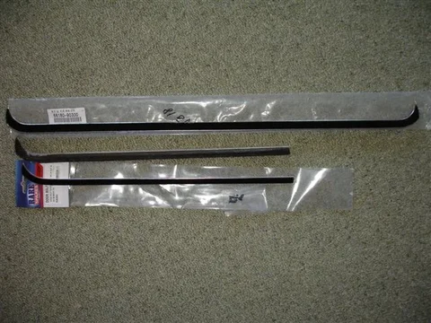

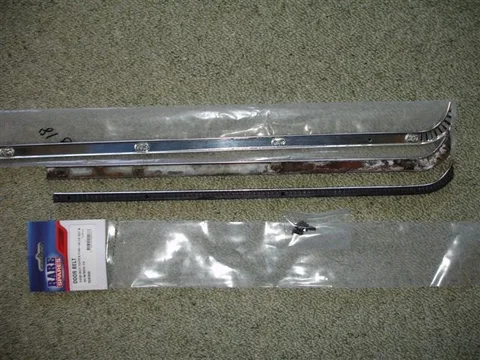

Anyway.... The next step was the L-shaped Bailey Channel.
I was thinking of using "flexible bailey channel" and actually bought 2 rolls of the stuff from Rare Spares. But then decided that there is no way that that stuff would look good .. or be able to reliably perform its duty. You need the chrome-beaded metal stuff!
Here's the unsuitable flexible stuff (flocked rubber):
And here is the old L-shaped channel (where the metal has mostly turned to rust) alongside the flexible stuff:
But once again - this "chrome-beaded channel" is "no longer available" for my doors. Hence, with the help of DentDepot/CruiserCorps, I decided to "cut-to-fit" the longer channel used on "without-vent-window doors".
Here's me marking where to cut:
