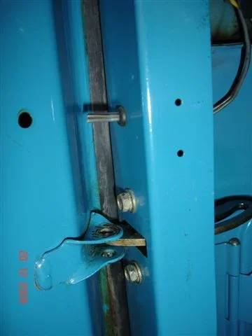

And here is that top hinge area after scraping away the old paint and apply new paint (POR15 primer + sky bue topcoat):
Oh how I envy you people with covered workplaces! Working outside all the time can be a pita. This is now all ready for the return of the refurbished door:

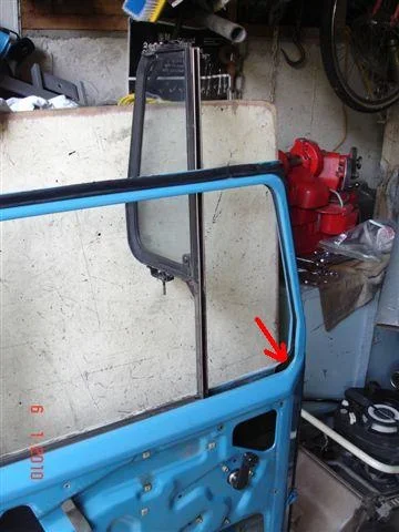

Of course the window-winder handle had to be removed and "trim panel" and the "plastic protector sheeting" beneath that etc. Then, to remove the "vent window assembly" ... you need to unbolt the bracket at the base of its "stalk". (The front edge of the window glass slides in the "bailey channel".)
You also need to remove two tiny screws (M4 as I recall) that secure the top of the "vent window assy" into the door.
Then comes the tricky bit.

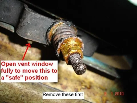

Best to remove the "washers, spring and nuts" off the vent window pivot otherwise they'll get in the way when you attempt to extract the assembly from the door:
Edit. It's also best to OPEN THE VENT WINDOW FULLY (open and turn it to its limit) before extracting this assembly. This is because there is a "cam-like tab" on the pivot shaft that will interfere-with/scratch your sill-paint in all other positions. (See "red arrow" above.)
The small arrows in this next pic show where those top M4 screws were.
To remove the "vent window assy" you need to first tilt it backwards as shown above.
Then I found the assembly could only be lifted out from the OUTSIDE as shown next.
And to remove the base of the "stalk" ... you have to move it over to the "wider opening" (arrowed) and turn the assembly as required so the bracket on the base of the stalk can pass through.

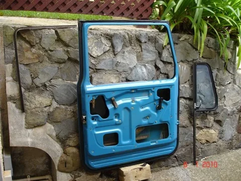

Here the passenger door with the L-shaped bailey channel removed. This particular piece of chrome-beaded channel is no longer available from Toyota. But never mind. You can cut-to-fit the stuff made for "without-vent-window doors".
In the above pic, you can also see the vent-window-assy on the right.
At this stage the main window glass can simply be lifted out.

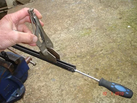

The frame of the "vent window assembly" was to be cleaned to bare metal and repainted. (Black POR15 and black gloss topcoat)

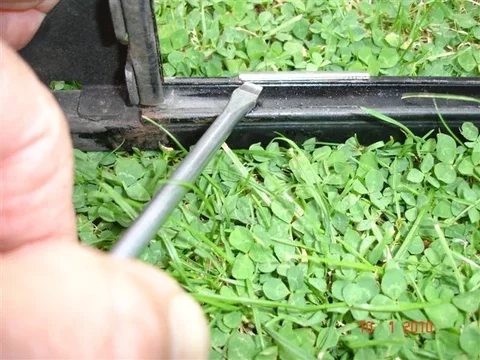

So here is the removal of the "chrome-beaded bailey channel" from it:

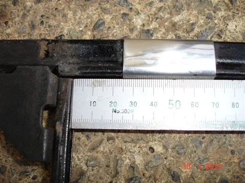

Then I needed to take a measurement to ensure I replace this plate in the original position:
Then "flick the plate off" so:

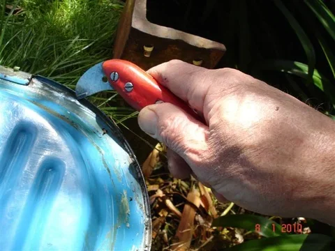

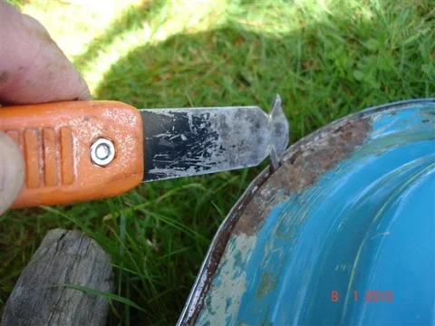

Removal of the main weatherseal:
Oh .... So you're wondering why I'm refurbishing these doors when they look to be in such good shape? Well the metal in that L-shaped bailey channel back in post #5 has mostly turned to rust and the channel is only in one piece because of the extreme care I took with its removal. (One knock and it would disintegrate!) And this photo here shows some nasty rust beneath the main seal:
Here is the old weatherseal removed. You can see that it isn't in great shape either (mainly because the slow seepage of my fishoilene rust-preventative from the drain holes in the base of the door has been attacking the rubber):

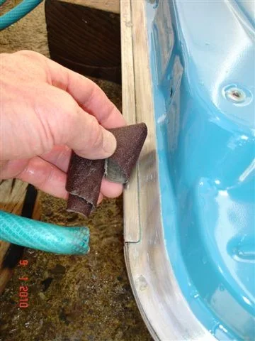

Very important I reckon to get rid of all the rust and dirt from the area where the weatherseal sits and from around the drain holes:
Preparation for painting
Weatherseal area:

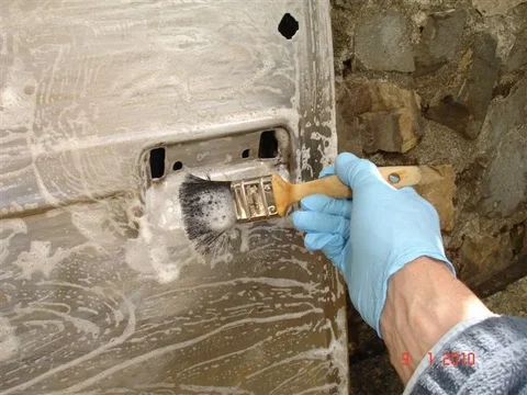

Cleaning/degreasing with POR15 Marine Clean:

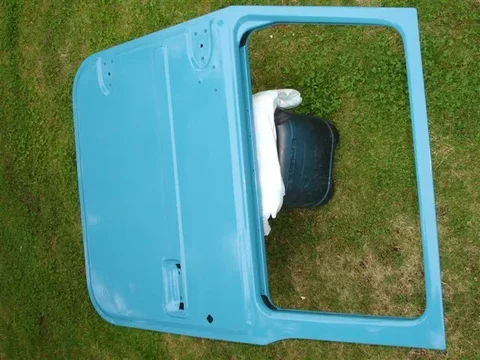

Now for the outside. As you can see ... I like to brush-on the POR15. The reason for this is
  • I don't like to waste it. (It's darned expensive!)
  • I get a good thick coat everywhere I want by this method
  • It has a tremendous "self-leveling properties" so it doesn't tend to leave brush marks
It's blowing a gale and drizzling outside .... which is why I'm posting this thread now (instead of working on the driver's door).
I've got to have lunch and shoot of to work in a minute so this'll be the last post for today I imagine.

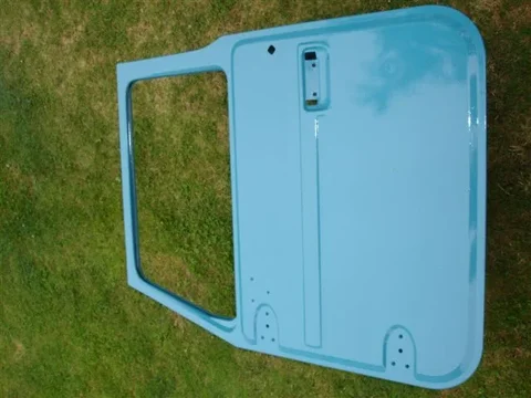

Here some pics of the topcoat on the outside:
