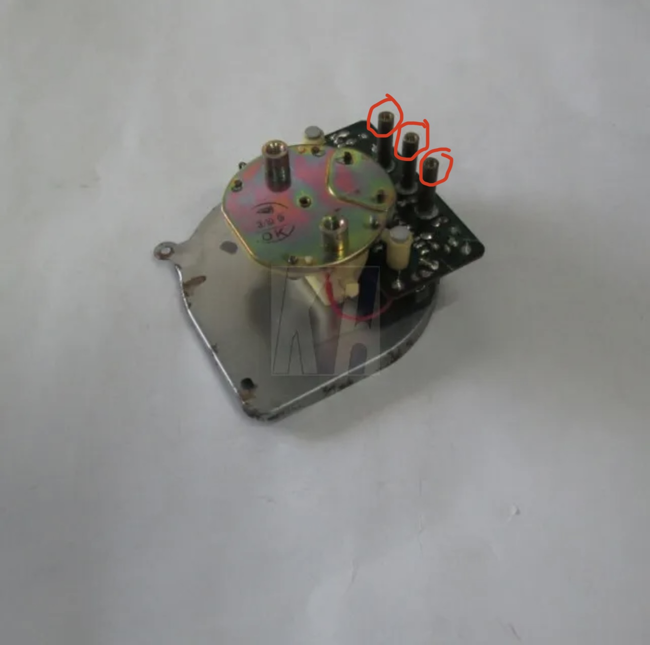

Now I just got a HJ75 Ute with the 2H and the tacho was a aftermarket thing that is just terrible. I’ve got an original replacement but don’t know what wires go where. It has the 3 copper screw holes for the wires. I have a brown, a blue, and a black wire. Can someone please shoot some advice my way or a diagram on what coloured wires go where and how they’re fitted? I’m sure it’s simple but would rather be 100% sure before messing with anything.

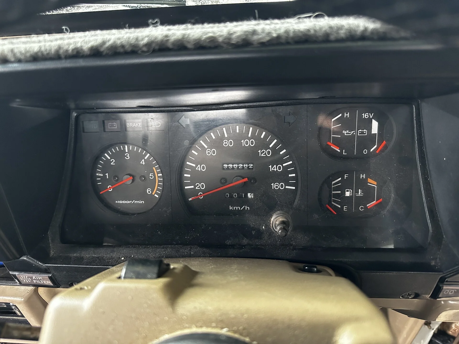

Could you post a few photos of what you currently have as well as your current cluster and the new tach you have?

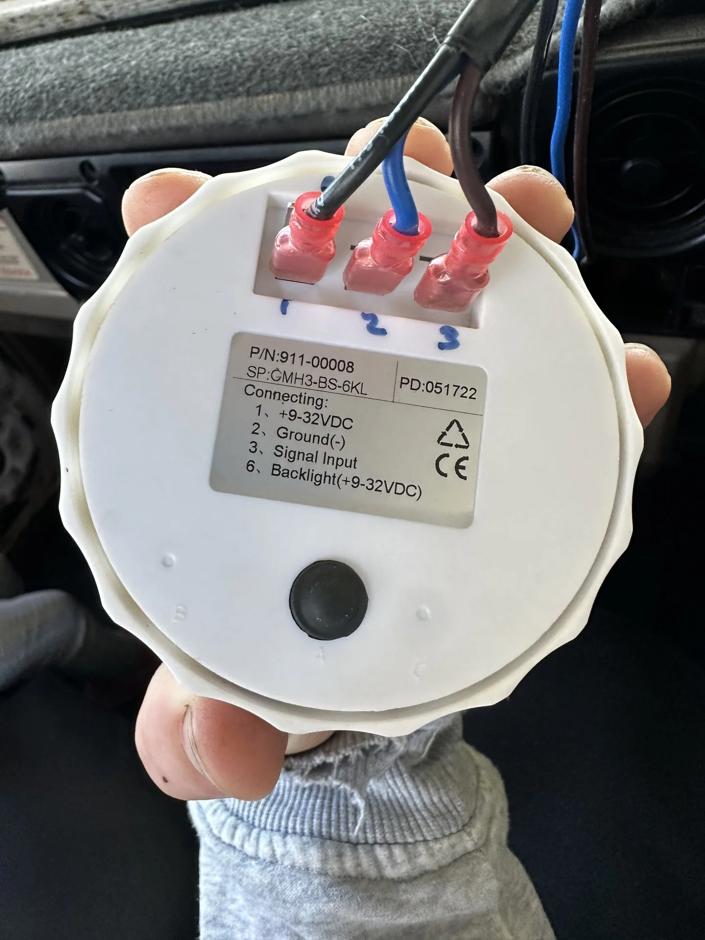

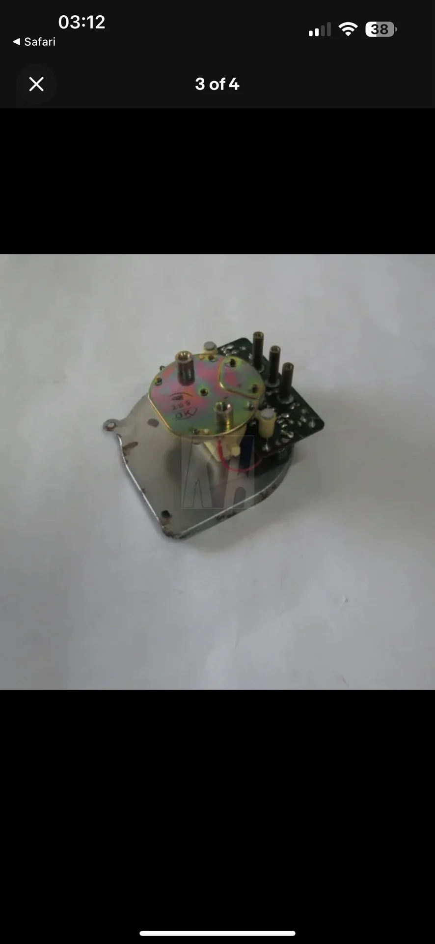

The photo with the red terminals is the one it currently has in it now, the aftermarket one, and it doesn’t fit. I have an original replacement identical to the first picture.

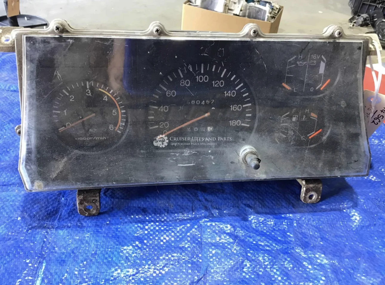

Is that your current cluster? Or what is actually in the car now? That cluster is a photo from the junkyard.

Apologies, the photos were just for reference but I will upload some now.
In the picture I added where I have circled the terminals I’m basically wondering what wires go to what terminals?
*The wires I’m referencing are the black, blue, brown wires plugged into aftermarket tachometer in the above photos.
You're going to need to remove the cluster and see what is wired into it. I would also recommend getting a wiring diagram (under the RESOURCES tab above or via the CRUISER CULT website). That will show you which wires do what behind the cluster.
Strange that they installed an aftermarket tach. They had a reason for doing that. Either their tach broke, and they couldn't fix it, or they somehow thought it would be an upgrade to factory.
