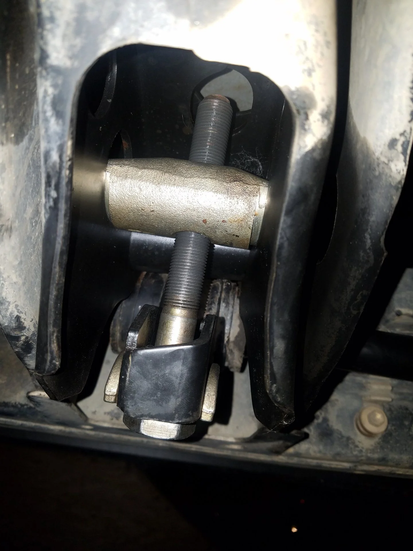

I decided to "experiment", and installed the SAW TB's on my LX. Yeah, they're waaaaay bigger than the OEM TB's but figured WTF, I'll see what happens. I originally did a 0 index, but required way too much from the adjusting bolt, maxing it out. I then tried the marks SAW put on the tb, -1 spline. I think I'm indexed about 3 splines. Sweet spot! Still plenty of adjustment, and AHC showed a 7.1 on techstream.

So far it's working with a 3 spline index. I still have plenty of adjustment on the 30mm bolt in both directions. With these 295/70/18's, i was still getting a little rub while on the brakes in a turn. Gone with the SAW tb's. Oh yeah, I'm 21 1/2" center of hub to fender and my front caster is 3.4*.

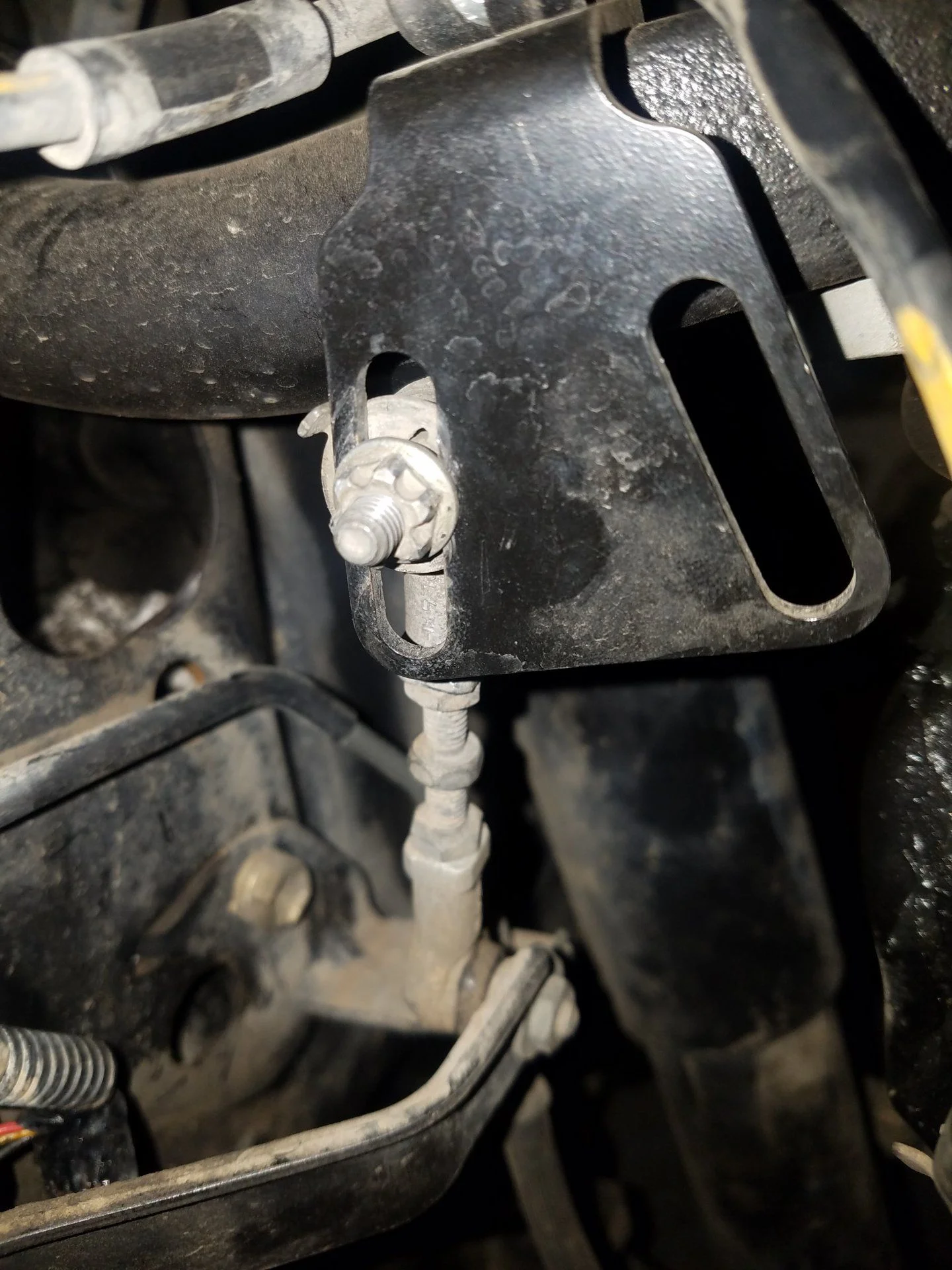

To achieve that 21.5 front height did you cut the bolt on the AHC front height sensor or just slide it to the top?
I was hoping they were, but they're not. They're black. I'll go take a pic. Stand by.[/QUOTE
Attempted to take some pics, but they sucked.
On the OEM UCA'S, I slid it to the top. On the SPC UCA'S, I'm about center of the slide to get the same 21 1/2".

I have about 500mi on them now and the ride is fantastic! Ive been keeping the AHC ride selector
switch on the "big dot", and it's perfect for all around driving. Its sporty feeling yet soaks up rough road, and not harsh. Suspension still cycles through available travel, too. I haven't touched the torsion adjuster bolt since I installed the bars.
I'm really happy with this setup, and would recommend anyone with a built up LX to consider experimenting with bigger t-bars. I happened to use SwayAway, and it worked out great. Maybe other brands will work with backing off the spline indexing, but I dont know. I imagine they would.
