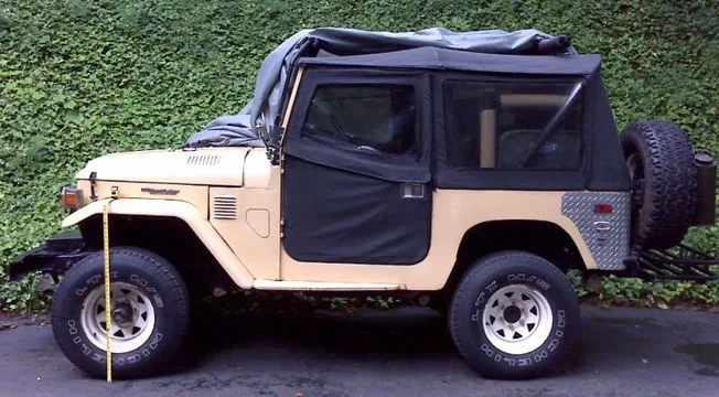

I have a 82 FJ40 that is primarily used to drive on the sand for surfing. I live about 2 hours from the beach and really dont take the vehicle off road other than sand. I have an SLC soft top/doors and dont plan on putting the hard top on at all. Overall, Im just looking for a nice ride for the 2 hours (4 total) that I have to spend on the road. I know its not a BMW but it really shouldnt be that difficult/tiring to drive as it is now.
The vehicle came with an aftermarket shackle reversal kit with springs (4 inch lift). I removed the kit and put on a SOR 2.5 inch lift kit thinking it would improve the handling and lower the vehicle. The handling did improve but I believe that was mostly due to the fact that my existing bushings were shot. Overall, the ride did not improve. Oddly, the vehicle still appears to have a 4inch lift. I know that sounds odd but looking at all the pictures here and elsewhere it really stands tall. I dont care for a lift at all since I have to now climb all over the vehicle to put the surf boards on top. I would also like to get smaller tires but since its so tall that would just look silly.
I have spoken to SOR that have not offered too much assistance. They indicated that springs have to break in, give them some time. (Its been a year now and I know they arent going to soften THAT much)
They have mentioned that I have a soft top and that is making the vehicle ride stiff. (that may be true but I have loaded up the vehicle enough to match that wieght and no change in ride) The last thing they said was to spray wd40 on the springs. (I did that just as a joke, yeah, nothing changed)
So, in retrospect I think I just didnt do the research ahead of time and simply bought the wrong spring set for my ride. I dont blame SOR for this, just myself. (1000$ mistake...ouch!) :whoops:
So, I cant stand it anymore, I need a softer, more comfortable ride that doesnt give me a 4inch lift. It doesnt appear that no lift is possible for aftermarket kits. Rats.
I called CCOT and MAF and spoke to them about springs. MAF definitely offered the most help and tried to explain everything to me clearly. The guy mentioned to get either the OME dakkar springs or the Safari springs. For my application he thought the safari springs (light gauge) with OME shocks would be the best setup. 1.5 lift in the front. 2.25 in the back.
Before I go out and buy anything I would like some suggestions. I really only want to do this one more time. Again, getting the softest most comfortable ride possible. Thanks in advance everyone. This forum is really a great resource for finding information on FJ40s and others.
(Note: I know that the springs arent the only factor in a smooth ride. Center arm, steering stabalizer, etc... Those items have been serviced/replaced.)
