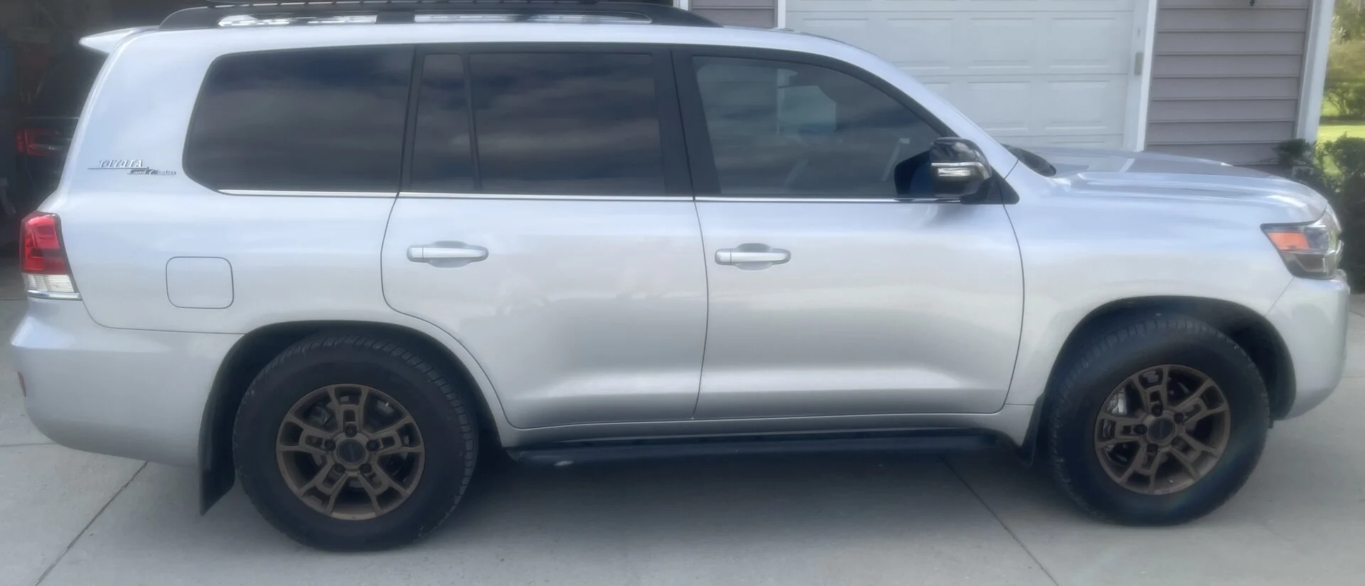

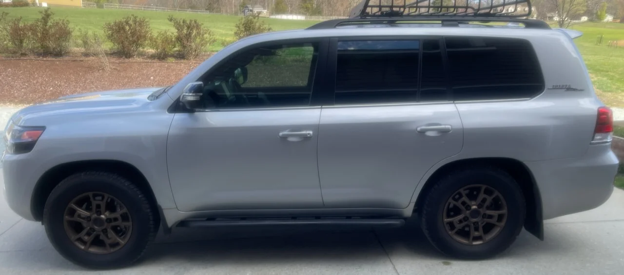

My question for the mud hive mind is this: I like the OEM ride, and would rather not have to rebuild shocks every 20-50k, etc. Is there a suspension setup with springs, etc that would lend itself to working well with both the 400# immediate weight gain AND the future bumper/swing out? I have pics to follow to show current sag with OEM suspension and soon to be daily weight.

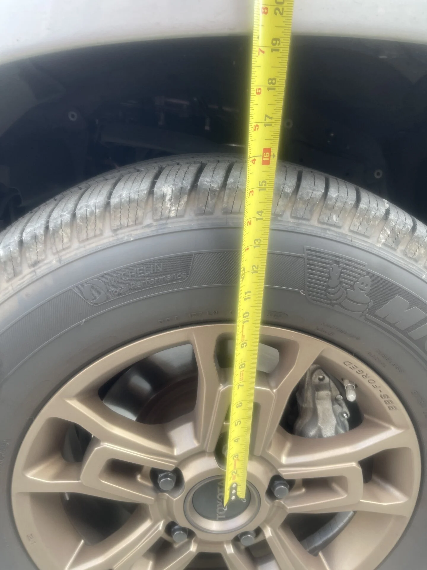

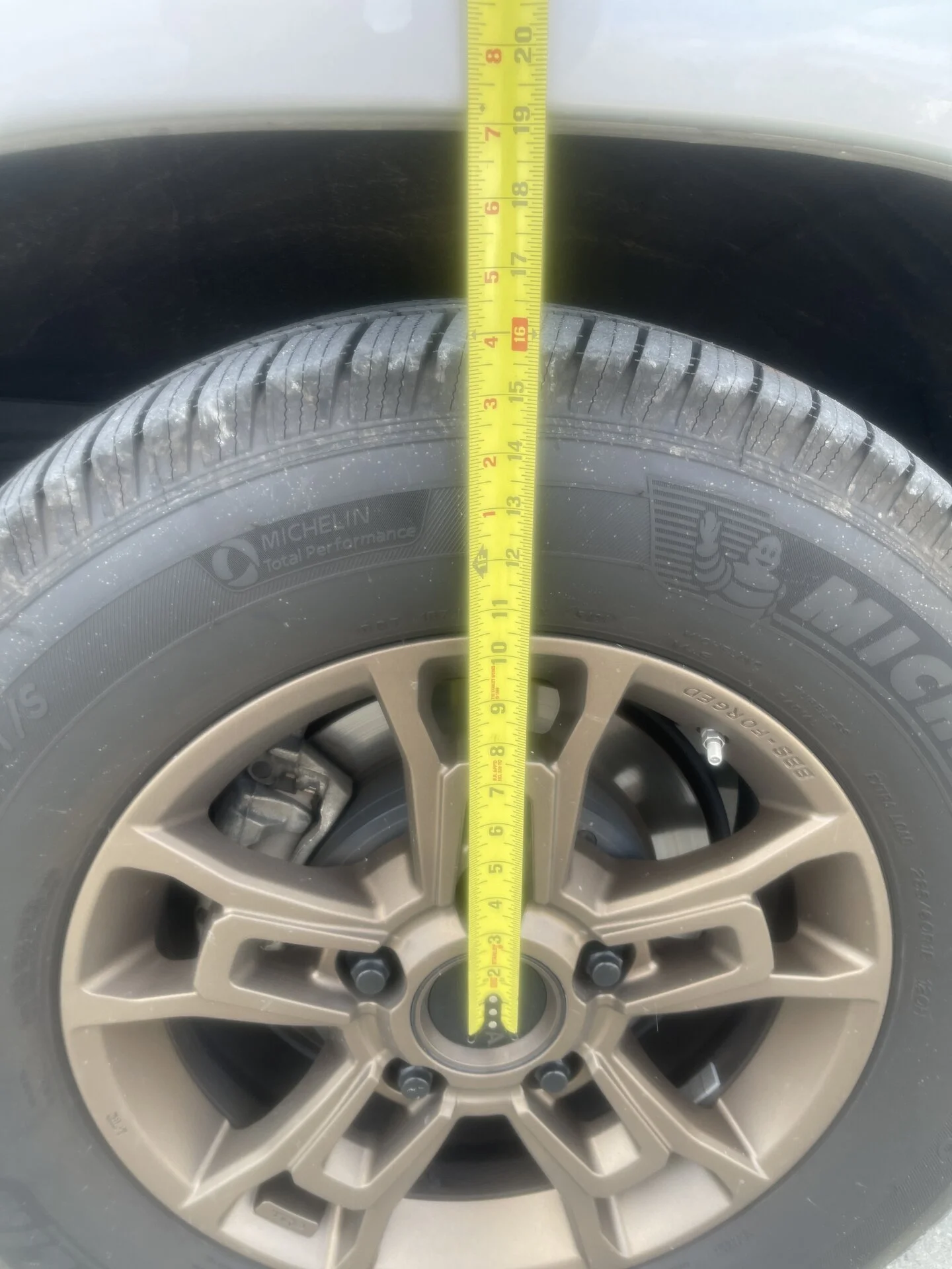

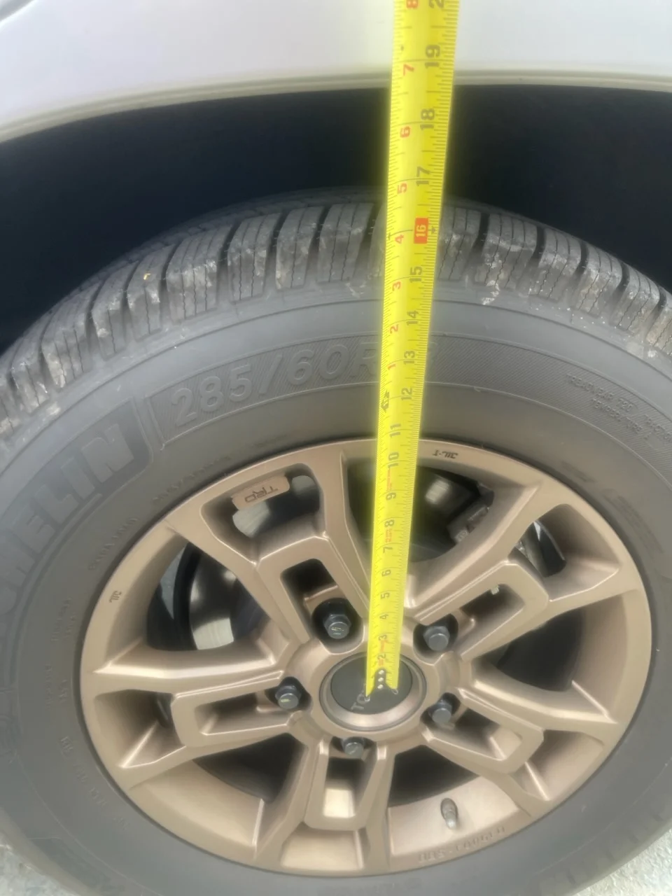

pax front/rear from hubs with load. Sorry for redundancy.
driver rear. sorry for formatting. uploading pics/editing on desktop not playing nicely for a tech neophyte.
