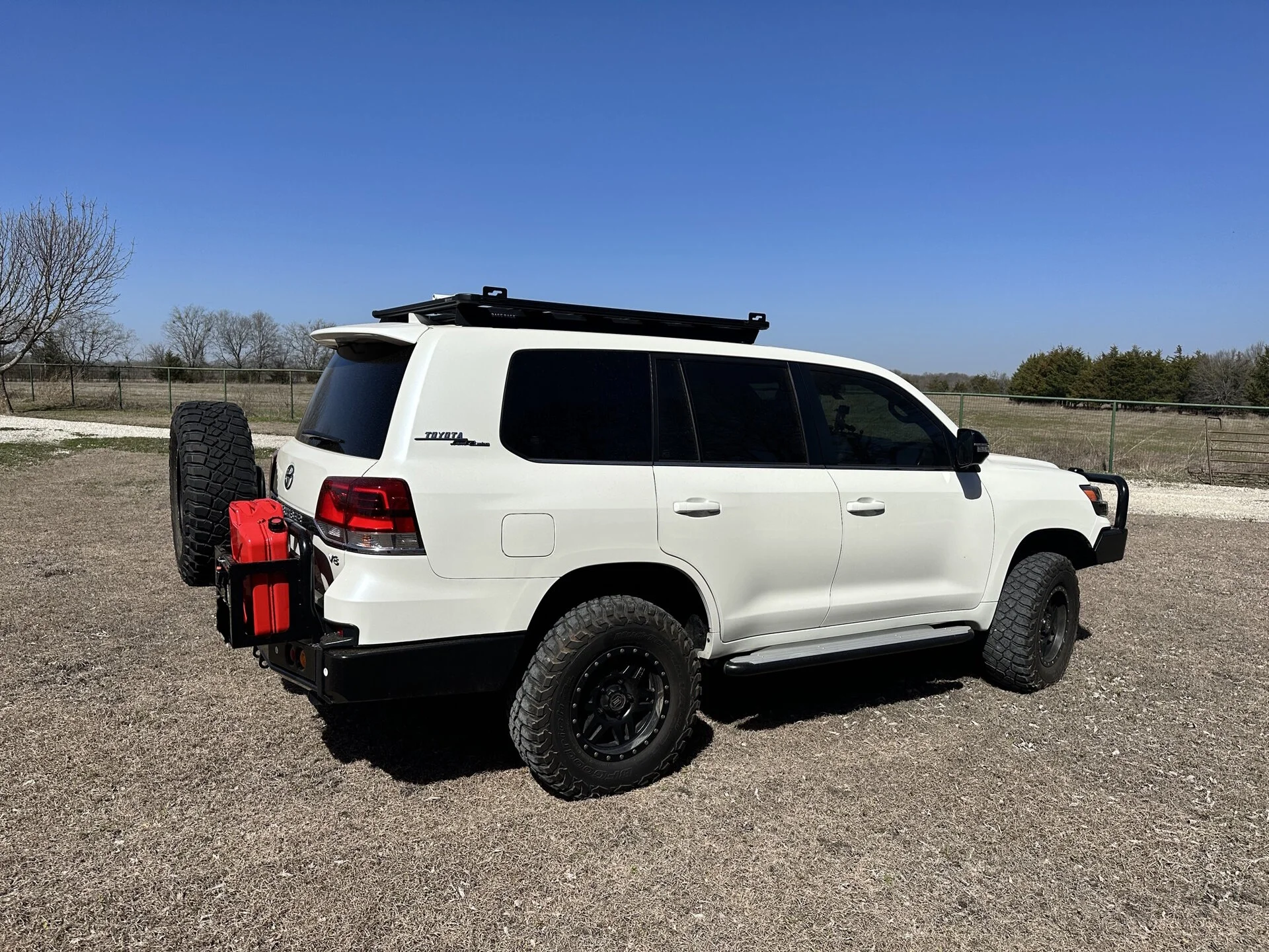

I have a ‘21 LC200 series with ARB front and rear bumpers, full steel skids, and a drawer system. I wanted to see what options are out there for upgrading the rear coil springs. I am located in the US so it must be companies that are based or ship to US.

Have pretty much the same setup, on a 21LC200/HE. I have Icon suspension too, when I loaded the drawers, added F/S tire, it sagged back down to stock. I installed Dobinsons coils (C59-545) and it solved problem.
