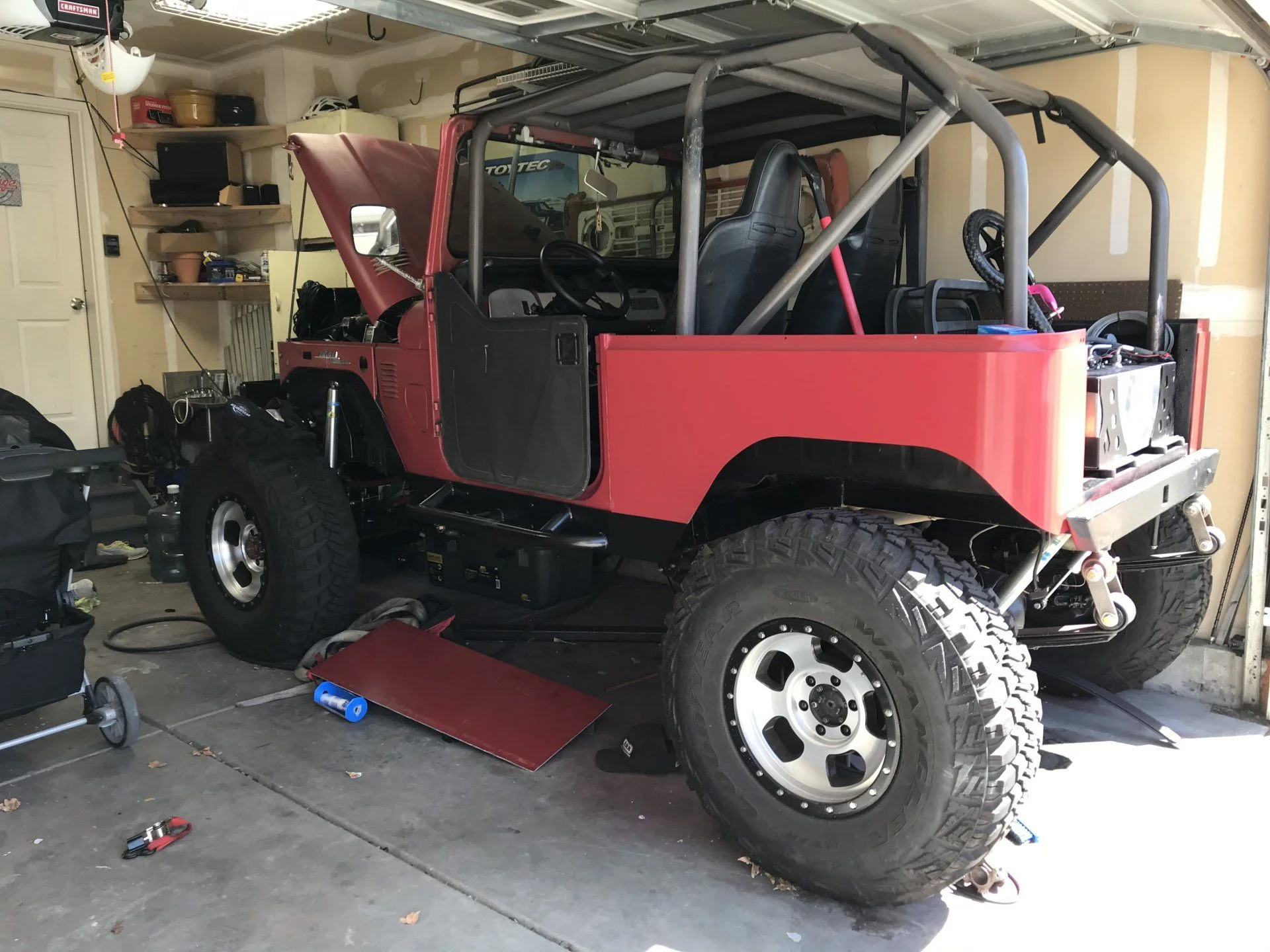

37’s in the stock rear wheel location will be tight and most likely limit up travel. I pushed my boy’s back about 3-4” with fj55 springs and kept the original contour of the opening while enlarging it up and back, which to me is just as aesthetically pleasing. I’m not a fan of the “comp cut,” where it’s opened to the back of the tub. But again, that’s my subjective opinion.
You don’t have to comp cut for a stretch. Sitting at 105”. Plans for links down the road.. but kept Leaf springs for now. Fzj80 rear. Widened fj60 front. 4.5” backspacing on wheels
When I originally moved my rear axle back, I moved the stock rear curve of the fender back the same amount as my axle. It kept more of the original fender look. I was unhappy with the front portion of the fender, so I ended up moving the front portion of the curve back as well. Similar to what @74fj40 did above.
