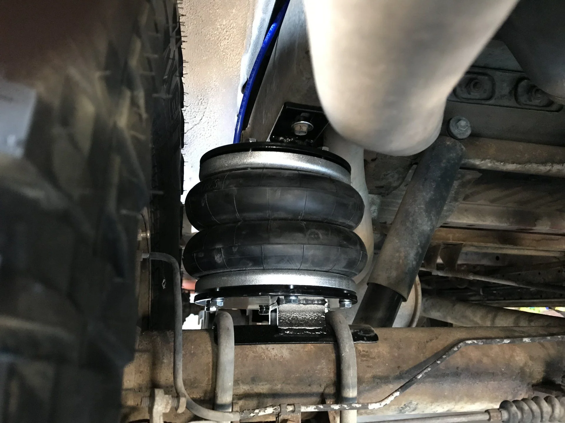

Boss airbags are a great choice. I have them on my stock height, stock leaf sprung FJ60. Quality is REALLY good. I use them to get rid of the saggy booty on my truck due to the stock springs. They ride a bit (ok, pretty rough) for me since I have to keep a decent amount of air in them to keep my truck level. When it’s loaded, it rides AMAZING. So for you, it would be perfect. Pump them up when you have a heavy load, deflate them when unloaded.

That looks kind of interesting. No drilling, right? What kit did you buy and where did you buy it? None of the websites seem to list one for a FJ60...
Nope, 100% bolt in. They mount in the factory bump stop location and then go under your leaf spring u-bolts.
It looks like you’ll want the LA-01 kit. I just checked my receipt and could’ve sworn that’s the kit I ordered, but I received and installed the LA-09.

I got mine on eBay. It looks like they’ve gone up in price, mine were $299/free shipping and came from Canada. They’re made in Australia though.
