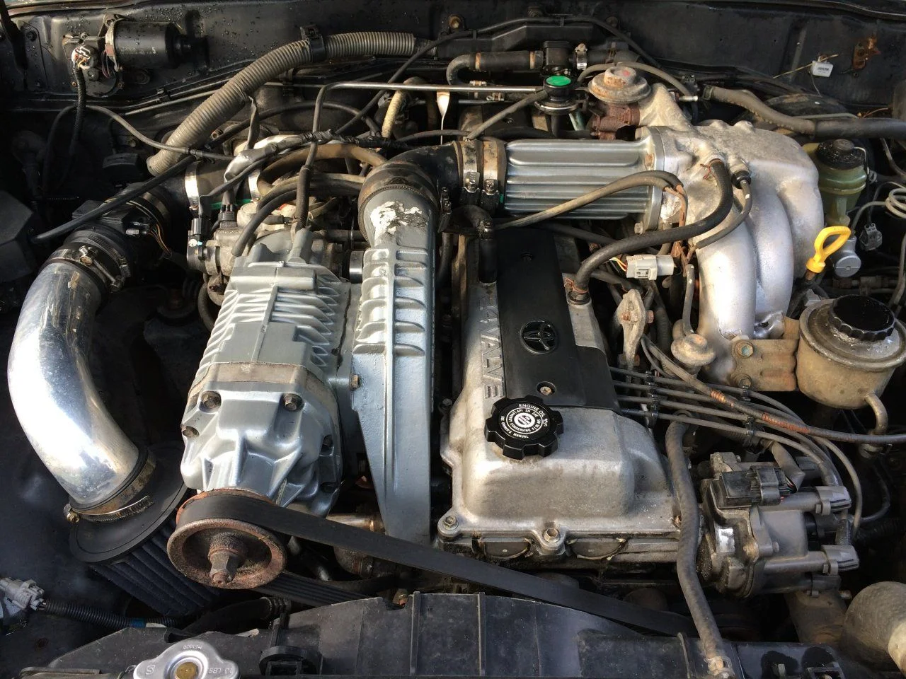

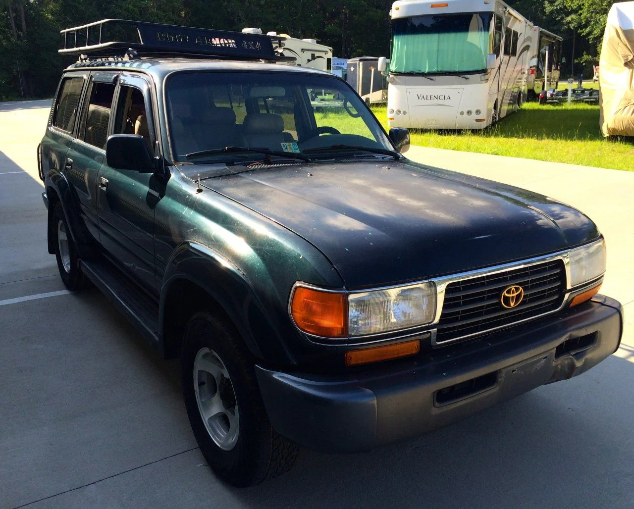

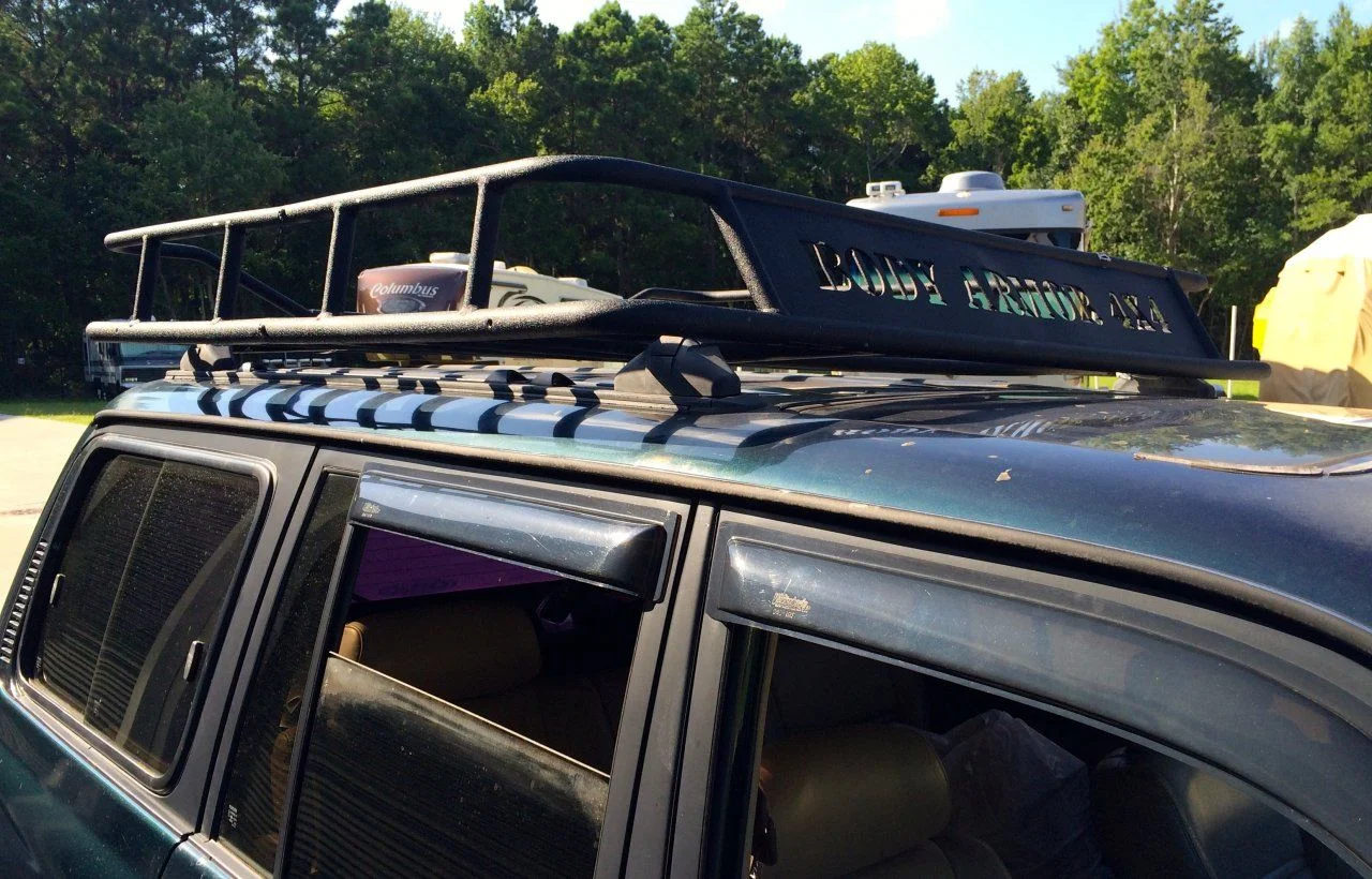

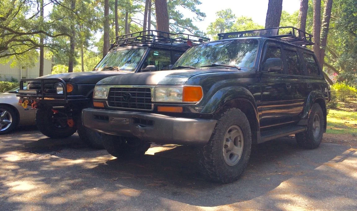

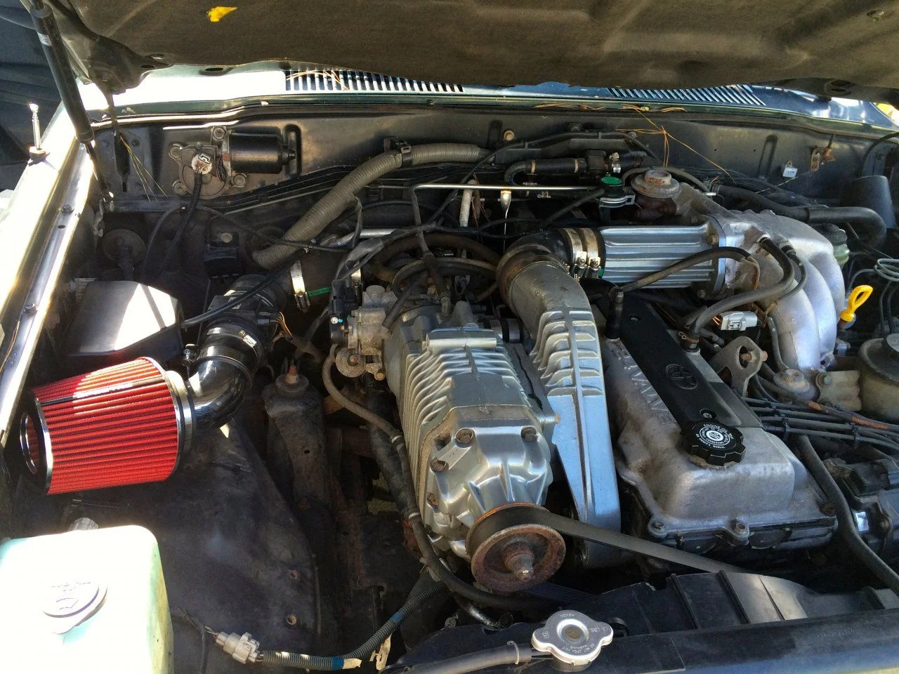

So within the first Day of owning it, Ive already started work. Ive washed it, and degreased/washed the engine bay and undercarriage. The truck does have some surface rust, but is solid overall. The "Cold Air Intake" installed by the previous owner drew air directly from near the headers. I don't have a factory air box so I bought a new filter and re-routed the intake closer to the fender well... Also I had a roof rack from a Jeep Wrangler in storage. Using Steel hose clamps (I know....) it is now perched atop the Cruiser. I made sure that it is very sturdy, might be a temporary add-on. Next up will be exhaust and tires

You can probably pick up a used stock air box for pretty cheap in the part out section. They're massive. I wouldn't be surprised if it moves air better than what you have.
I'd add spend a little time on the cooling system first since you have a supercharger and plan to tow. A coolant flush and upgrading the fan clutch oil to a higher viscosity are pretty cheap and will be time well spent. Do the PHH while you have the coolant drained.
I'll look around for a cheap stick airbox. I already had the filter and just did that because I was itching to do something. I'll put the cooling system on the to-do list, would you mind if I messaged you sometime for pointers? Still very unfamiliar with the FJ80 engine bay.

I've got a stock airbox. Not sure if you want to pay shipping cross country, but as long as you don't mind waiting around for my lazy ass, I'd be happy to ship it to you for postage plus a little beer money :)

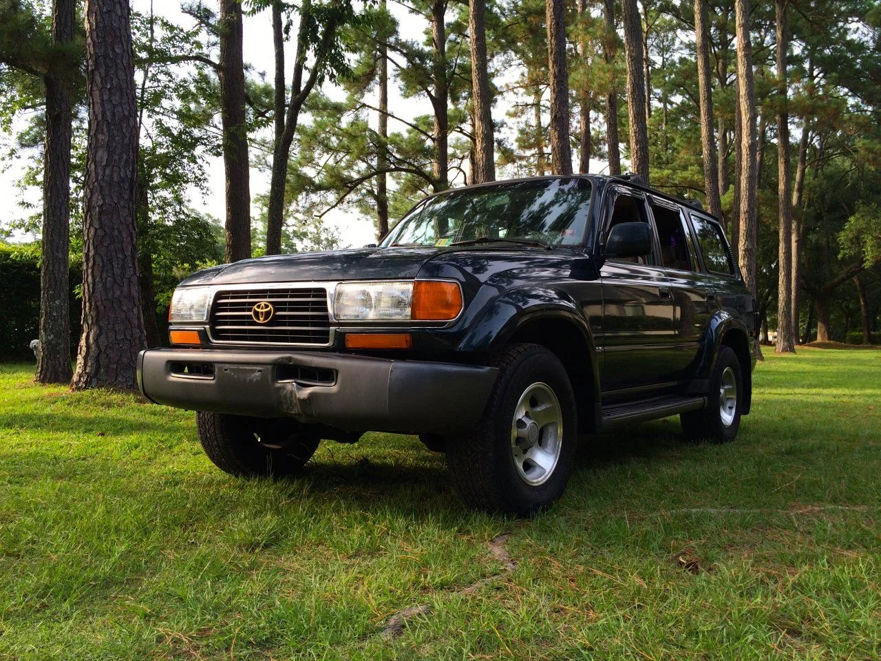

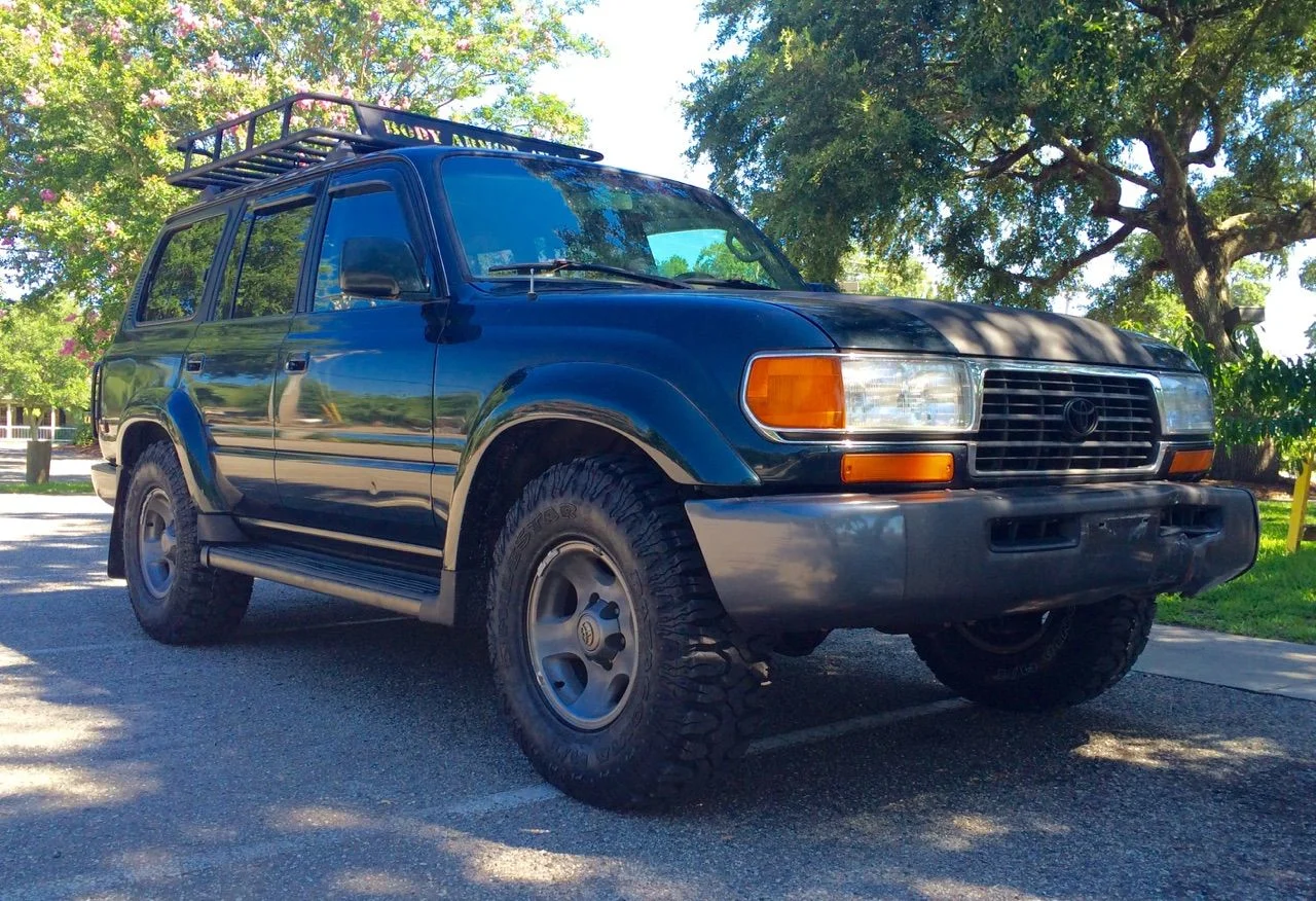

So I've done a few small things to the FJ80, blacked out the badges and painted the middle of the hood black. Also painted the wheels gunmetal gray since they were in rough shape. On Thursday the truck will get weathertech floor liners and 285/75/16 MTs. Pics will be posted.

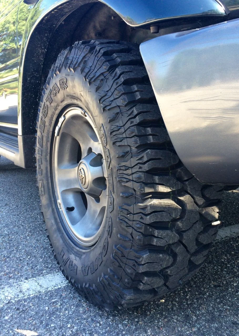

So big day today, got the 285/75/16s mounted... they drive great with zero rubbing (daily driving). Truck hesitates a little bit down the road, but all in all I am happy! The tires are Milestar Patagonia MTs. Got all four for $600 off of ebay!
