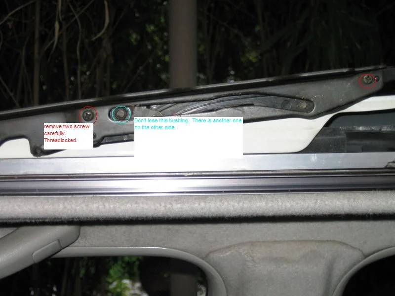

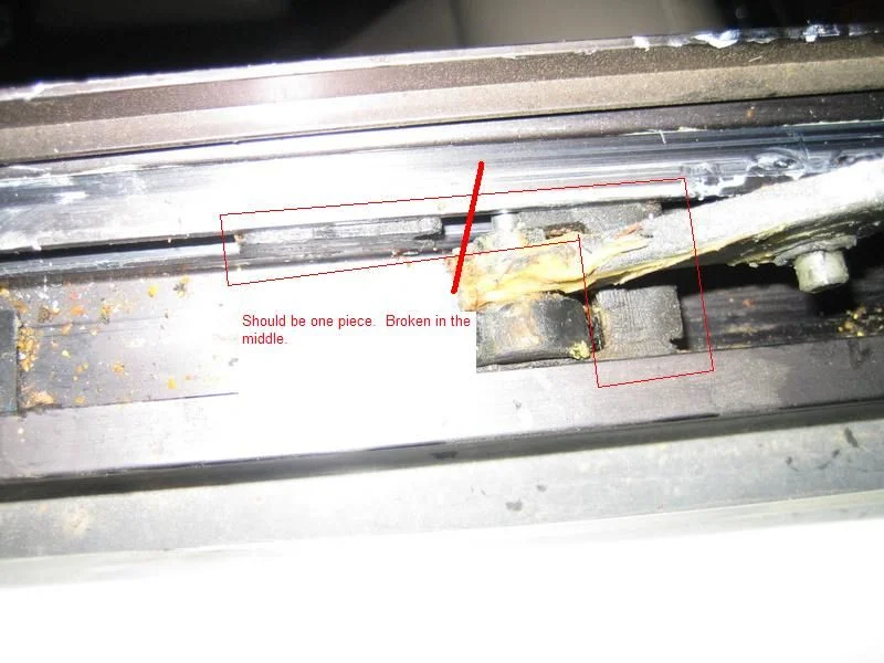

Ok, so I had some time this afternoon and took another look at this one. I have identified the problem, now just to fix the problem...somehow. Any idea?
1. First, remove trim (carefully, as one of mine blew up, other removed more carefully) and glass. Tilt up sunroof.
2. Remove two screws highlighted in picture. Be very careful, as they are threadlocked and not much to push against.
3. Detach outer metal piece, being very careful not to lose the two plastic pieces that ride in the grooves in the metal pieces.
4. You can now rotate the piece to the front of the vehicle, and expose the broken piece that is attached to the cable. Shown in the other picture.
Any ideas as to a fix??? I do not see a way to easily fix, without total removal of the whole system.

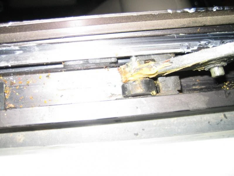

Here is a clarified version of the picture. The front portion is attached to the cable. The sun roof will open, but will not close or tilt up at all since nothing is pulling it forward.
Since it will be full-blown winter here soon, I wonder if anyone sees a way to just seal it back in it's most forward position, and just wait 'till the next thaw'.
Any thoughts?

On the driver's side, the cable does not pull the glass forward or up. It will still retract. Closing or tilting up is just the other side doing the work, putting strain on everything. See pic in #14 for your probable problem.
