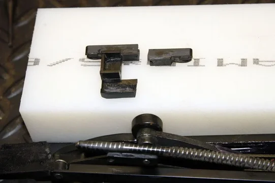

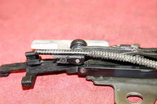

I fixed my cable instead of paying $400 for a new rail & cable assembly. I bought a piece of nylon (good tensile strength & low friction) and made a replacement track carrier using what was left of the broken cable.
Hope to get another 15 years out of it.
Picts show the homemade replacement track carrier piece using the small plastic left on the cable. I took additional pictures and wrote down the steps in case I have to do it again and can post details if anyone is interested.
Broken piece on top of nylon

Homemade replacement

Works great and still going strong. I use the 'tilt' opening all the time. However, I do not usually open fully using the 'slide' because the wear on the metal track does put a fair amount of load on the cable and is what caused it to break in the first place. Adding lube will help, but the tracks just wear out and cause the cable to break :crybaby:
The repair is a one-off based on what I had left at the end of the cable. You really need to custom fab something based on where/how your cable broke . Nylon is a pain to work with. It forms these long stringy fibers when cut. Just use ABS or PVC.
