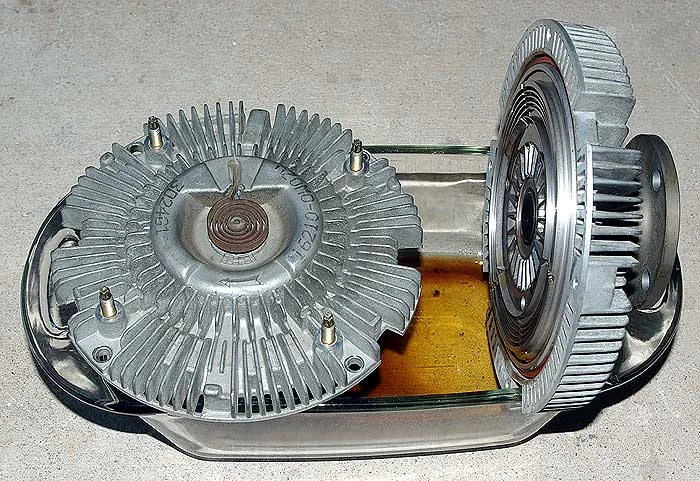

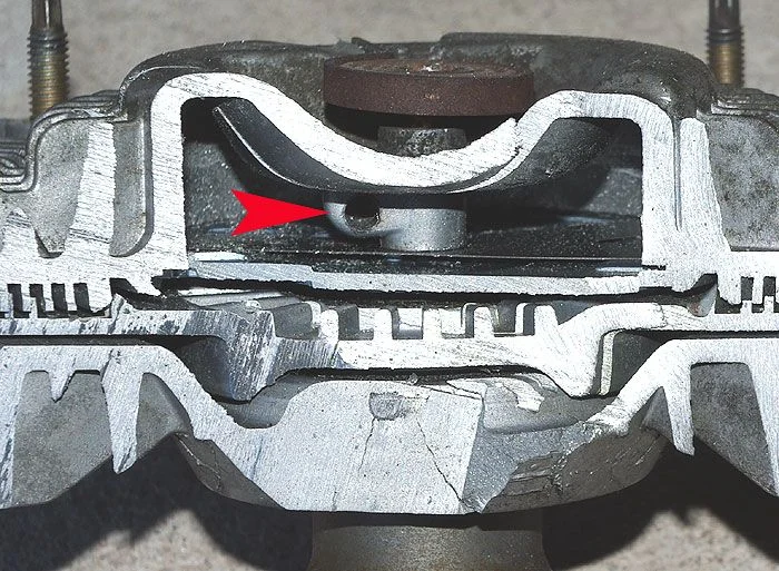

:whoops: Damn it man!:o Further review shows that the above draining method in post #36, is only good for the Aisin clutch. The Eaton has an anti drain back provision, the pump out port comes to the center of the reservoir, so draining that way will be slow and likely to leave some old fluid in the clutch. The best method would be to prop the valve open and lay it flat. I still get the best result from having the hub side upright or at an angle like shown.

This is the best method that I have found for the Eaton. Open the valve with heat, heat gun, hair drier or carefully with a screwdriver at the spring. Hold the valve open, screw, rod, etc. Drain with the valve side face down and the hub side somewhat upright.

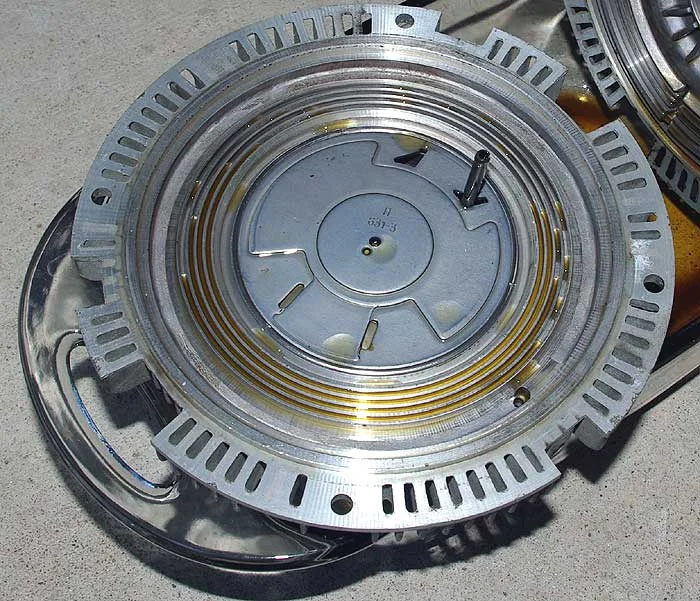

I have heard a few reports of lower performance than expected, on Aisin and Eaton clutches. Without being there, having hands on, it's difficult to tell what the failure was. Some have acquired another clutch, changed fluid in it, with better results, so the method used must be good? It's not something that I have seen or been able to replicate? One possibility is the drain method on the Eaton, if not all of the fluid is drained, how is the performance affected with the mix of old and new fluid?
I have done more Eaton clutches than Aisin, with good results. The only ones that I have seen with valves set outside of the "normal" range were Eaton. Only 2 cases, both were set for first opening ~130-135F ish. I bent the spring to bring them down to 120-125F ish range, in the pic above the valve spring is bent/adjusted. Evidence shows that this isn't a big performance problem. One of them was documented to have preformed well for years in AZ desert, was still working, the fluid was just changed as PM.
Right now my default fluid for the Eaton is ~15K. Some locally have run several clutches on the same rig. Inkpot has run a blue hub w/24K and Eaton w/15.5K. They are close, if anything the Eaton shows a slight performance advantage.
