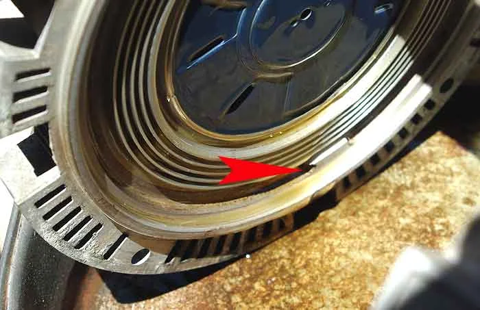

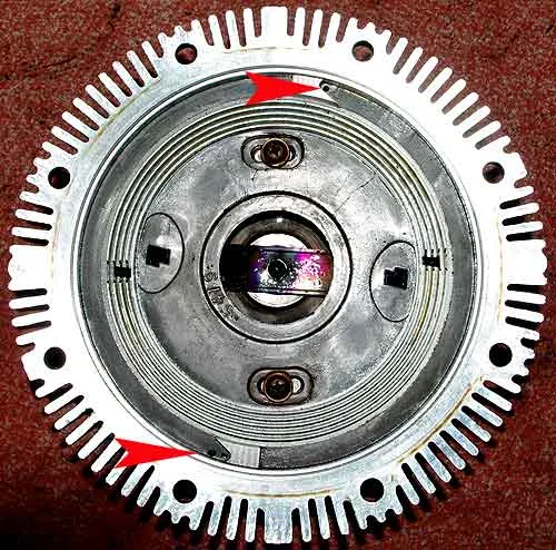

It doesn't matter, but most that I have measured were ~20-40ml. What matters is getting as much as possible out. My fill is ~40-50ml, depending on which clutch and how clean. About 40ml will work for any of them.

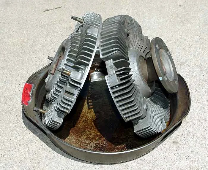

This is how I drain Aisin clutches, note the hole at the bottom on the front (reservoir) side. If not at the lowest point it wont fully drain.
This method isn't best for Eaton clutches, for them see the later post in this thread.
