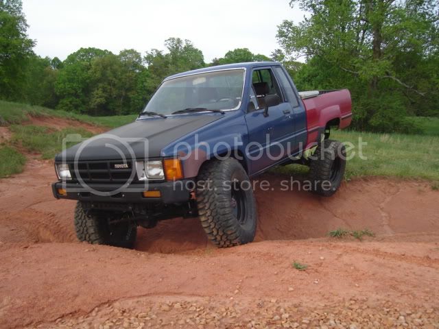

After w/ 33's

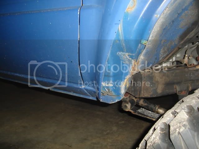

Beat the pinch weld back, trimmed the finder back 1"

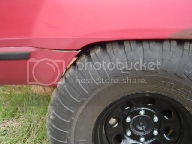

Rear did this....

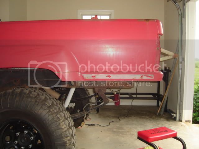

So I did this....
