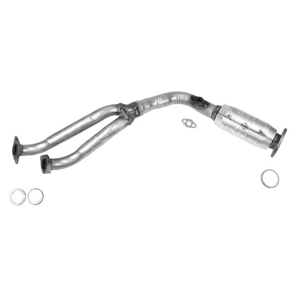

Suggest the easiest way to fix my hacked up exhaust?
I'm sure this is no big deal for any kind of reputable exhaust shop. The key being reputable. It's virtually guaranteed that they deal with worse every day from the meth-fueled cat thieves out there.
Since Otramm stopped making the stainless exhaust components, I'd just go with Magnaflow or similar and let exhaust pros weld in whatever's necessary.

Well. I see where my exhaust leak is. Where the downpipe attaches to the exhaust manifold there is only one stud and bolt. The flange is twisted slightly so it's currently impossible to get a new stud in. I'll have to loosen up enough crap to get a new seal in and a new stud

I tried to fix the leak at the manifold. There's only one stud and nut installed and no gasket. No wonder its leaking. I can't get the flanges apart enough to get a gasket over the extension of the pipe through the flange. There just isn't really enough space between the frame and pipe. I can cut it but iwa t a generic cat welded in anyway so I'll have to take it to a s***ty exhaust shop.
I bought this generic header with cat. Had a local shop connect down stream of the new cat adding in a new muffler and bungs. Spent $1,100.00.

Don't forget to replace the exhaust trunnion while you redo the system.
Although I just caught yours is a RHD, so more than likely that one will not work for you, steering and all...
The steering column is above the wye pipe. No difference there. But they might line up with the manifolds and be workable
