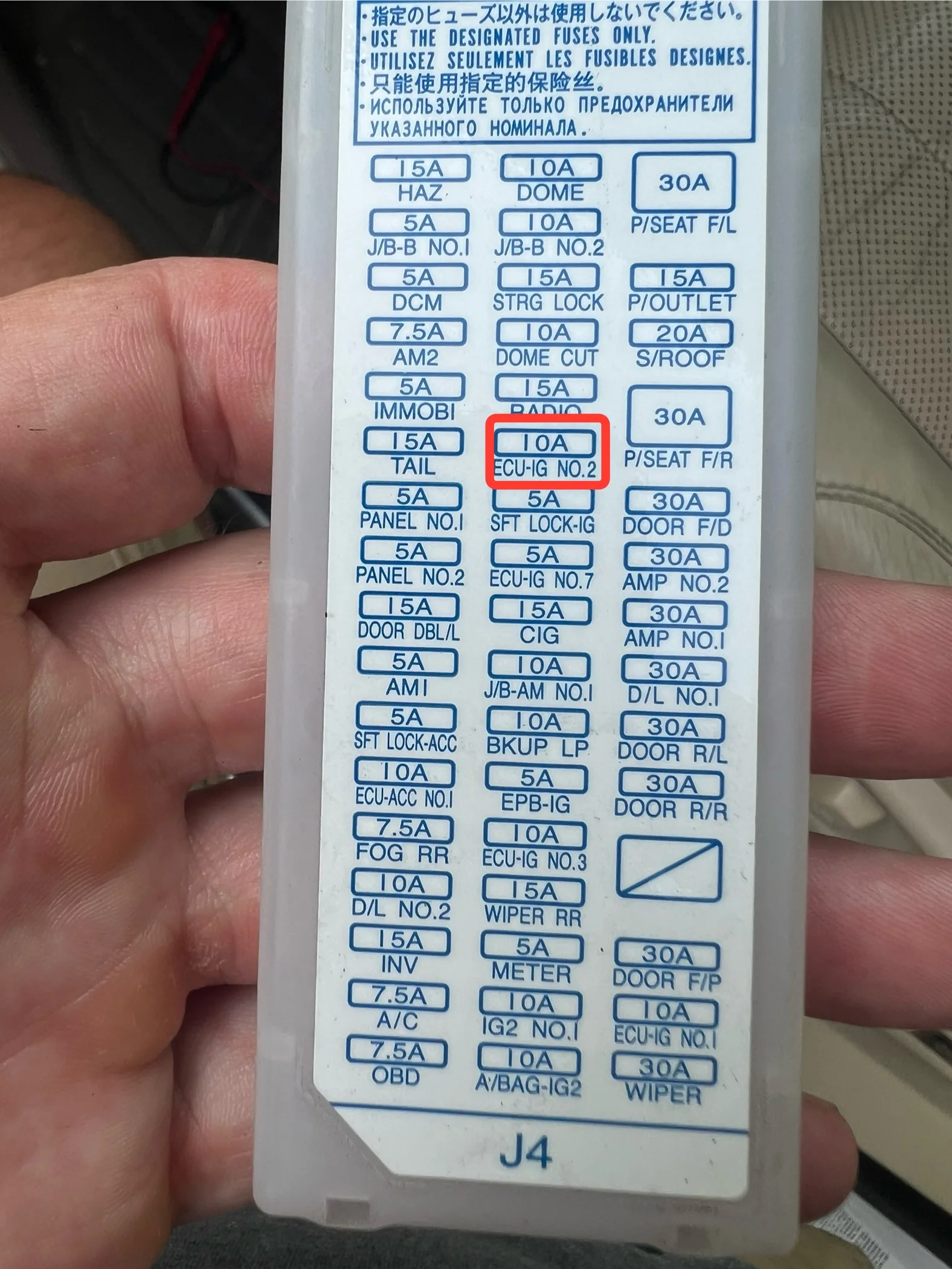

**all conditions were resolved with replacing a single blown 10 Amp fuse on the drivers side fuse box. Time will tell. I had a small spill in the chill box as well as a spill in the rear seat that may have caused a short.

SOLVED: I finally made time with a multimeter and began testing fuses and all issues were resolved after replacing a single 10amp fuse on the drivers side. It seems there are a few fuses for separate ECUs so if that eco fails all it’s supported functions do as well.
I think it’s a waiting game not knowing the root cause. I did correlate that a water spill in the chill box as well as a water spill on the back seat happened the same day. I never looked but assumed the chill box was sealed and it clearly is not, I’m suggesting I caused a short from there. I also had a laptop charger plugged into the inverter for several days which I had never done prior, potentially using all these features in conjunction, which I did, was too much. Otherwise I still need to investigate water intrusion as suggested prior and will see how it goes on the next wash. And either fuses are getting smaller or I officially need glasses.
