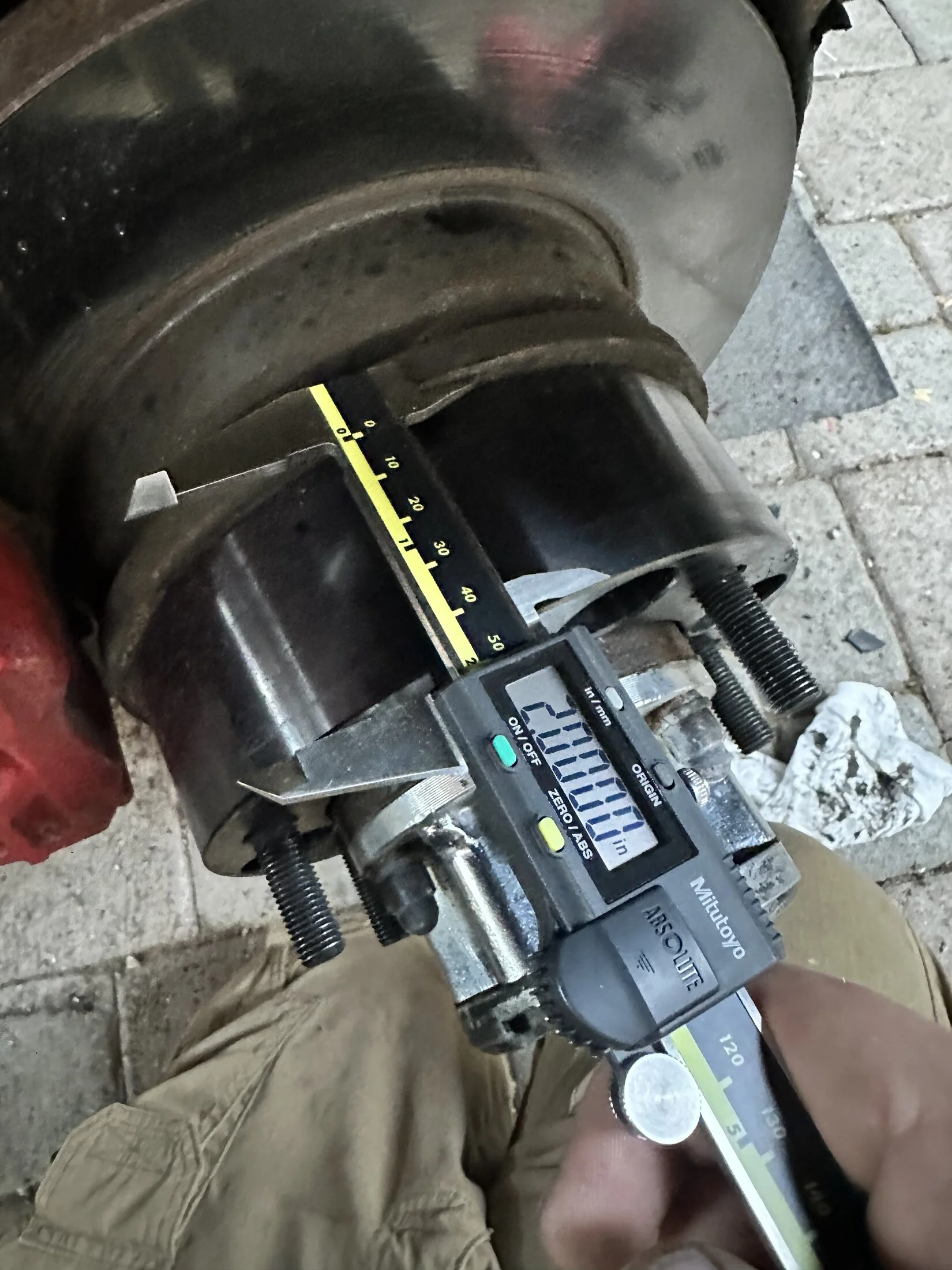

There are 2” spacers the front wheels (only) on my (new to me) fj62 and after I bled the brakes and was putting my wheels back on, I now realize why the lug nuts were so easy to break free. Just a mild amount of torque (60 ft lbs) was enough to have multiple studs spinning on the wheel side of the studs. I didn’t get the paper work for these spacers so I had no idea what the torque was and just gave them the safe snug with a torque wrench, before I set them down off the jack stands and could look up the right torque.
So, I’m pretty sure I stripped multiple spots in the studs, and I’m also pretty sure this mod is from the generation of mods that was done by a less skilled home mechanic (someone used glue to attach a head unit to my dash and stuffed a bundle of paper towels in behind the unit to support it while driving) so I’m guess these were an eBay special.
So… what are my options here? I think the short version is get some recommendations for good/great wheel spaces (some nasty cuts on the inside side wall of my LT285/70R17 MT Baja MTZ p3 say these are required) while I consider just buying wheels with the right offset to mount these wheels. I do like the stance and look.
So, steel spacers? Al ones that won’t strip? Lug studs that are long enough to engage well? Any recommendations welcome, spend my money for me please.

A PO may have used non-Toyota studs in the hubs, and they're listed as working in the on-line parts houses, but they're just a smidge too small and start to turn in the flange when over-torqued which seems like what you're experiencing. New front and rear studs are still available from Toyota. They're different sizes.

The studs that attach to the truck's axle didn't strip, the stud that goes into the aluminum is what gave way. The lug nuts that are holding the wheel on are 1/2-20 (those splined ones with the really thin socket for taking them off) so something funky is going on.

Well, this was a fun experience. It wasn't the spacers, wheel studs, or anything that would be sensible. Nope, someone put on janky spline drive lugs nuts on there, and to add a little icing on that cake, the janky spline drive nuts were 1/2-20 thread, not metric and not the right thread for the wheel studs.
Replaced all the nuts on the vehicle with the spidertrax lug nuts and solved my problem for 40$ This also makes me strongly want to remove every single bolt and nut on the vehicle and replace anything that doesn't look OEM with the Toyota bolt, and torque it appropriately. Reached out to the seller and he didn't do it, he had a shop put the spacers on and they put the lug nuts on there. Crazy.
