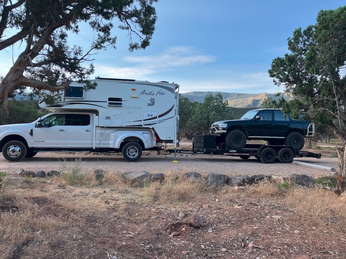

I've been strapping my 40 down to the trailer by going over the third member with good results.
I'm going to be in a position where I will not be able to strap the 40 down to the trailer and get an angle on the straps that I like. I won't be able to go forward as much as I want, so the straps won't be as inline with the load as I think they need to safely be.
My questions is, what are people's experiences with the nets that go over the tires?
I'll be going ~2000 miles round trip. Minnesota to Colorado
The only thing I'm kinda concerned about is the track width versus the width of the trailer, and the radial load being put on the wheels being strapped down hard for that long/far. The 40 has a 56" track? and the straps will be on the outboard part of the trailer which I think is right at 8'6", maybe 8'4". So the straps would be pulling out and down 22" or 23" away from the tire.
or maybe this isn't a concern at all, and just strap it down with the nets?
