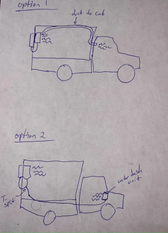

Now here's what I am thinking:
The HJ will get a lightweight camper with popup on the bed.
I will, down the line, install a mini-split/undermount A/C system in the vehicle. Original thought is mounting the blower in the camper box, with two of the ducts into the truck cab.
However, while removing the A/C today, I looked at the condenser and also the under dash unit, which has the evaporator, and thought:
What if a minisplit can be used not only with the condenser and evaporator it brings, but also a t-split to go to the underdash unit/evaporator?
Actually, seems like it would only need a t-split to plumb into the underdash unit/evaporator, since the minisplit would already have a condenser.
I know nothing about A/C, so maybe this is totally unworkable, or not worth it. If anyone here knows about A/C and thinks this could work, it would be great to get you opinion.
Something like this:
Would also be interesting to somehow, with the existing condenser and underdash system, if I could put together a small minisplit just for the cab, and have a desperate one for the camper box.

Yeah I was thinking that a mini-split could maybe work the same way with a T-fitting. But wouldn't want to risk frying one. I'll have to ask a supplier of those to see what they say.
