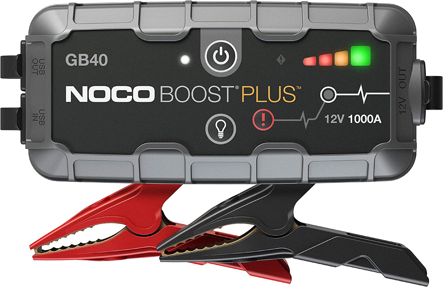

I have 2 of these awesome jump packs stashed away in the cars for emergencies. Every few months, I check to make sure they have enough juice for when I need them. They also make for a great tool when hitting the junk yards ;)
Liking this idea a lot. I have a much larger one. Would airlines really let me fly with one of these in my carry-on? I am a TSA Pre-Check member so they typically don't even make you take crap out of your backpack. To the Googler!!!
