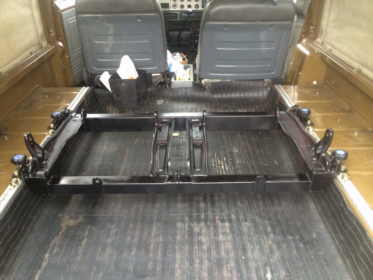

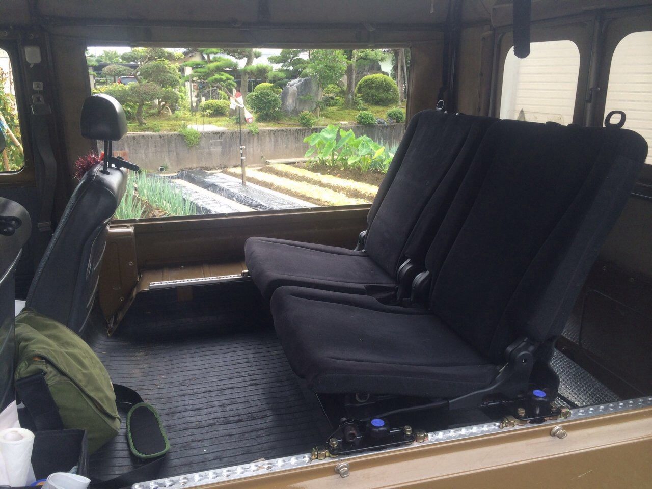

I ran airline track along the top corners of the fenders. With this I could bolt in any type of shelf or drawer system as well as in my case the rear seats or use them to strap down cargo. Again to me flexibility is the key. I could also use it (and am planning to ) to secure a sleeping platform for some trips. And also to bolt in shelves and a cargo barrier befhind the front seats.

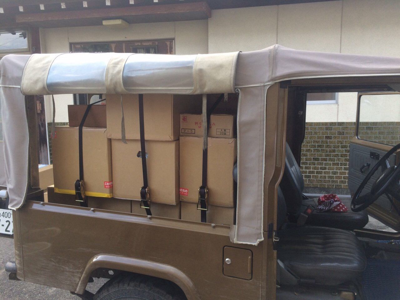

Here is a photo of it all packed up for a week in the Abajo Mountains, Dark Canyon Wilderness, Beef Basin and Needles District of Canyonlands (sorry, no photo of it inside) for two people:

View attachment 1008869 View attachment 1008871 View attachment 1008872 View attachment 1008873 Drawers seem pretty popular- but I think I prefer stackable plastic boxes combined with bags. I like to be able to empty the whole thing out and I also prefer the flexibility of not having anything permanently built in. But this is because my truck is a jack of all trades.

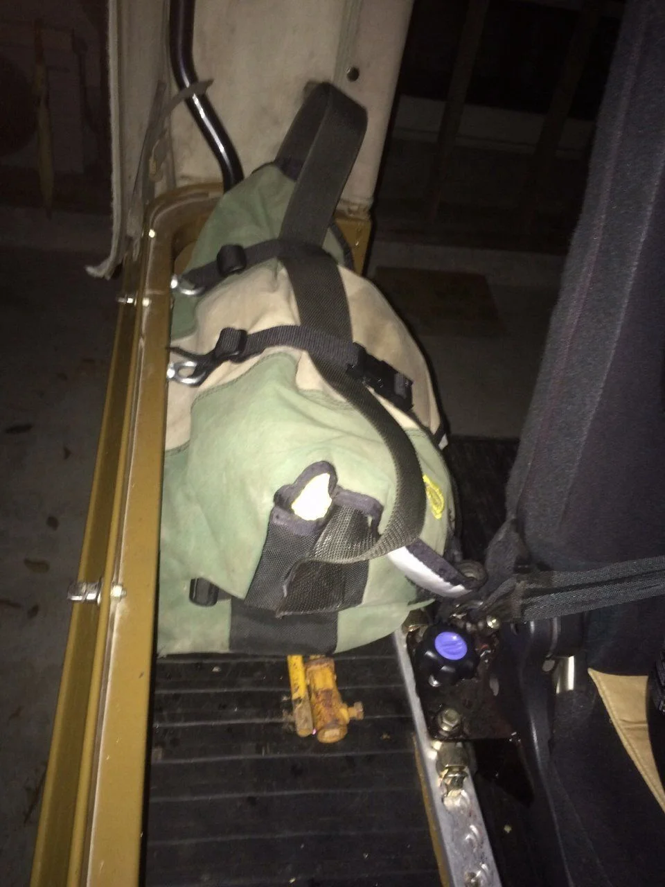

I also am actively looking for use messenger bags as they are cheap used, easy to carry, keep stuff dry in the rain but very easy to access and easily identifiable. I can keep them set up as various kits. One with spares for longer trips, ones that will be in the truck all the time etc. In my mind (like most other things inmy mind yet far from reality mind you) I will look at my shelf of bags and say- this one, that one, stuff some clothes in this one, throw in camp kitchen ver.2, strap them down and be off. They are great too because they keep stuff from rattling around unlike having it sitting a box or drawer. Also as I often have passengers in the rear the messenger bags can easily be secured in a row on each fender.
