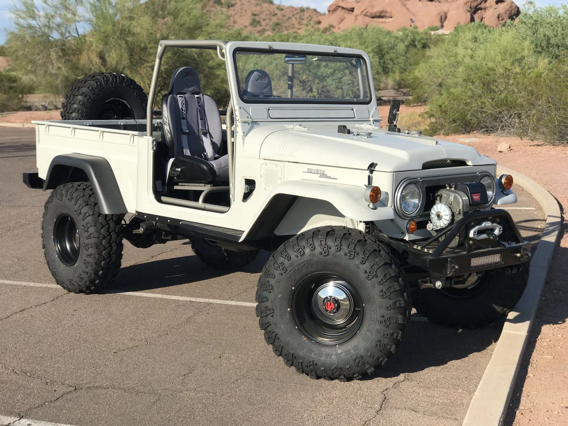

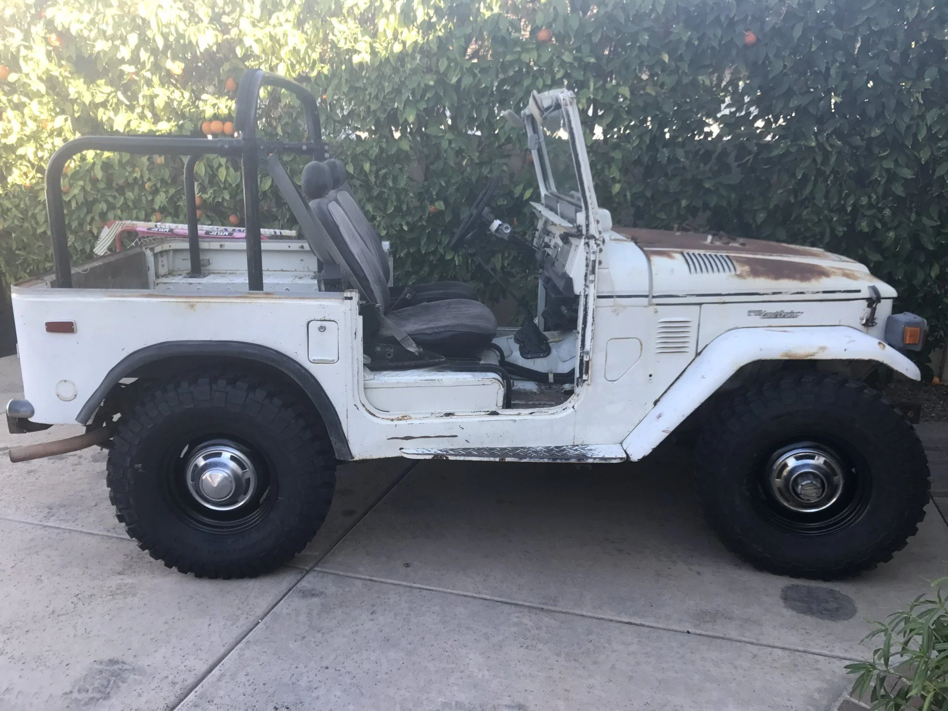

I sent Stockton stock rims from my 40, the cut the centers out and put them into a 16.5 hoop, they were great to work with , now I have 37" tires on stock looking rims.
I have seen this rig in person at Valley Hybrid...very impressive
This truck looks awesome, by the way. : )

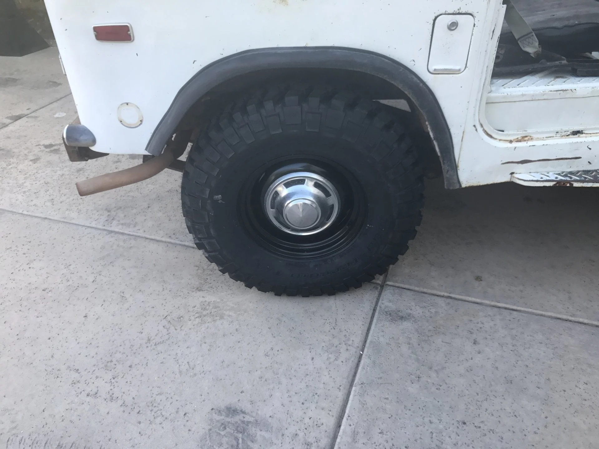

Thanks, I think the largest rim Stockton will do utilizing a OEM center is the 16.5, yes tires are getting very limited. Also purchased Racer65 16" rims for another project and they work out great to run a 33"x10.5 BFG, I will post a picture in a little while when I get them on.

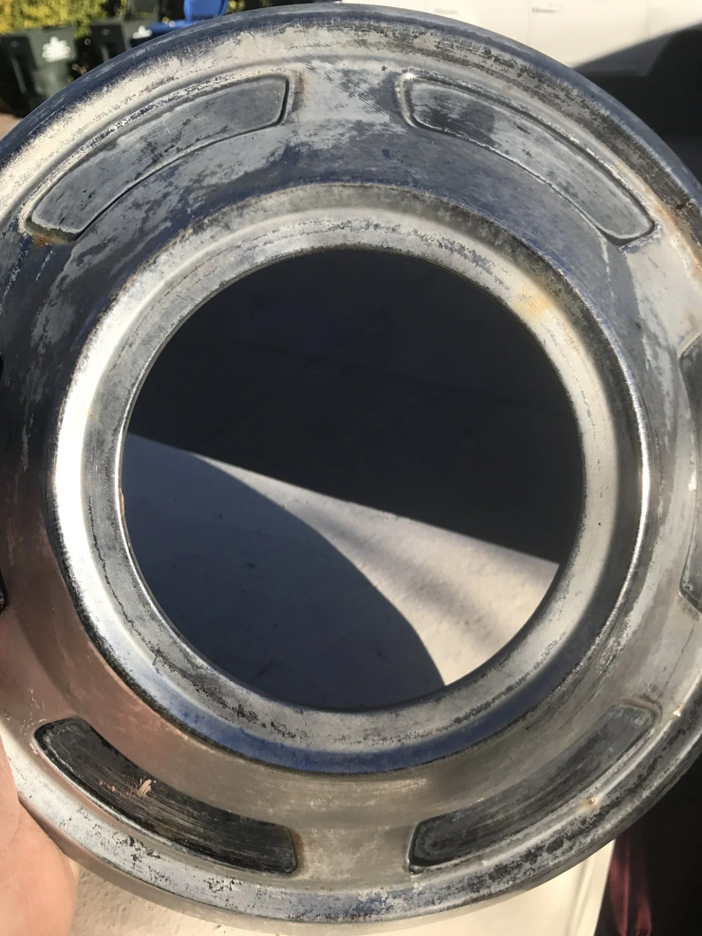

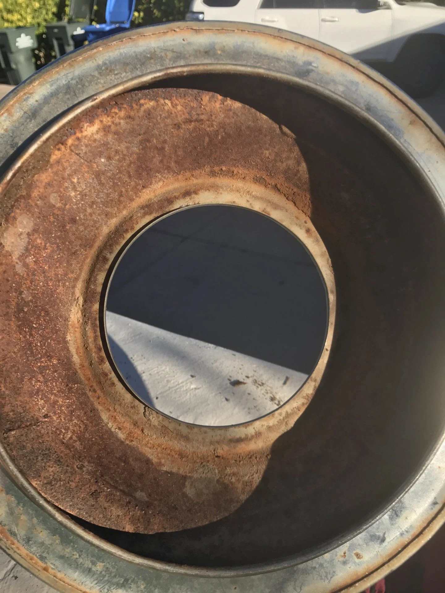

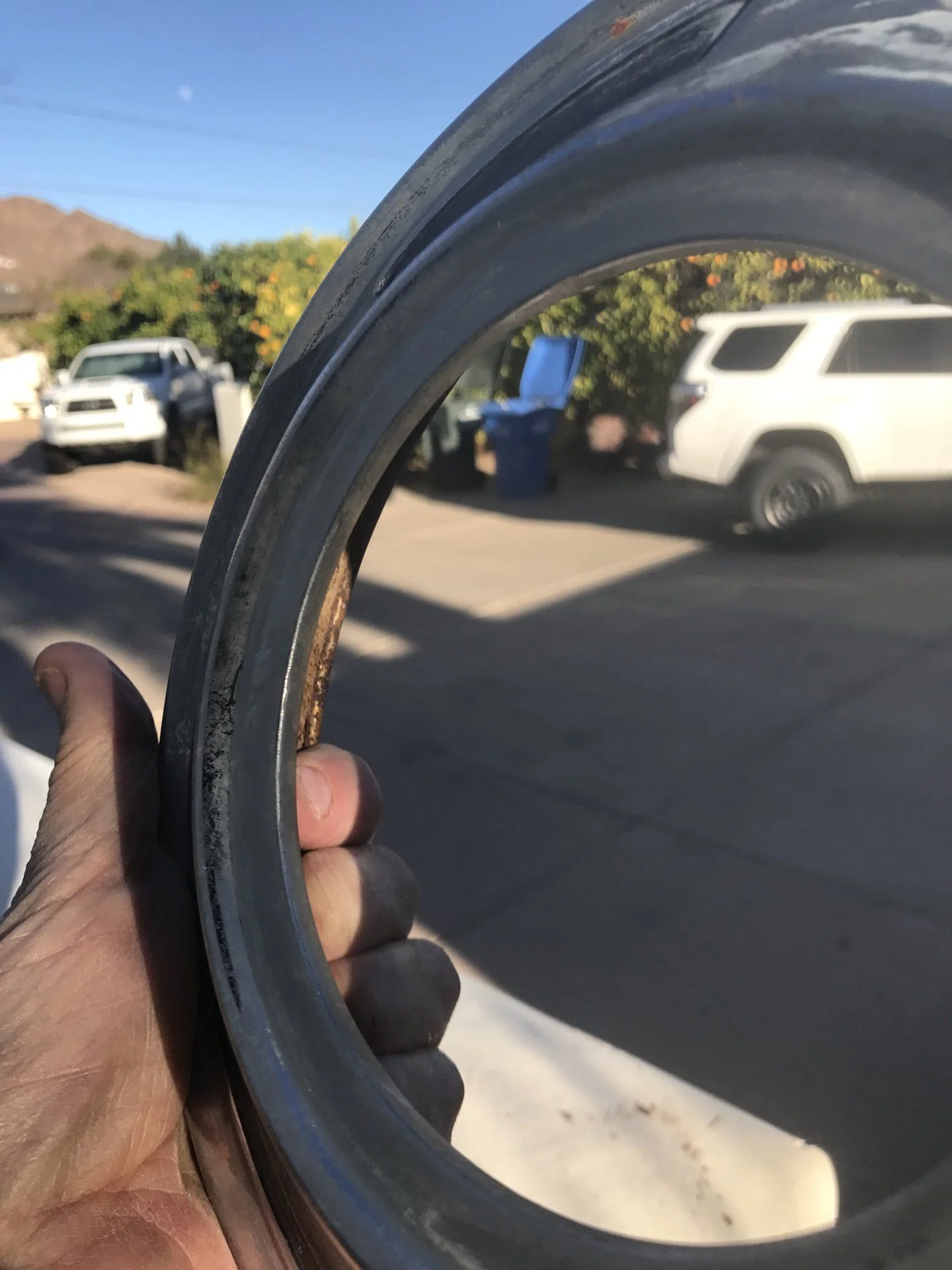

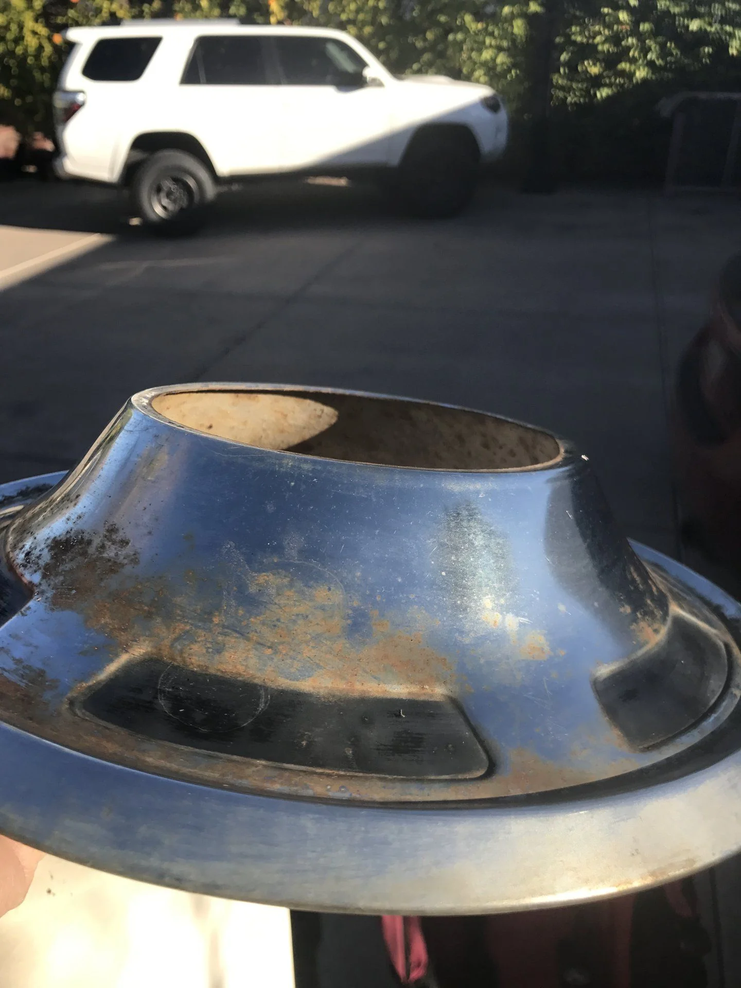

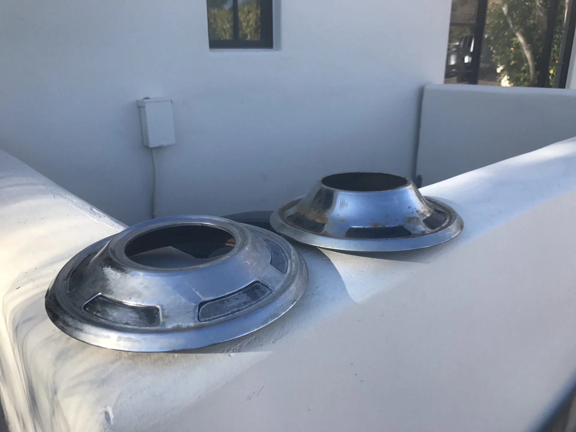

I have a box of old hubcaps and went out to grab some to put on the new rims and noticed this difference, does anyone know what the difference?One has a higher rise and one lower.@livinginthepast

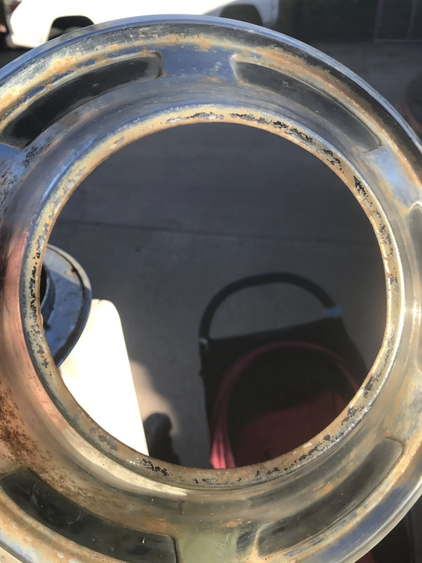

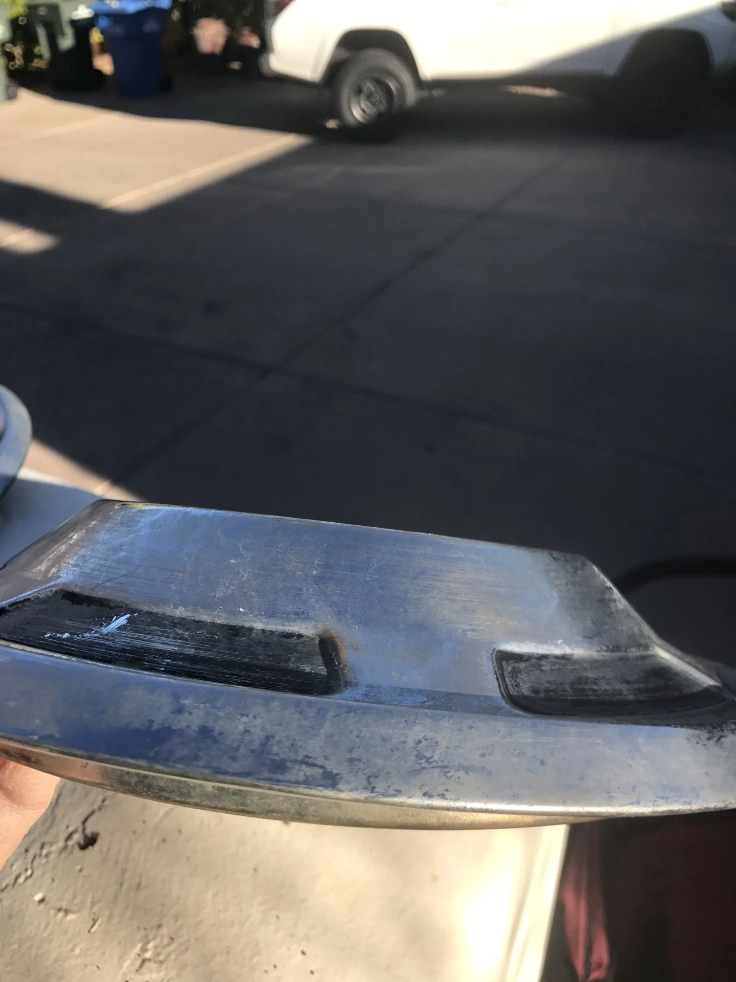

Of the top of my head I would say that the taller cap is a closed cap that has been field-cut to clear a locking hub.
The tall one appears (to me) to have been cut.
