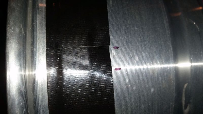

How low of pressures do you want to run? Honestly, a few wraps of Gorilla tape over the safety beads goes a LONG ways in the bead retention department. 2" wide tape typically works well for the inner bead. 1" wide tape works better for the outer bead typically because of the shape of the wheel shell. Clean everything well. Take your time laying down 2-3 wraps of tape over the safety bead and about 50% across the bead flat. Only use a light spray of soap and water when seating the bead. This is typically good down into the mid single digits.
I even use the trick on inner bead on beadlocks for extra insurance.

Another trick is sikafkex/polyurethane on the bead before seating the tire.

Gorilla tape is like triple the thickness of duct tape so it builds up the rear safety bead on the wheel so the tire has a harder time slipping over it.
Ultimately it makes the wheel bigger than the tire, creating more tension
